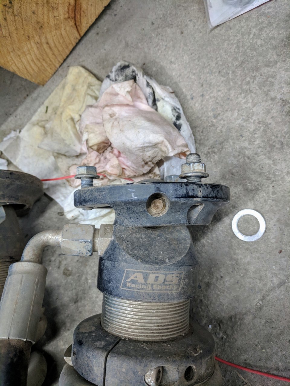

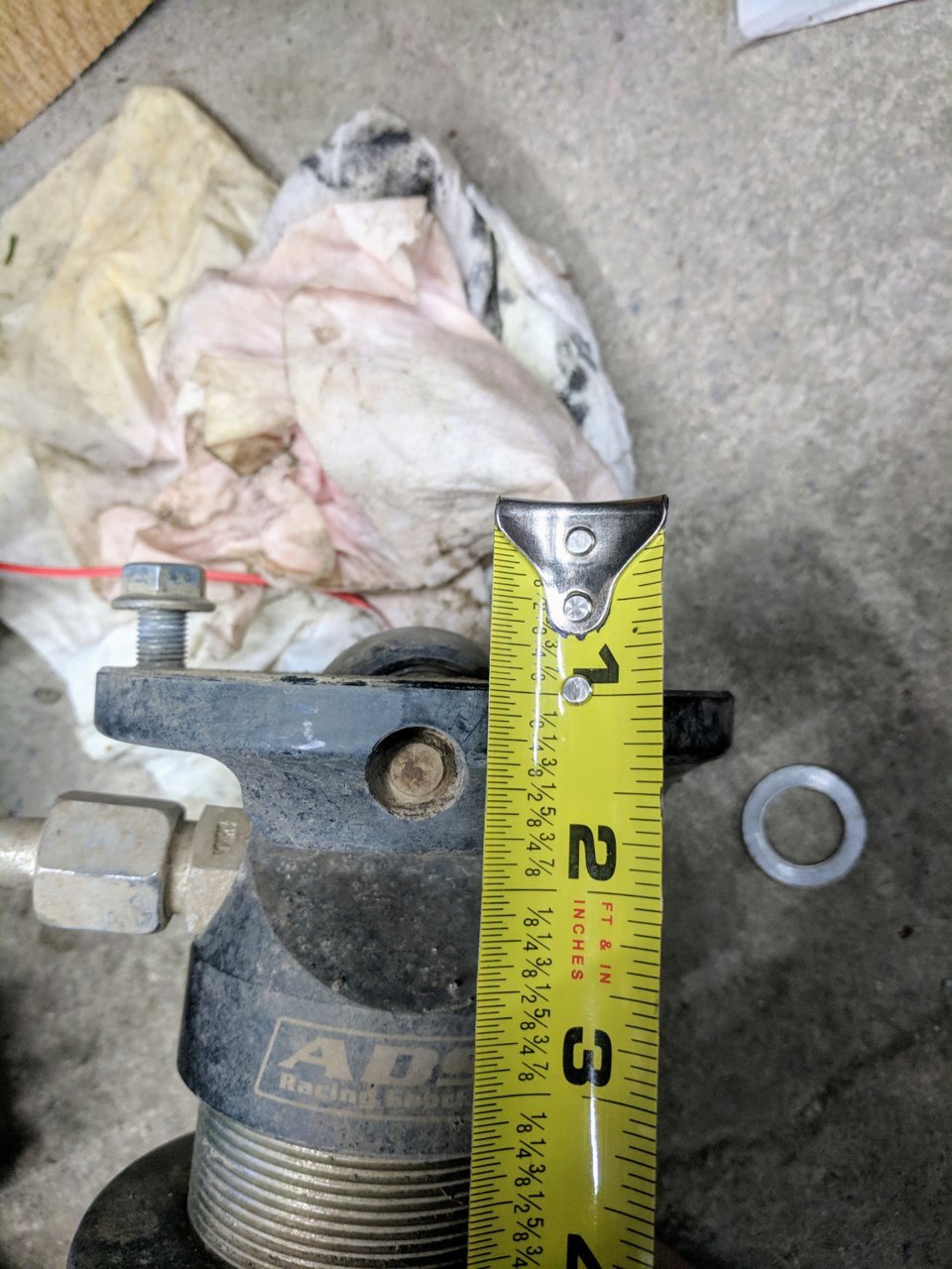

    Sooo talked to Matt. He said because he exclusively deals with ADS, he's not too sure on the exact King specs. That being said, he said from the top hat to the eyelet is like 1/2 an inch.
    Doesn't @Blackdawg have an MCM LT setup with ADS up front? Or anyone else with a Tacoma first gen possible able to supply a pic of what their ADS top hat looks like?
    Greatly appreciated if you could!!

    I do and just removed my shocks. Give me a sec I'll get a photos.
    What are you trying to do? Run Kings with Matt's kit? Why?
    Also just from a glance of the first post, don't do manual hubs. Unless you want to change broken CVs all the time.

    I'd say 1/2 is pretty close.

    Thank you, Monte! That is a huge help.
