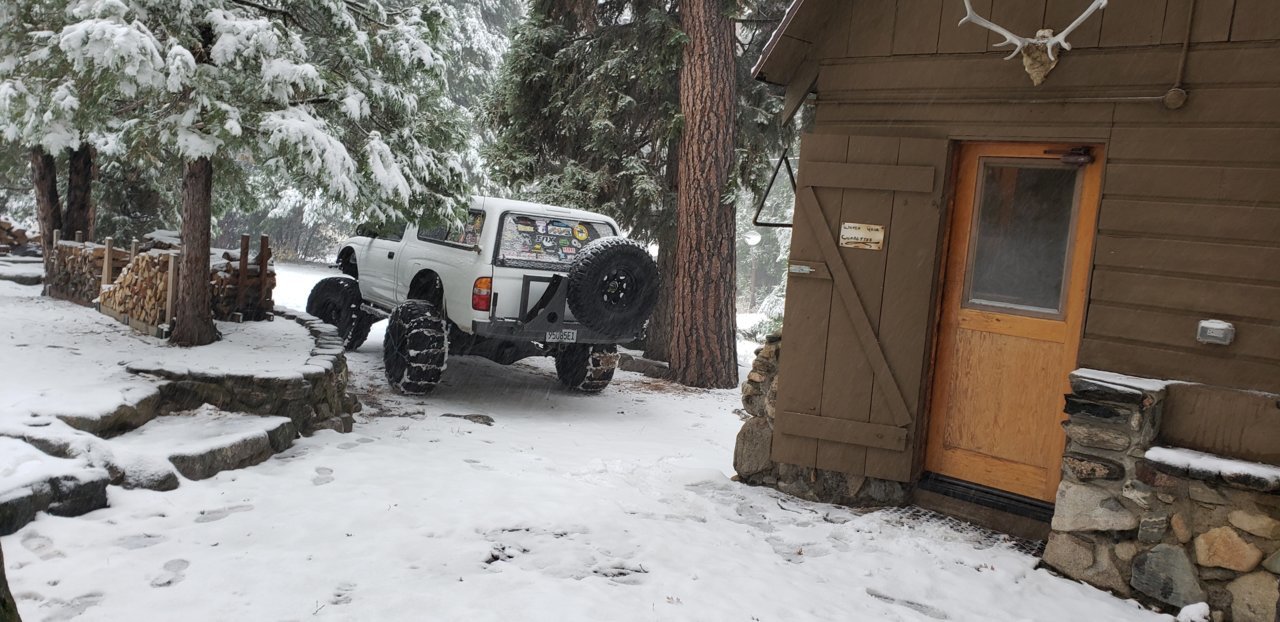

    Slip and sliding today!

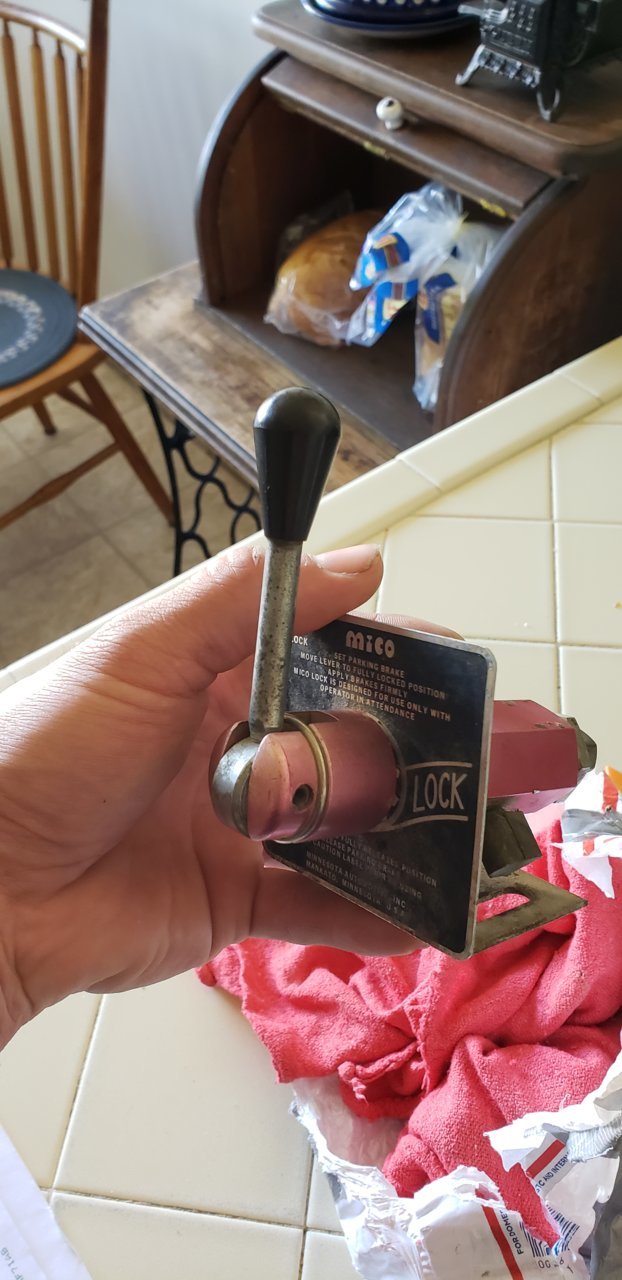

    More details on this? Is it a line lock?

    It’s a Mico Lever Lock used for forklifts and industrial equipment. They work but usually have a tendency to leak by. I used them for 20 years on equipment I ran.

    Exactly what Ritchie said. Reason this over line lock is that my understanding is line lock is a momentary setup --good for a minute or so and any additional petal pressure once it is locked could cause damage or release. I could be all wrong on this. However, Lever lock is used on tow trucks and stuff as they're winching and I'm 100% confident it'll work for my use. Longer keep and more reliable as it is designed for. Not intended as a long term parking brake, but will work great for momentary stops on steep technical inclines.
    Wasn't in interested in mechanical as my lines kept sticking from all the abuse and I couldn't find any transfer case brakes...

    Link to where you got it? My line lock leaks a ton

    I would google "Mico Lever Lock" and see what comes up. I had got mine used on eBay. Fingers crossed that it works, as it was still kind of pricy.
    I hear some people have used these as actual parking brakes. I wouldn't rely on it as an actual parking brake, but I say that as perspective to the level these are at.
    I believe with these you flip the lever, then press the brake and it'll hold that. With mine there is also a pressure switch that you could hook a buzzer or light for warning if you're loosing pressure.

    Yeah same as a line lock. I only will use it when parked at an akward angle for a short period of time

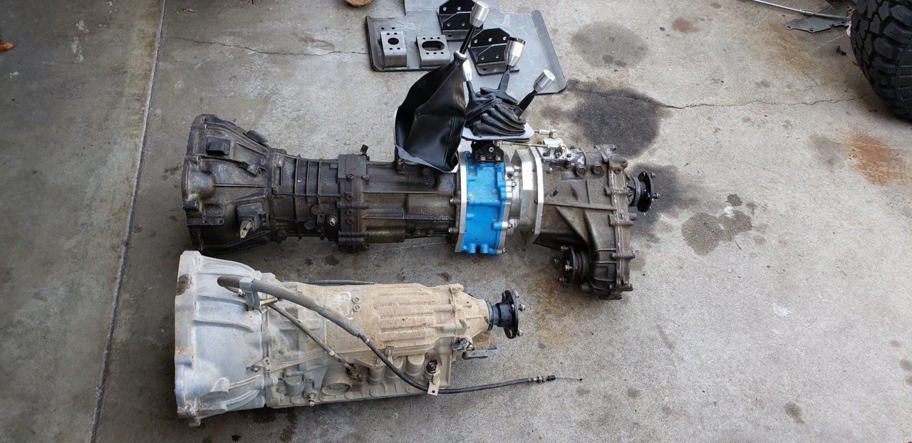

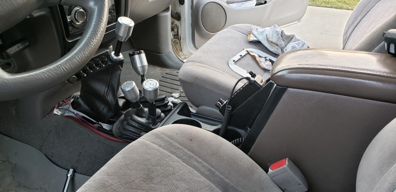

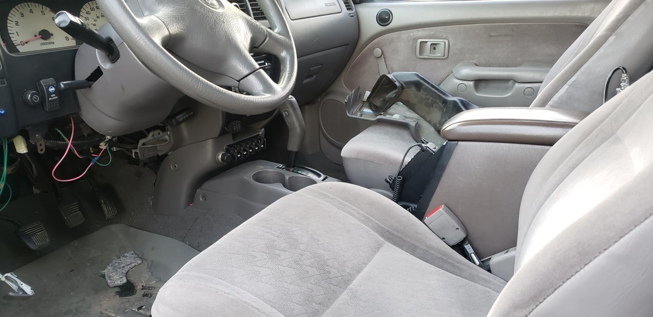

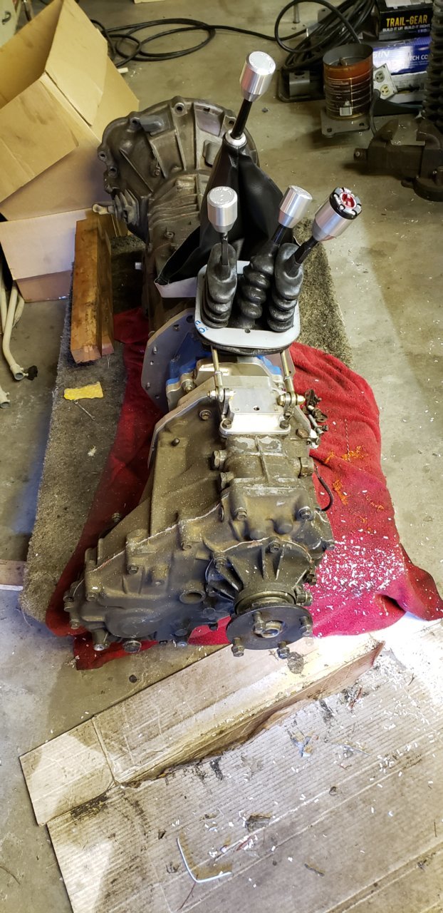

    Okay guys! I'm off Wednesday. I'm pulling out the auto transmission that day and sticking in the manual transmission over the weekend!!!
  11. Nov 9, 2020 at 4:20 PM
    #371
    Dalandser
    Dalandser ¡Me Gustan Las Tacos-mas!
    Feb 19, 2015
    #149090
    17,627
    Anthony
    Downey
    08 PreRunner Regular Cab / 98 4x4 Extra Cab
    Empty Wallet Mod
    Where'd you get those shifter knobs - think they'll heat up from the sun?

    I believe I got those from Dave's Offroad and the hub looking one from I think Low Range Offroad.
    I am sure they'll get hot, but I dig the awesomeness factor haha. I have a billet Hurst shift knob/lever in my other car and it gets pretty toasty, but cools down pretty quick.

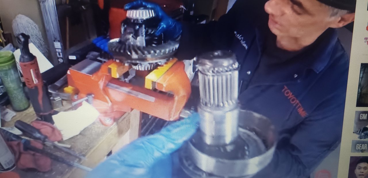

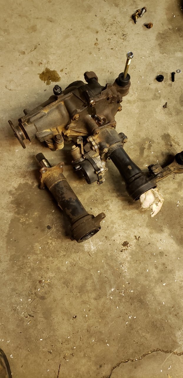

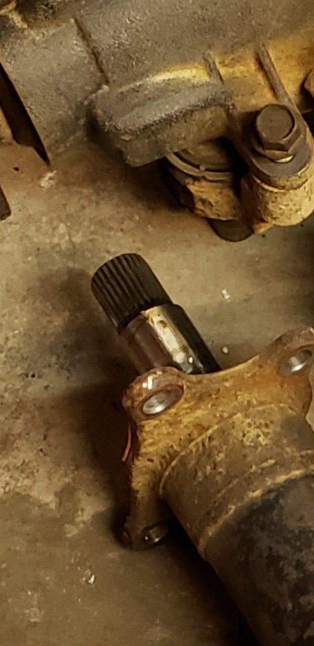

    Haven't taken the diff apart yet, but I'm assuming I can just bolt the longer tube thing to bypass/remove the ADD?

    Heck yeah! I may be in luck!
    I'll have to try and see what happens this weekend
    Called Drivelines Incorporated and going to get my rear driveshaft to them sometime next week.

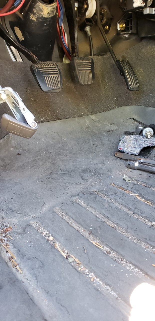

    Going to actually bolt down the flywheel, get clutch centered, and pressure plate bolted tomorrow. No fear on the wrong and missing botls there haha. I have the actual specific ones on hand

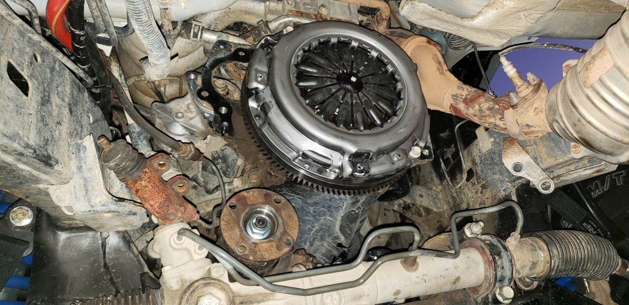

    Everything works and shifts smoothly free spinning!!
    Levers and just chilling there. Will fine tune tomorrow. Enough work for today!

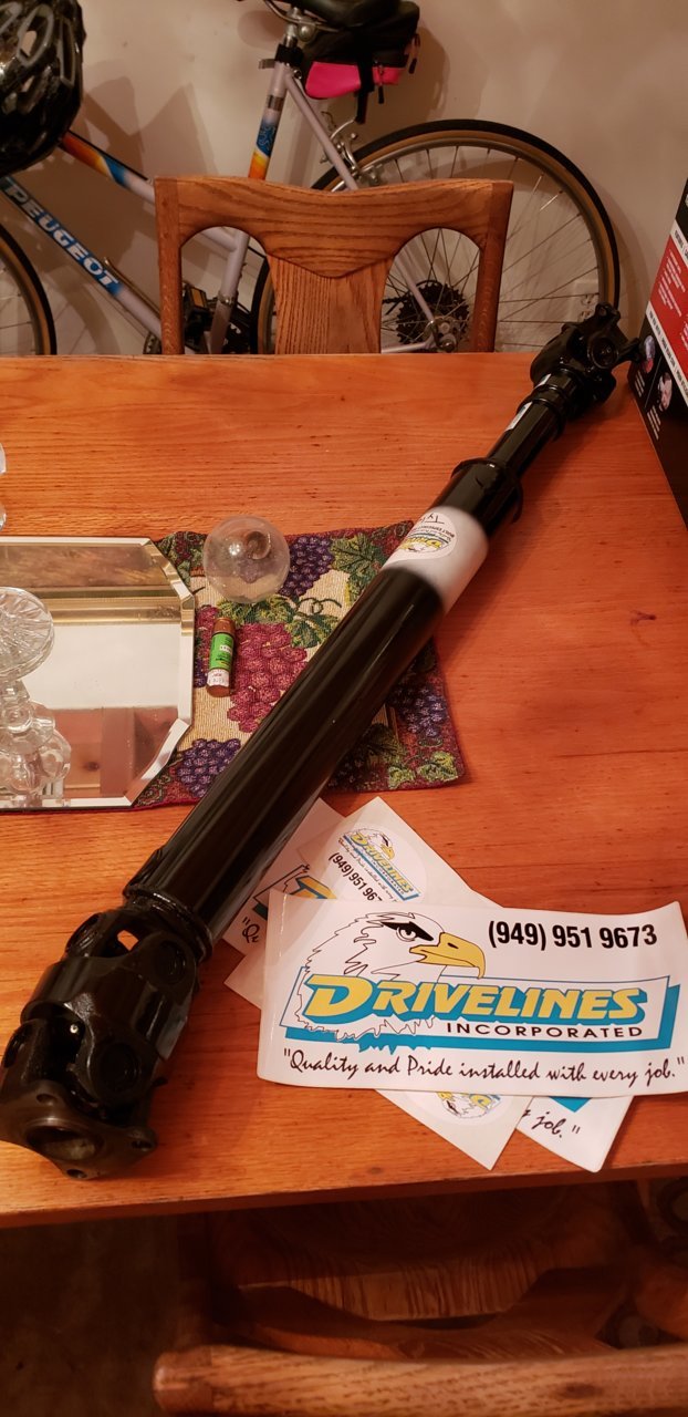

    It's beautiful!! The guys at Drivelines Incorporated are super cool and made this bad boy to perfection.

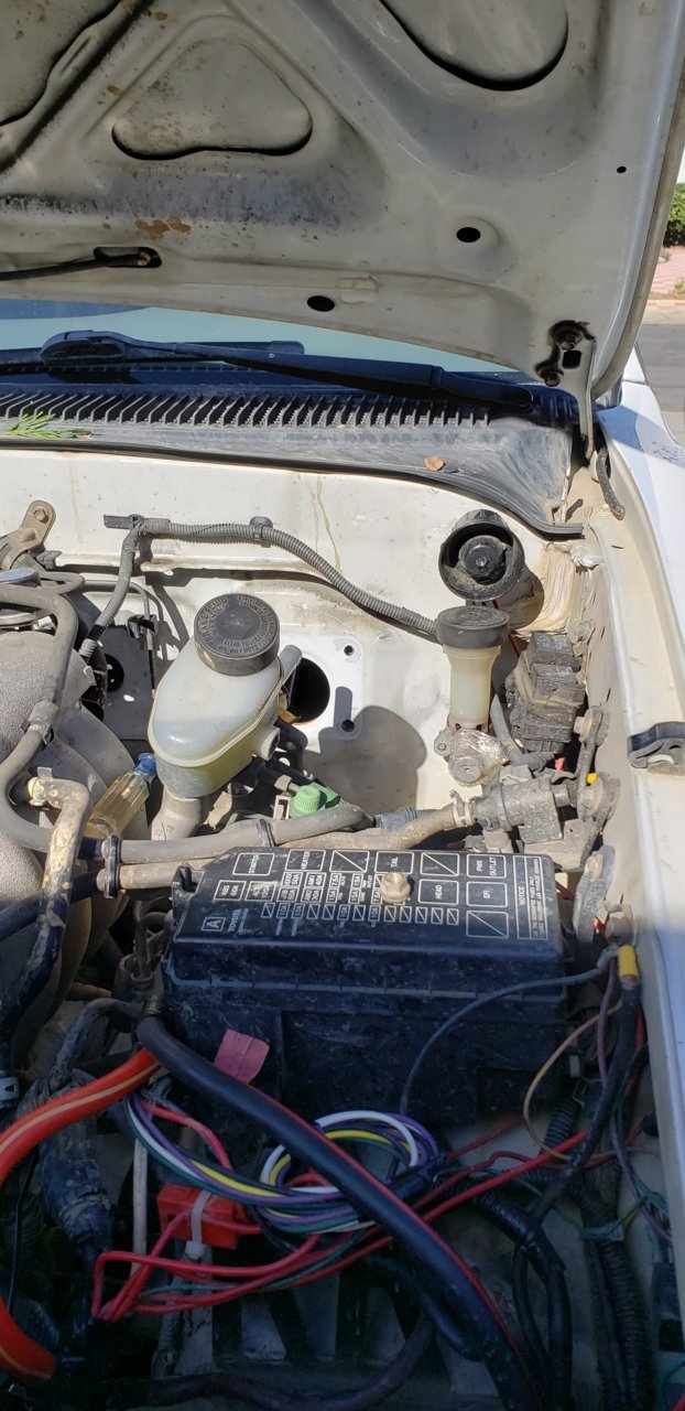

    Also have a Magnaflow 18" muffler on the way. Currently rewiring all my auxiliary lighting nicely off a fuse block.
