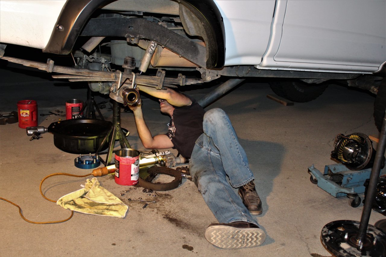

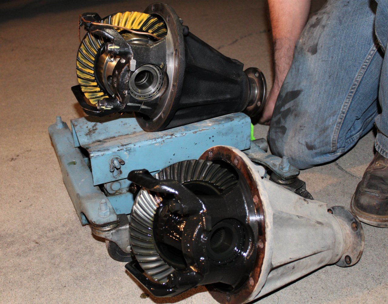

    Badda Bing Badda Boom! Cool to spend time with my dad. He seemed pretty interested in an air locking differential haha.
  17. Nov 7, 2019 at 9:34 AM
    #37
    LukeCC
    LukeCC Well-Known Member
    Mar 13, 2017
    #213229
    2,445
    Luke
    Southern California (East County)
    2002 LT DCSB
    Well, how was it? PITA?
  18. Nov 8, 2019 at 12:03 AM
    #38
    Tyler Lacasse
    Tyler Lacasse [OP] Well-Known Member
    Apr 3, 2013
    #101237
    795
    Tyler
    San Gabriel
    2002 Regular Cab
    Wasn't bad at all! Just time consuming as it's a lot of bolts and stuff to remove. Little things too like bleeding the brakes at the end. I was dying to drive the truck but was like damn gotta bleed 'em still...

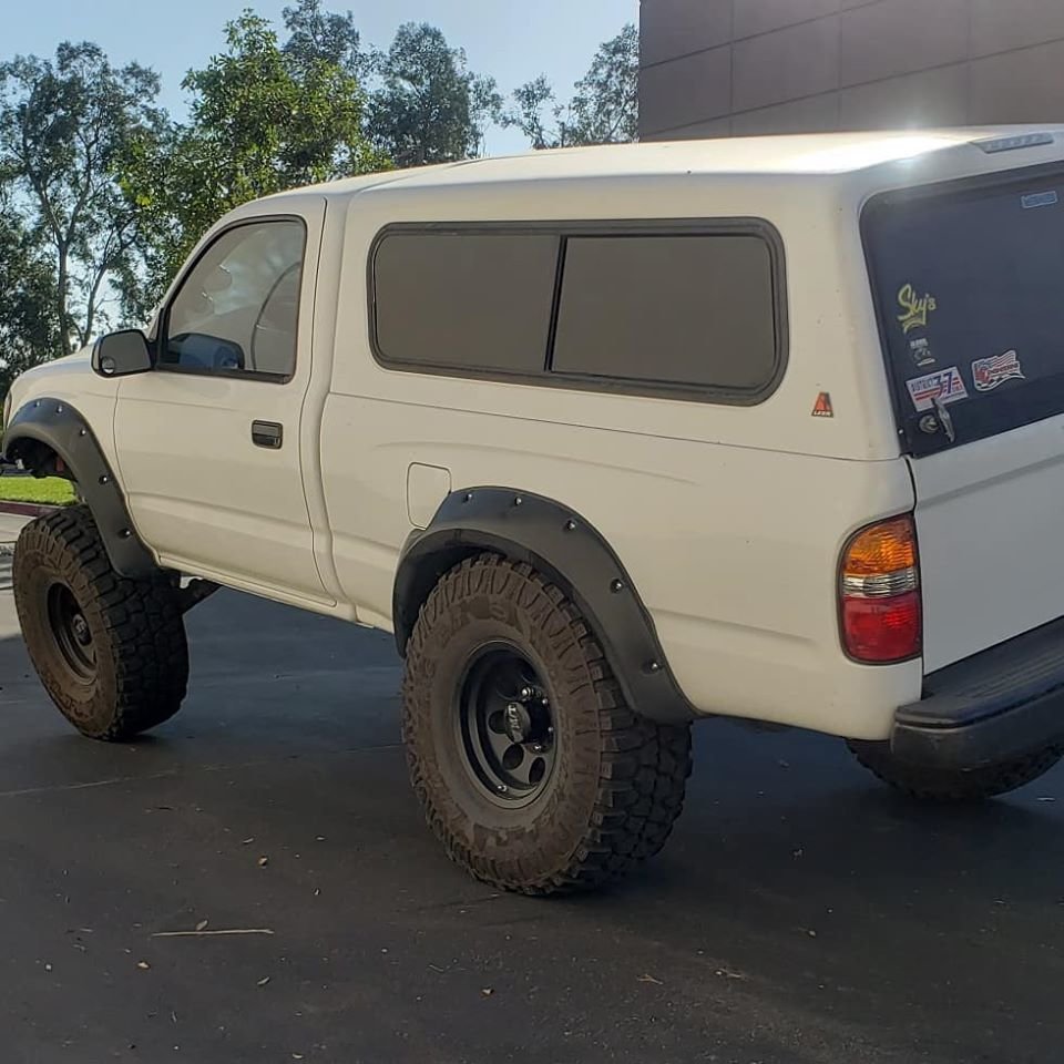

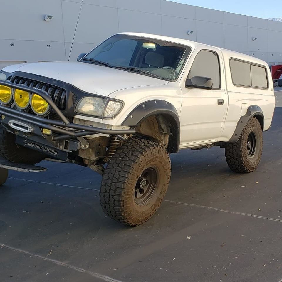

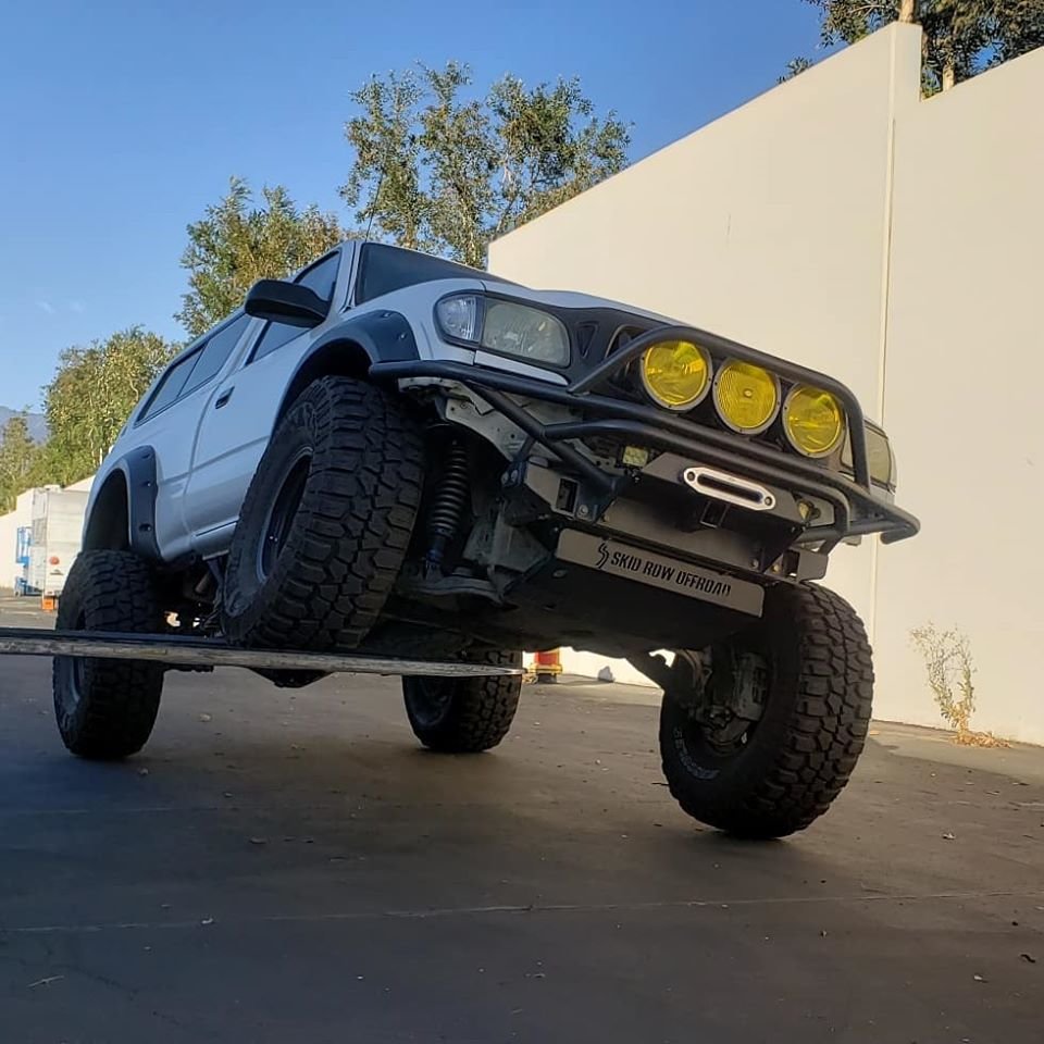

    Tested the flex at work the other day. Really impressed with how the 35" tires tuck PERFECTLY into the Bushwacker Flares. The rear axle has a shim from Sky Manufacturing Offroad moving the rear axle back 3/4 of an inch. That centered it perfectly in the wheel-well and there is no cutting needed. The front is a different story and still needs to be tubbed at the firewall. The 1 inch body lift allows more up travel before prematurely bump-stopping the tires from hitting the body. The Dakar leaf pack has more in it, but it is my slight mid travel replacement Fox shocks in the rear that are holding me back. Would like to do 10" shocks someday.
    Rear locker is in and has made a MASSIVE difference driving around daily to work. Absolutely massive difference!
    Rear bumper gets here this week from 4Xinnovations and sliders from Bash Fab.
    4x4 parts collection is going strong as well. Super stoked guys!Flex Side.jpg Flex Rear.jpg Flex Front.jpg Flex Driver.jpg
