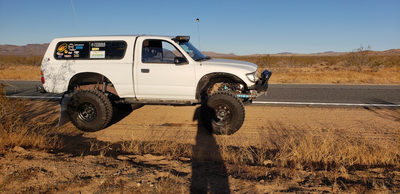

    WOW!!!! Guys- I went for the first test drive from San Gabriel to my buddy's place in Chino Hills. 'Bout a 35 minute drive with the decently steep hill around Covina on the 10 freeway. I was able to drive up the hill in 5th gear and not deal with the old auto jumping down and screaming. Not going to lie, it cruised really nice.
    Everything worked great. Most important observation- I have more gear reduction with manual trans than auto. Cruising, the truck is running at 3K rpms on the highway. I am on 35s right now, but the 37" tires should bring it down a tad bit enough that I'll feel better about it. With the transmission + cases and the big skid plate bracket and added front differential, the truck definitely feels heavier. No doubt it feels less doggy with the manual trans though. I feel this was a really good change for this 4 cylinder truck.
    Real offroad test will be thanksgiving weekend in Barstow desert area near Slash X. I am beyond relieved this all worked out.
    Also, I probably should have got the 2" instead of 2.25" I think, but the Magnaflow 18" muffler I got (Part 11255 for you all) actually sounds really good. I expected it to be louder, but honestly I wouldn't do it any different after hearing it. It is barely loud enough you can kind of hear it burbling at idle, and then a mild purr when accelerating and driving. Great balance for a daily I think.

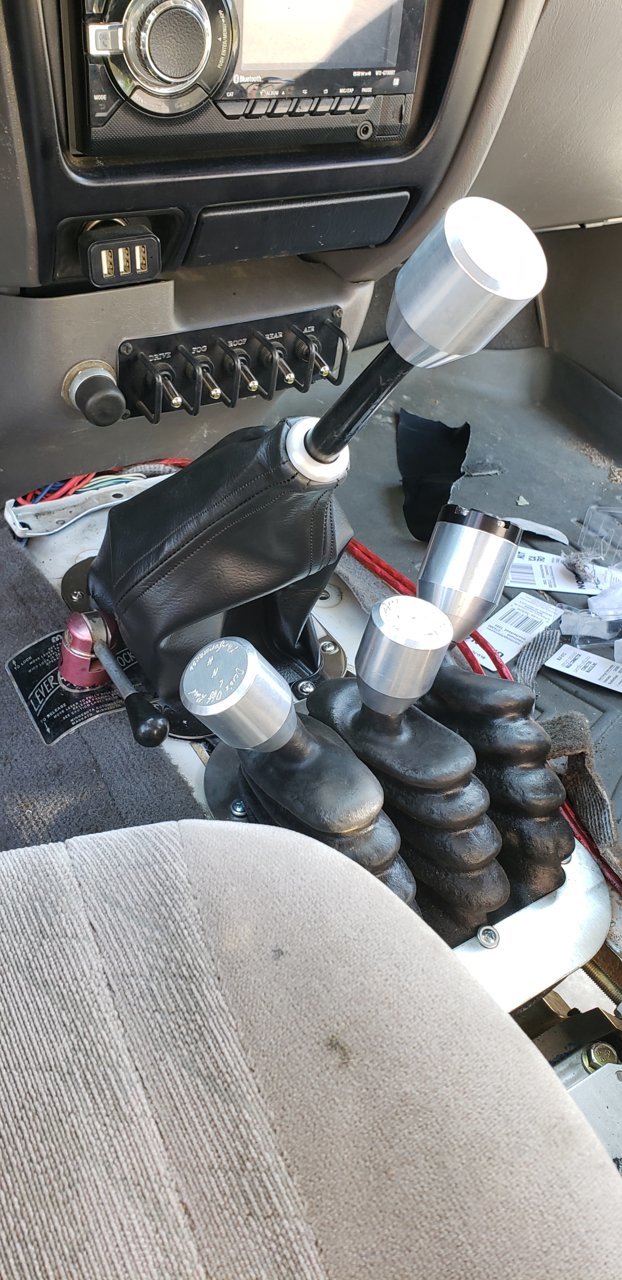

    2002 Regular Cab
    I was cruising fifth gear and then it was as if I went into neutral, but in all gears. There was oil dumping from under the crawl box too out a seam. So I'm not too sure if my clutch was slipping the whole time and completely went or if I lost too much oil and sheared a shaft off. I'm super bummed. I'm hoping it's the clutch but I'll take everything back apart just to be safe.

    Guys! Found something weird out now that I'm back home.
    Third gear works. Everything else is like being in neutral: 1,2, 4, R.
    Does anyone have any experience with that happening to them and what it might be??

    How much oil was left in the trans?
