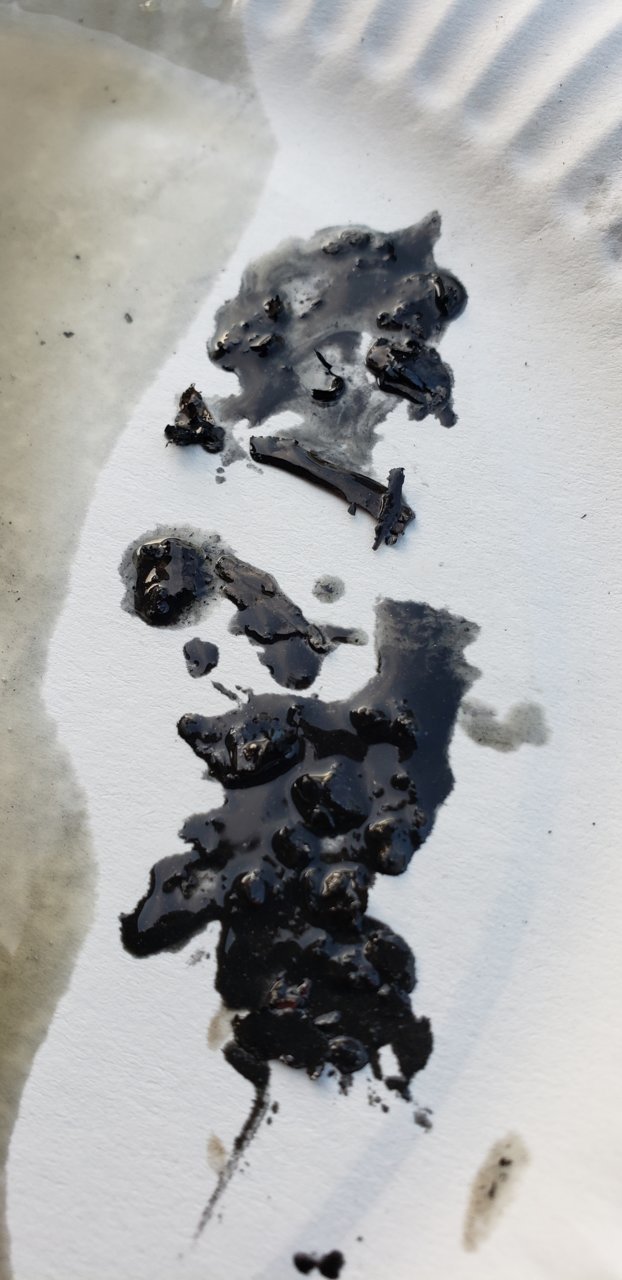

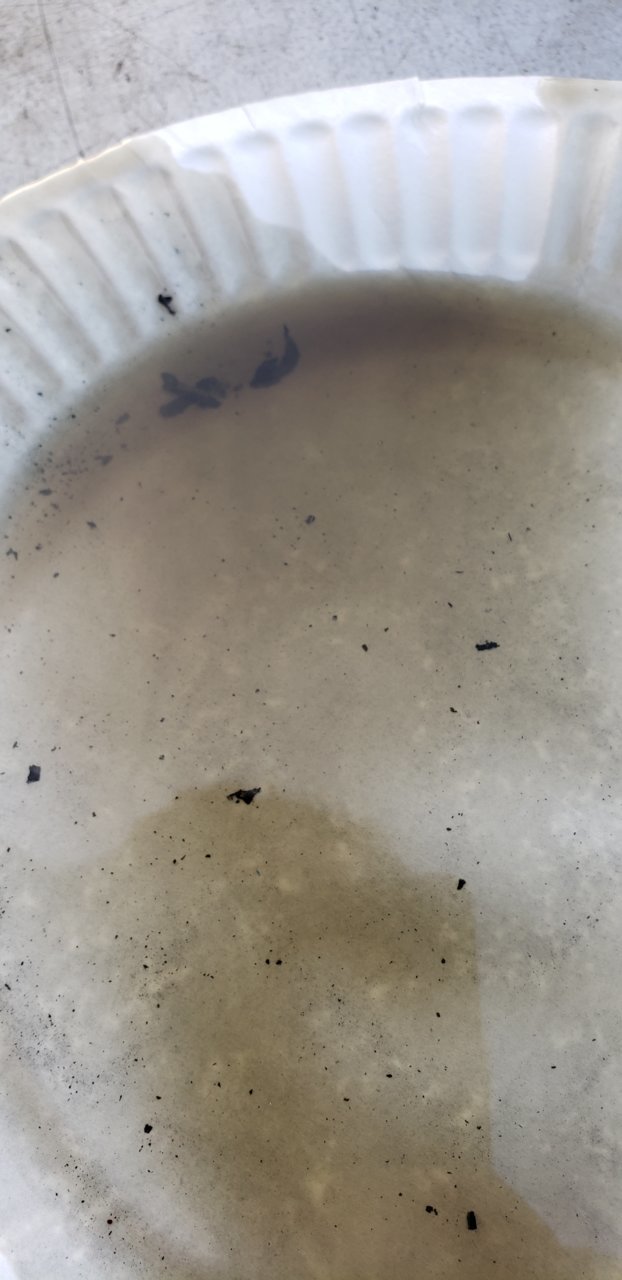

    I couldn't resist. Went out and pulled the plug. Only about a cup of oil came out and it had shrapnel settled into the drain plug.
    I don't know what the root cause of oil loss was yet. I can probably conclude the damage was due to lack of oil. There was oil spewing between the transmission and the crawl box. There is a seal and aluminum spacer between the two and I think something nave have gone out between the two.

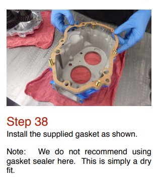

    Get this- I didn't know the crawl box was supposed to have its own seal*s* and gaskets. I just RTV'd a bunch around it. I'll attach photos in a few weeks once I get everything apart and examine the carnage. The crawl box and transfer case should be just fine. I feel like this one got the best of me this round, but you win some you loose some.
    I just bought a gasket and seal kit for the crawl box from LROR. However, in regards to actually getting all this back together it probably wont be a few months into next year until I can get another trans. I did all I could with this project in hopes it'd all work out okay, but I just don't have the room to shell out for another transmission this time of the year. It drives me nuts because I am so close, but it is what it is at this point.

    This is the only seal when using a crawlbox, attached to the aluminum extension. What gasket are you referring to with the crawlbox?

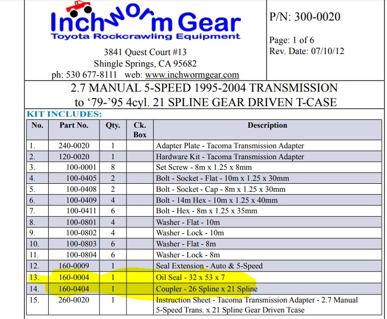

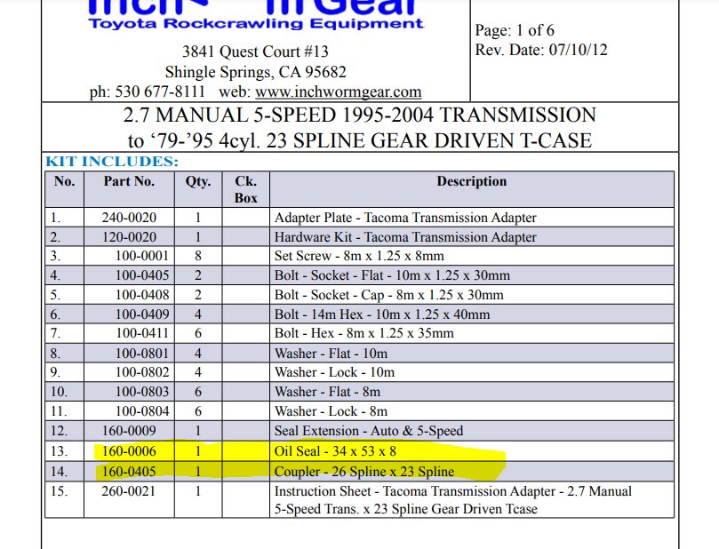

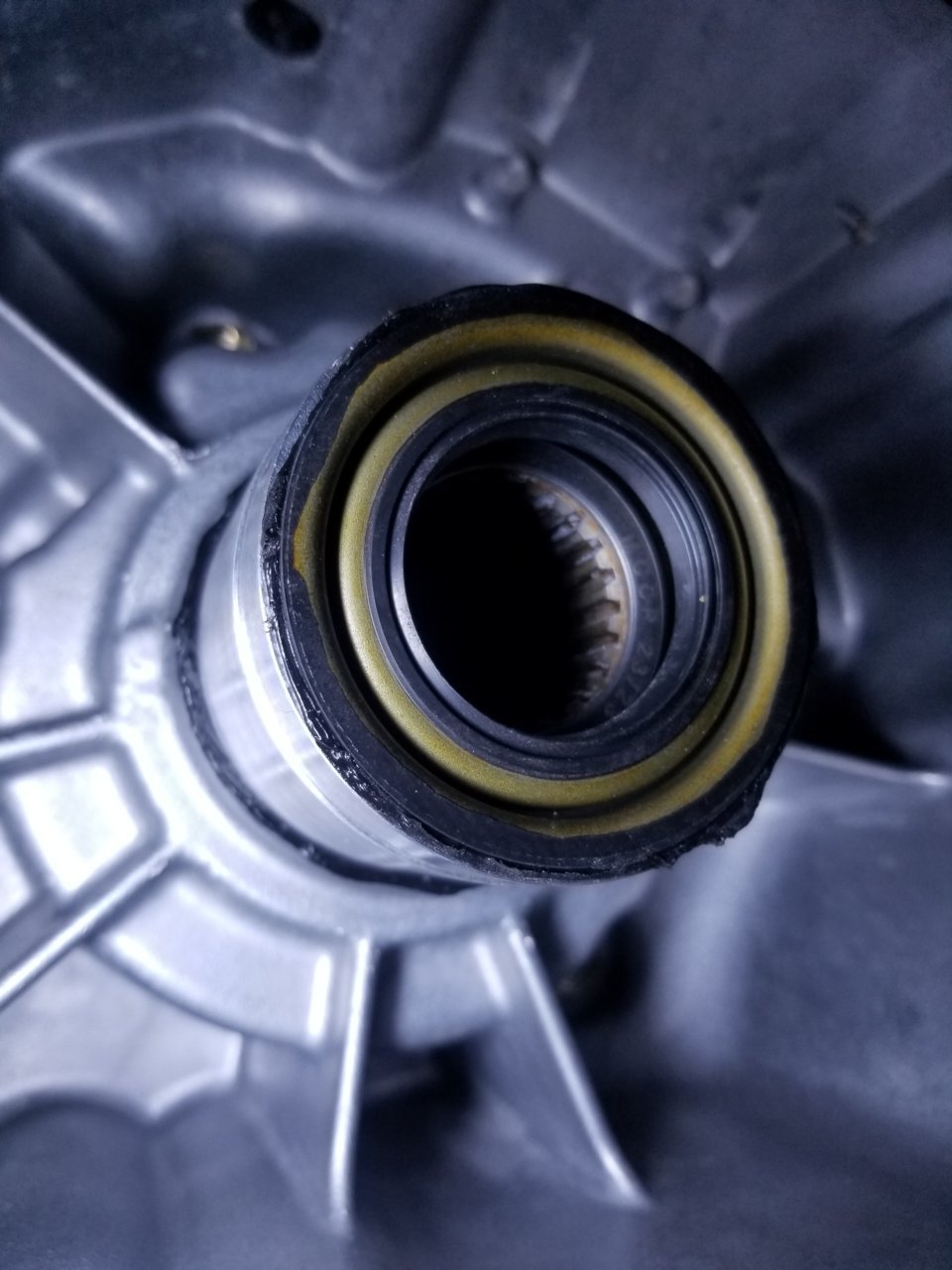

    Wow- I totally figured out what had happened.
    Remember when I had the 26 to 23 splined adapter in the kit and it didn't work but I had sourced the correct 26 to 21 splined adaptor at Trail Gear?
    Check this out....mind blown.
    Look at the seal size
    And the ever so slightly smaller seal with the 21 spline shaft which I have.
    Well, that explains where all my oil went.
    So I was looking at this stuff and saw-
    The gasket kit I ordered had seals, but it looks like I don't need the seals, but that must have been for a stock application. However, there is a gasket that goes on both sides it looks like.
    I feel much better now that I actually have slept a full day! :thumbsup: Bummed out about the situation, but I feel good about what I found out. Looking forward to getting this right once I get another transmission!
    I really cannot thank all you guys enough for the help and feedback on all this stuff!

    No one I know, my self included don't use the supplied paper gasket. My tacobox arrived with RTV from MC and other crawlbox we built, we use RTV. The paper gasket wouldn't be the culprit of your issue. The aluminum extension seal being the wrong size (if smaller) will tear (if the coupler OD is too large) and cause oil to transfer from housing to housing, causing your transmission to run hot and dry.

    I was in the opposite situation- I ordered a new seal identical to the one in the kit (which looked a bit dry) and it was the bigger one for the bigger shaft which I was unaware of at the time. But I can see how it would be just big enough to let the oil out @ 2mm oversize on the ID.

    When considering 2mm difference, it may not seem like a big deal, but over time, oil can seeped pass the input and empty the transmission or vice versa.
    Have you drain the transmission, crawlbox, and 4wd section and see how much oil is left in each section?

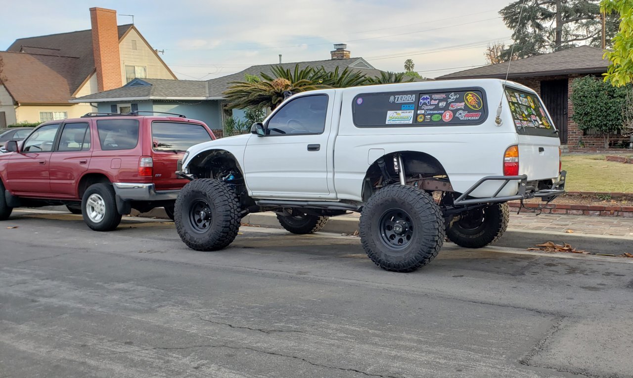

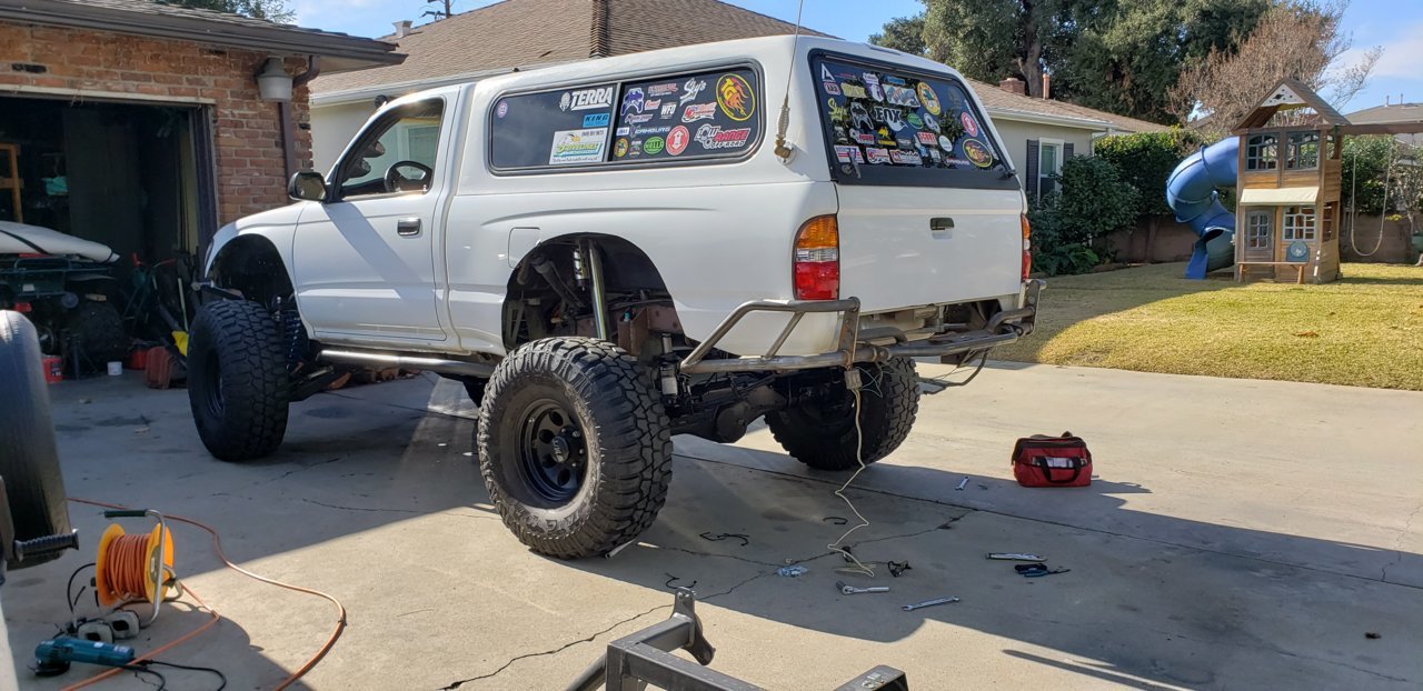

    Bumper is barely hanging on with one bolt, but picture for reference and there is a bottle jack holding the leaf down a couple extra inches for bolt clearance on my shackle...
    Going to do a thin piece of steel between the bed and the bumper to cover the gap showing the air compressor and thank sitting there.
    I dig it though. Waaaaaay lighter than the other setup.

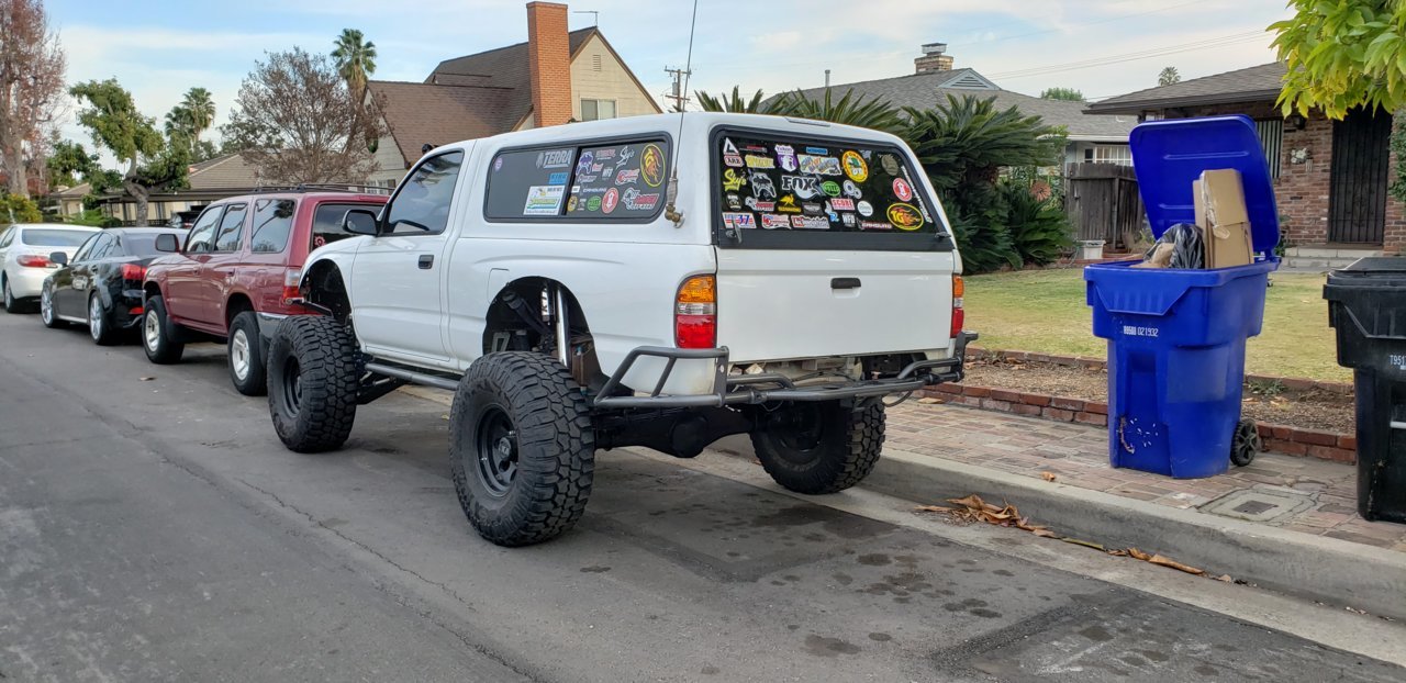

    There we go!
    License plate will sit perfectly within the big gap between the tailgate and bumper.
