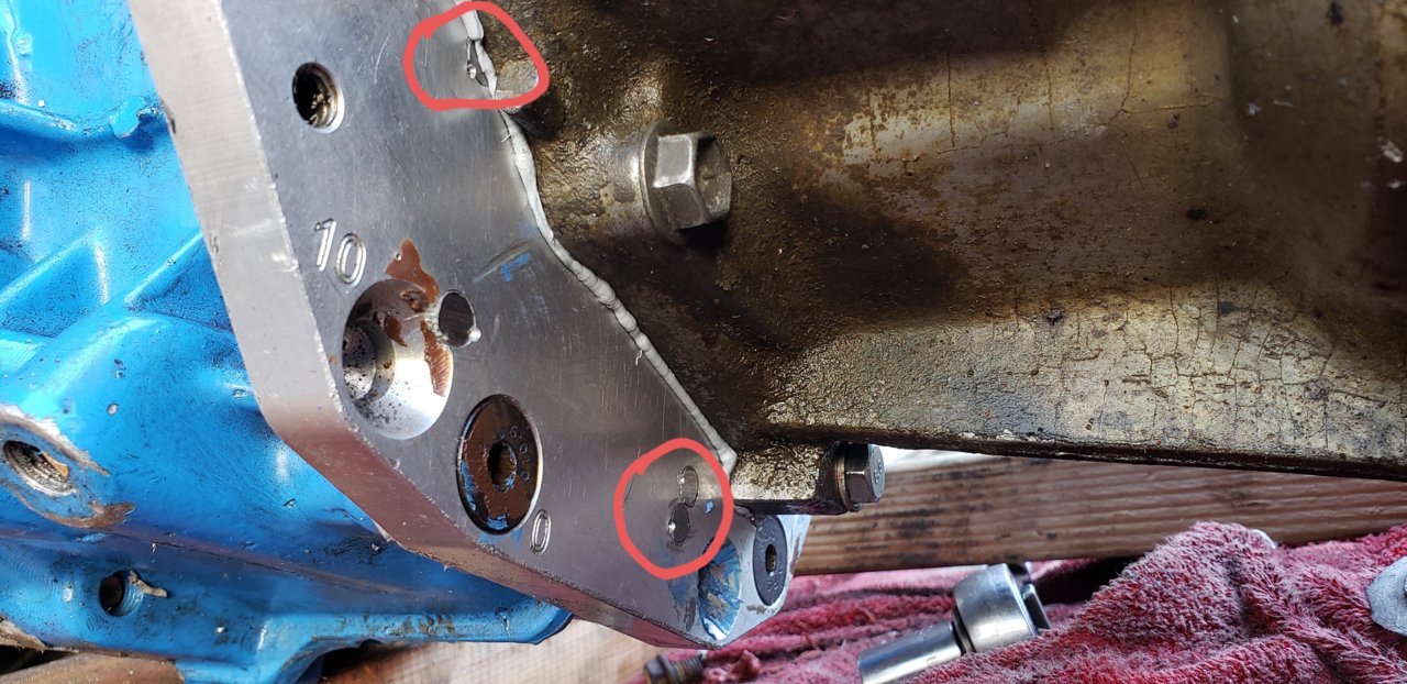

    Crack has been welded.

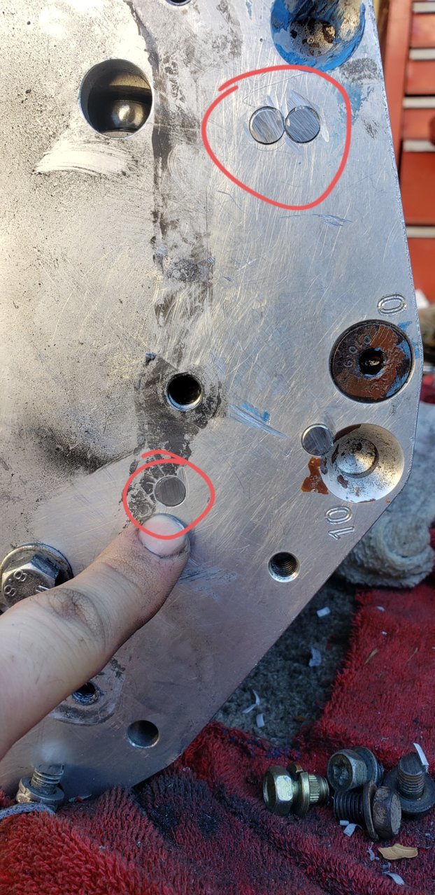

    Leaks have been officially traced as I KNOW I sealed the adapter plate good. I spun and punch locked bolts in and cut them off to plug the unused holes spilling out oil.

    Truck is leaking a ton between the transmission and crawl box. I cannot figure out why. By the design of the crawl box you can see the drain hole/bearing in a photo a couple posts above, it shares its fluid with the transmission output shaft cavity (which would normally be dry connected to the factory transfer case).
    I used the 90 minute sealant upon the last disassembly and let it dry well within the recommended time. It is fine and dry everywhere else. But I am STILL chasing a BAD major leak between these two spots and it is driving me crazy. This is the third time I've put this setup together and it consistently leaks from that area.
    I am beginning to speculate that something might be warped.

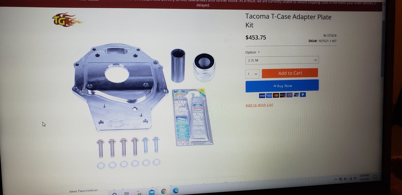

    I'm thinking about going with the trail gear adaptor plate. There are a ton of bolt holes and configuration stuff with the inchworm plate. This might solve my problem, but I'm going to sit and think about it for a while. I have a feeling this'll be the route I go.

    The Marlin nutswingers will fight it tooth and nail but that 10* adjustable adapter plate is a disaster from a leaks perspective. The TG one has far less opportunities for leaks. It’s as bad as the inchworm 360* clockable adapter

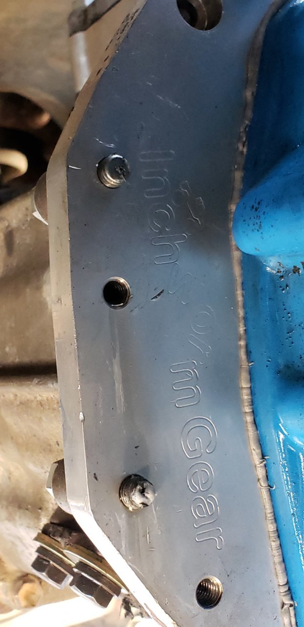

    I had an inchworm plate and never dealt with leaks like that. Evrey threaded fastener needs RTV and all those plugs need it. Make sure the surface is CLEAN and scuff it up a bit with some entry cloth. Make sure the trans side is clean and scuffed up as well. I always used "the right stuff" not that grey crap marlin recommends. You are on the right path with making sure the output seals in there right, I would not put RTV on it though, if it came off that could mess some stuff up.

    I see where I went wrong using the great stuff instead of the red Locktite on the coupler, and I now see why I really only need it on the transmission side and not both. I have finally stopped all leaks at this point. Went for a drive and crawl box is filled up high. So that does in fact mean the transmission is pumping fluid through the coupler and draining into the cavity. I feel good about this next attempt! Thank you for the feedback.

    So figured out why I had mixed results with all these attempts and wanted to share-
    So obviously on the inchworm adapter, those bolt holes are like drain plugs. Since last week they stopped leaking.
    Another one that got me is you MUST install the coupler tube with red loctite on the transmission side. It cannot go on the crawl box first with the way this stuff fits together. I thought this stuff simply squished together equally with sealant. It wasn't clear to me at first, but now it all makes sense with how this stuff works together and how that piece needs to be isolated to the transmission. That was probably the biggest unseen mistake I made with all these attempts.
    My coupler tube is set and seal is in. My fingers are crossed for this weekend that it all works as it should finally!

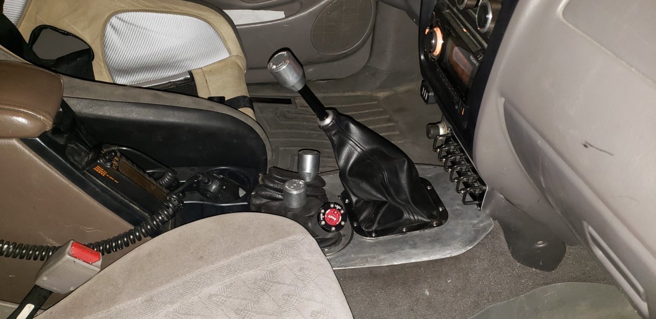

    Guys! No leaks! Not a drop! Unless I ran completely outta oil again hahah.
    Made a little trim plate too

    Ian
    Concord, CA
    2000 Tacoma SC 2.7 4x4 5spd
    Looks good! I like the trim plate you made.

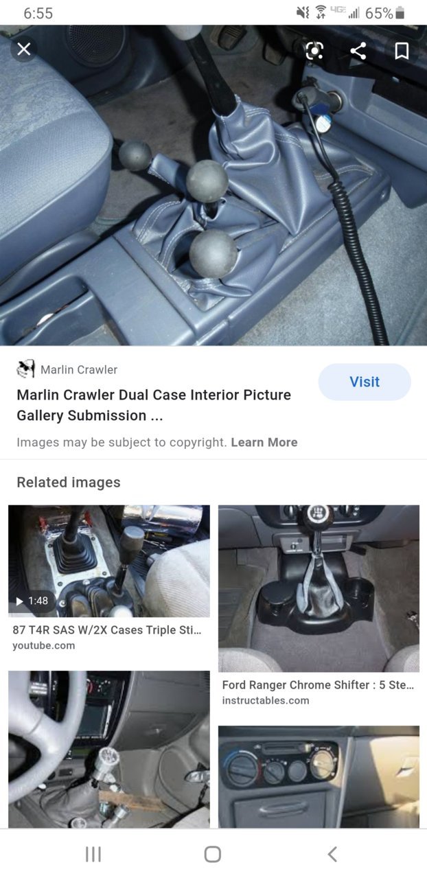

    Thanks!! Cardboard template, 1/8" aluminum plate, a hammer to round edges and it actually came out roughly 1000% better than my extremely low expectations.
    I belive I got the boot off summit racing. Forgot the brand but once I jump on the computer later today I can link you the ring and the boot.
    Looking to see if I can find a similar thing for the triple stick as the rubber boot is too stiff and putting too much pressure in low range.

    Here you go.

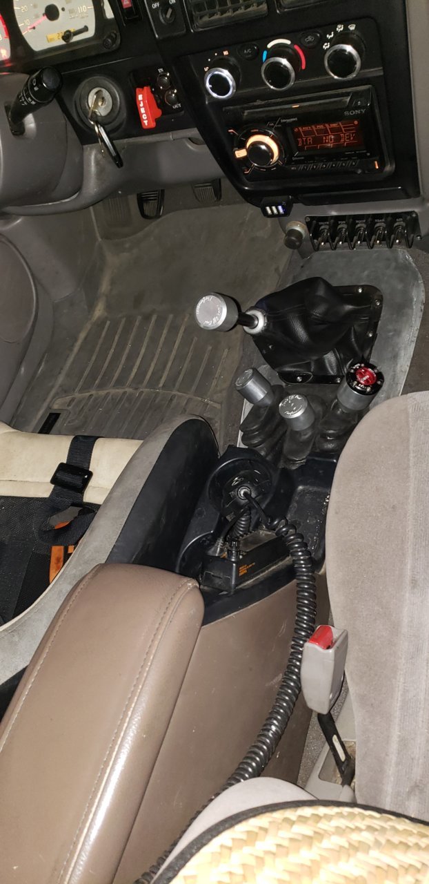

    And my goal soon is to find some single black vinyl boots and sew them together and makes something like this for the triple sticks.

    Right on thanks. Yea I kinda did that with mine with the whole one boot for all of them, but I think soon i'm going to re-do it all.
