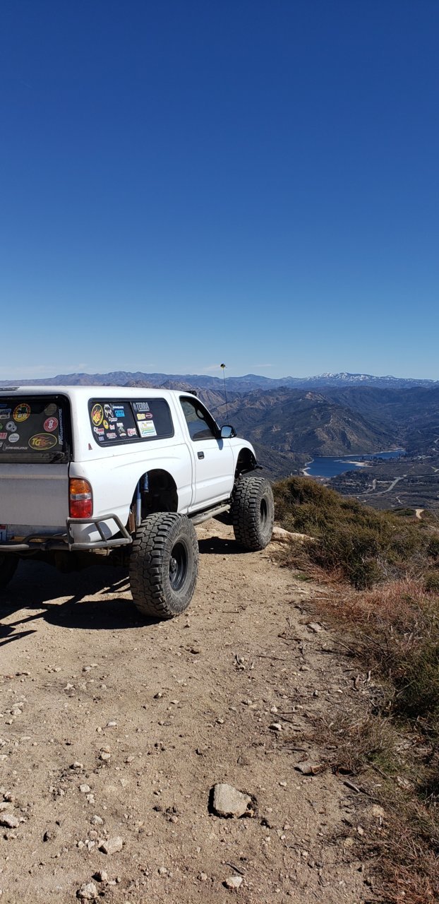

    Running AWESOME!
    Dry the whole time to and end of trail. Got back to my buddies place aaaaaaaand there is fluid everywhere again...

    Hell yeah guys driven a couple hundred miles so far and she's running great and no leaks!
    Change of plans to just run Cleghorn this Sunday, but I'ma purposely hit things haaaard, try to break stuff, and see what happens for a real shakedown.

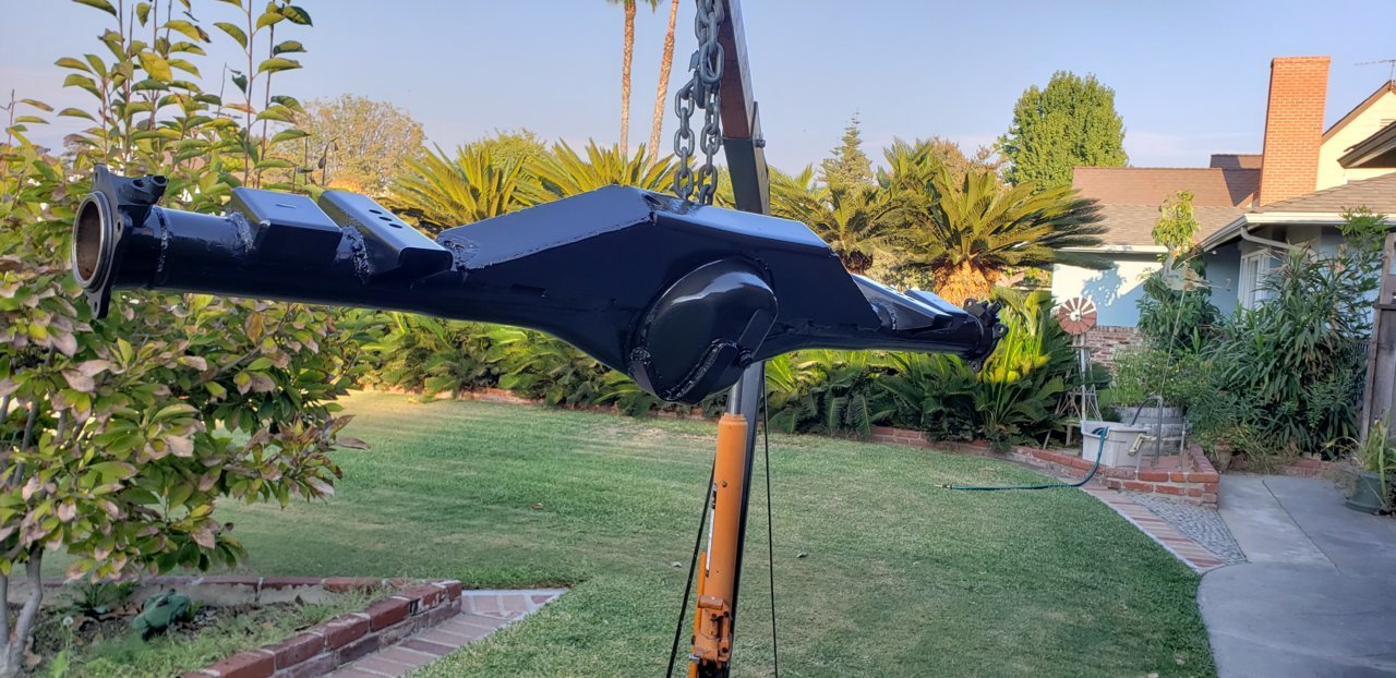

    Did your stock tacoma diff bolt into the tundra housing?
