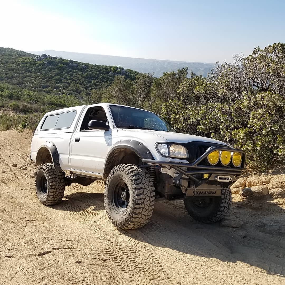

    Out cruising towards big bear!

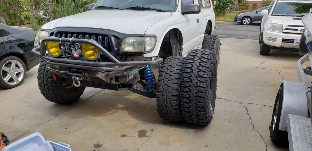

    I think they'll fit!

    Heeeeell yeeeeaaaaaaahhhhhhh. Other four won't be here until mid may. This is the rim I ordered a long while back for test fitting.

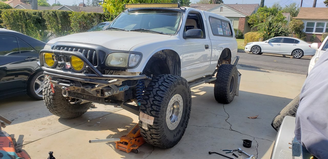

    Well guys, I am FINALLY officially 4 wheel drive and dual locked. Just got the diff and ADD spindles in. I can't wait to test this out in the dirt, but I'm definitely going to install my lever lock holding brake before I go out on stupid stuff.
    Odly enough, I can DEFINITELY feel the slight power loss from spinning the front end.
    I'm fine driving around on 35s. Truck is slow but drivable. I have a feeling once I go 38s I'll probably do a low boost supercharger. I'm not interested in another motor swap. I have zero interest in making a bunch of power. I just want the truck to be "drivable" if you know what I mean and think this'll he the easiest simplest solution.

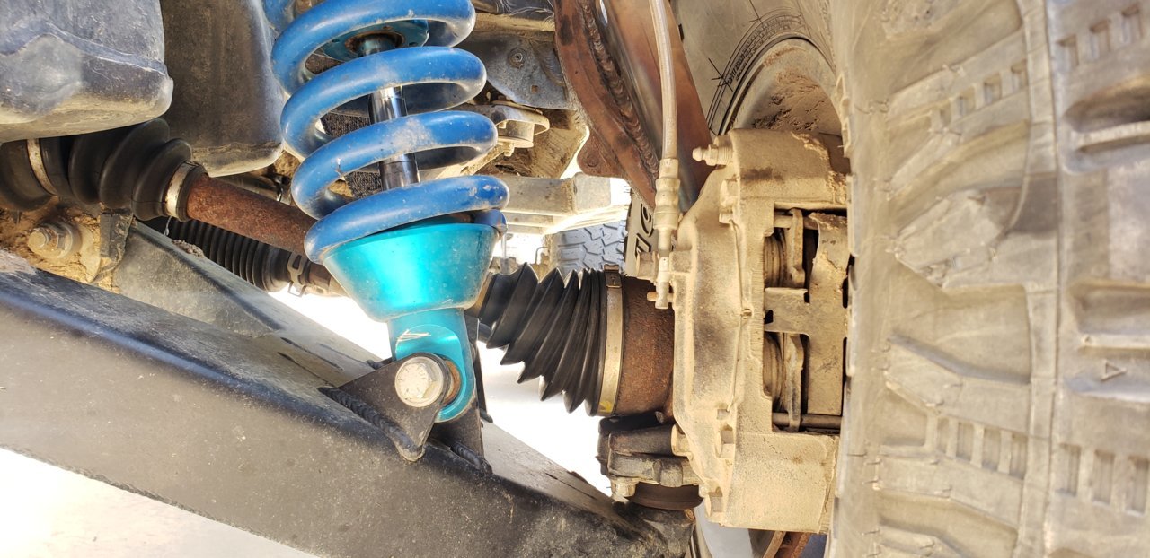

    OEM boot ribs touching and wearing.
    Porsche 930 boots. I tie wired one side for now because the hose clamp wouldn't clear the LBJ mount. Going to order some band clamps for that.

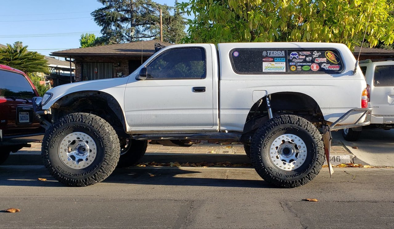

    Looks much more balanced with the 38s in the cut out fenders.

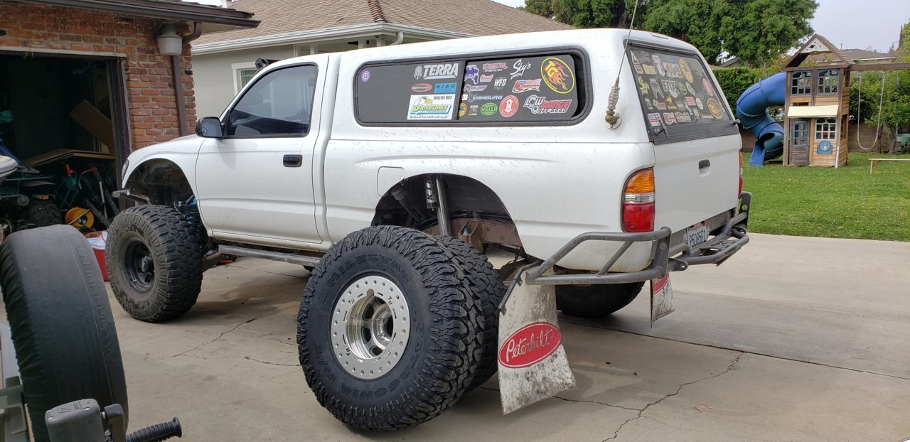

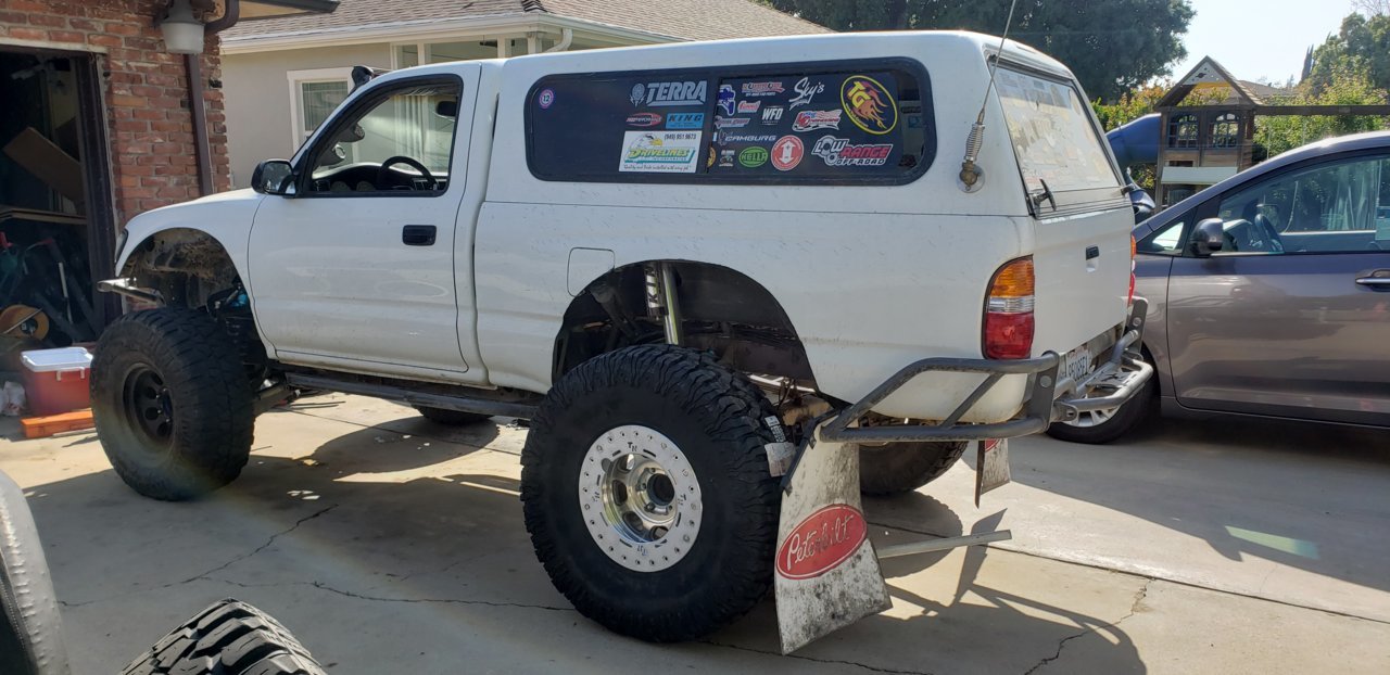

    Well, it rolls! Put the tires and rims together late last night. It was worth the 3 hours of sleep I got to throw these together to see these mounted up.
    All I can say is I'm glad I have the Tundra brake kit sitting in the garage. Stopping with these wheels feels like stopping on an old bicycle with wet rim brakes lol

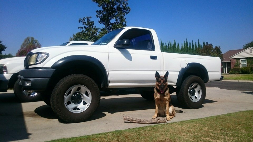

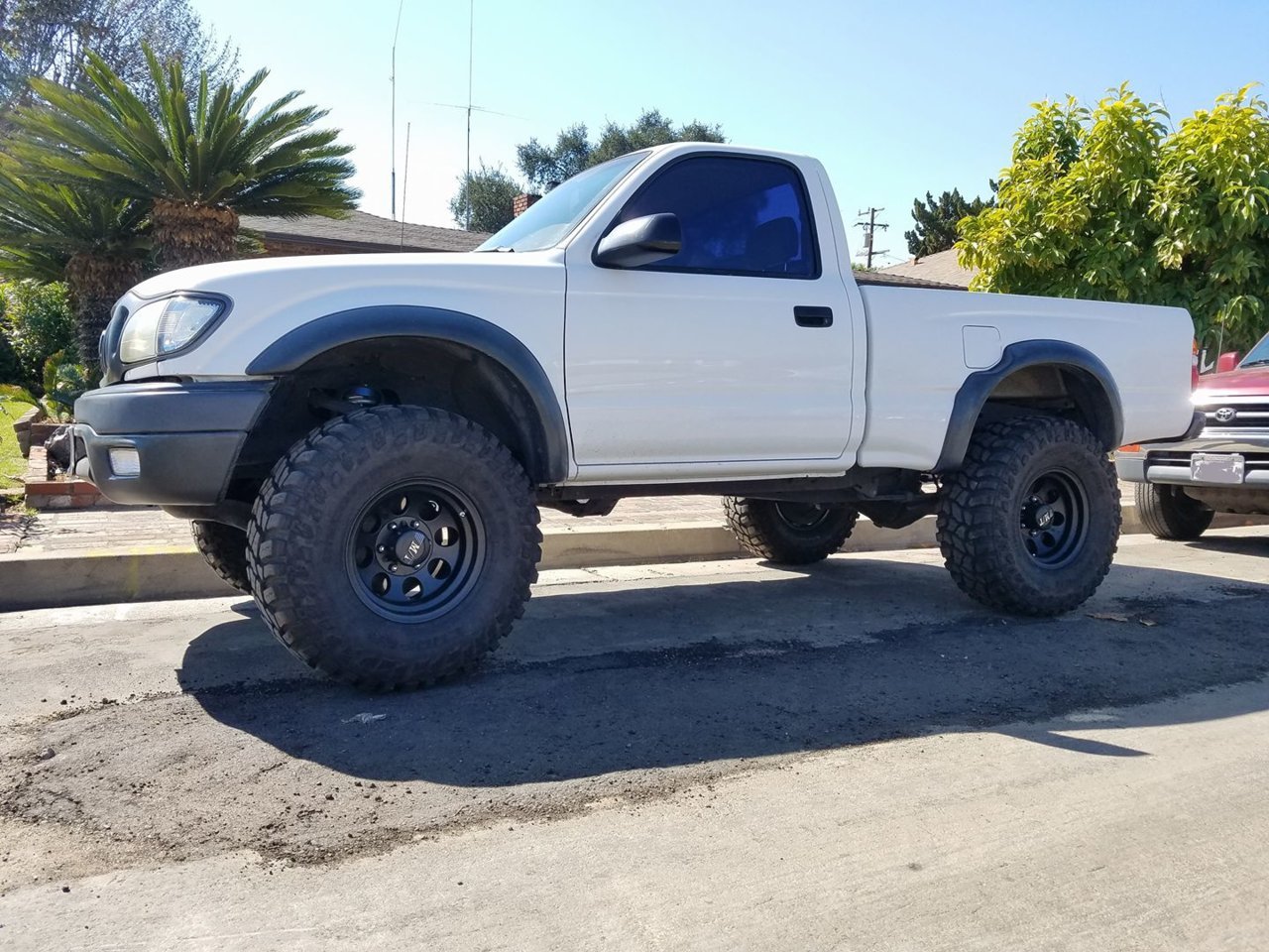

    Kinda neat seeing the changes throughout the years...
    I have ZERO regrets doing what I did to the truck up to this point and am looking forward to fine tuning shocks and stuff now, but in all honesty the mid travel setup I was running before I jumped LT was wicked awesome. That setup was so dialed and ran so nicely. Only issue I had was constantly overheating my shocks pretty much every single time I went out. Everything seemed to just work so dang good.
    Aaaand here we are five gallons of gear oil later LOL
