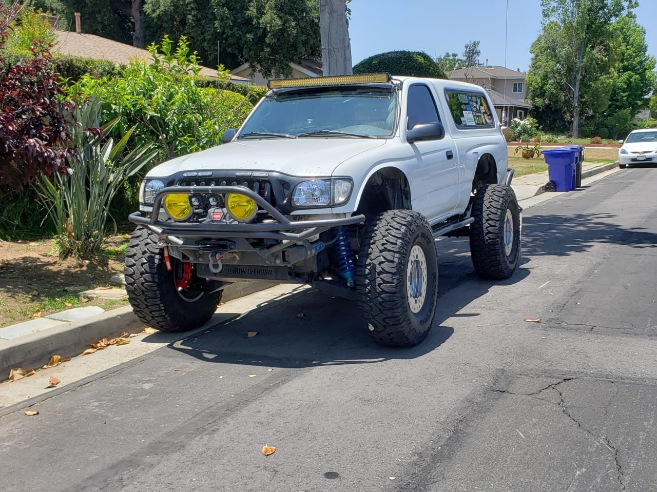

    These look good with ifs and 37s. Proportions look inline. Interesting to see how the front holds up to them though

    38s actually LOL!
    I'm pretty easy going on my stuff, kind of... I don't mash and jam things, but I am rough on stuff at speed. All I can say is I a VERY GLAD many of you really pushed me to go with the ADD hubs and spindles over the manual locking hubs. The size difference was definitely noticeable and I'm sure the strength is too.

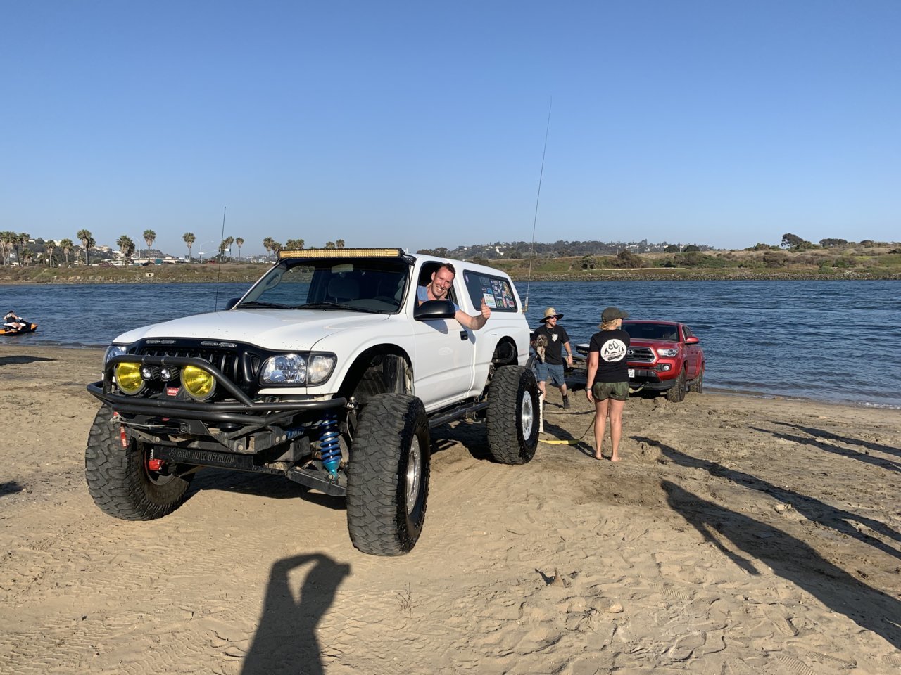

    Hahaha that's an awesome pic!! Thanks man.
    Did anyone happen to get photos of @Nicklovin hanging out the passenger window with my steering wheel?? LOL

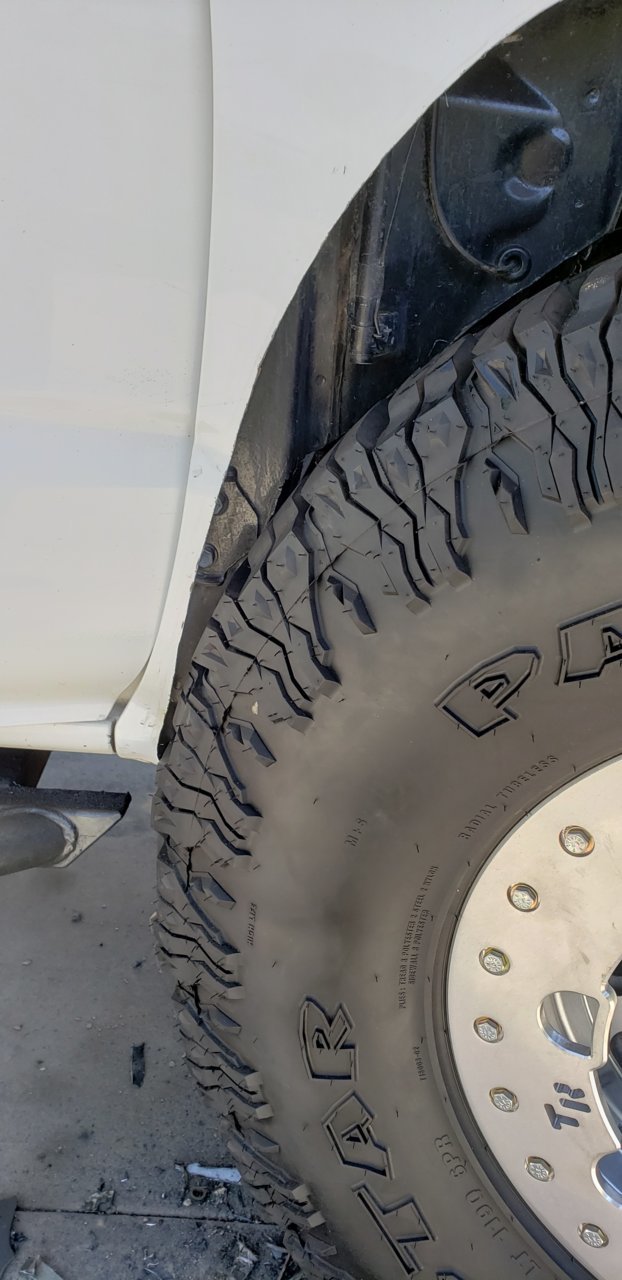

    This is such a massive pain.
