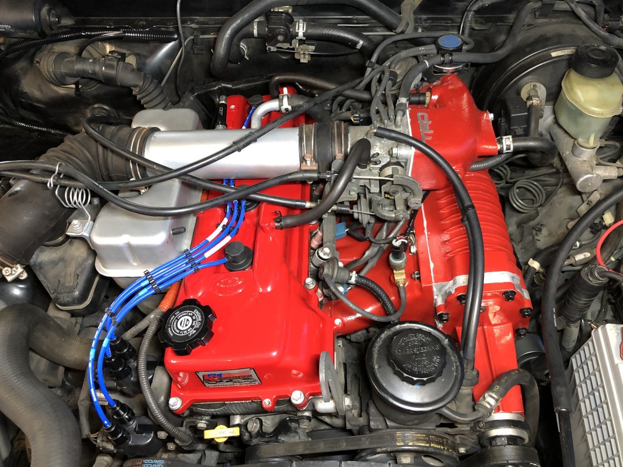

    That's a CLEAN setup you got in the posted pic! Thank you for sharing your setup as it definitely gives me a ballpark idea of where mine sits at.

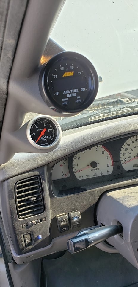

    Shot of current gauge pod setup...

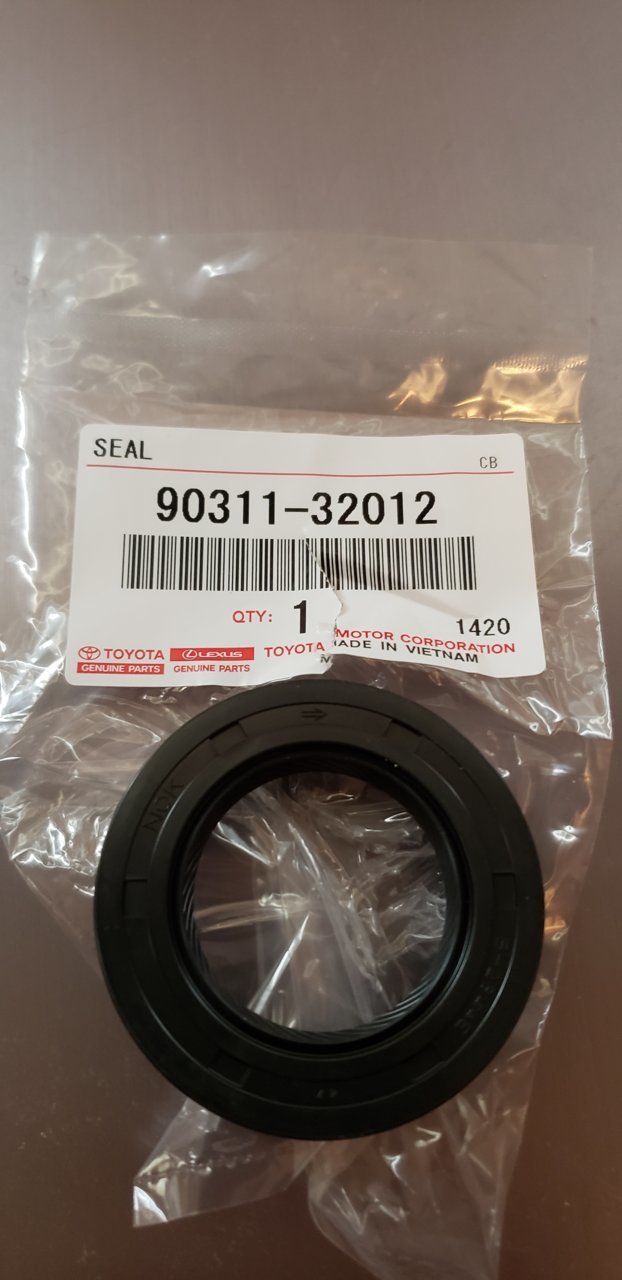

    This looks extremely promising, aaand it's Toyota! Seal does not feel as 'plastic-y' as the other one if that's the right way of saying it. It's more squishy/rubbery/thicker feeling around the seal as well. Another way to describe this is if I were to peel this seal back it would be a lot more elastic rather than just snap off rubber. Not that the other seal was dry rotted or anything, just a big difference I noticed and feels like the original one I had in the kit.
    Fingers crossed for the.... Sixth time removing/splitting the trans?
