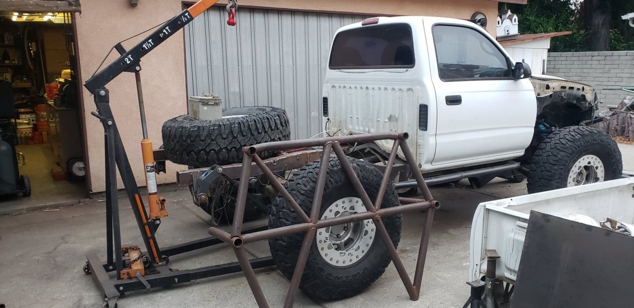

    Truck is pretty much stripped and rear frame rails completely stripped! Giant Motorsports 64" kit upon fitment the level of awesomeness is directly equivalent to their massiveness! Trying to get this done and making it to the Fiesta Island meet!

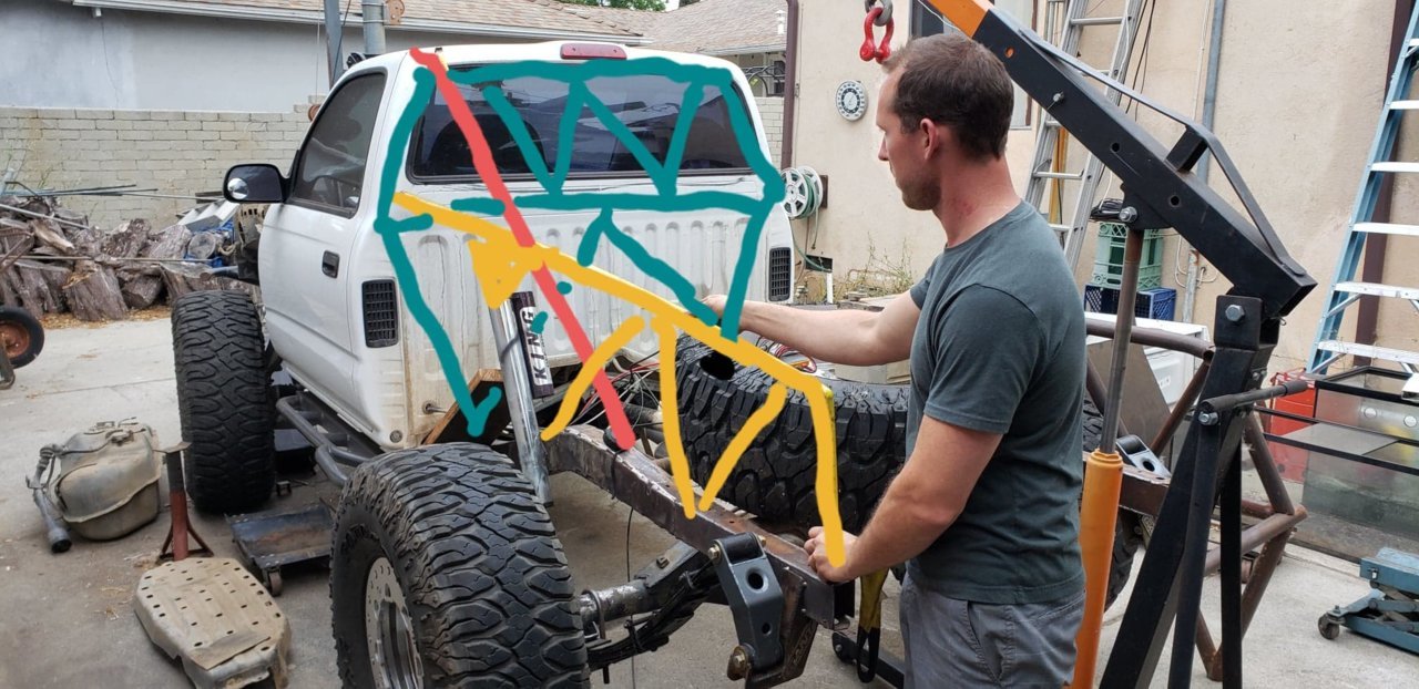

    Okay so this is kind of where my ideas are at.
    ...and before you guys call me out on it, NO. That's just a birthmark on my neck! It ain't nothing more than that!
    Got a handful of 2"X0.120" Chromoly tube from Geoff so that's what I'll be using for the external B pillar and majority of the interior cab cage. Most other stuff will probably just be DOM 1.75"X.095/0.120." 32 Gallon fuel safe fuel cell will sit right behind the B pillar.
    Here is a bare bones outline I doodled off my tape measure. Obviously everything will be tied in amongst each other at some point. Again, this is just a basic idea I'm trying to paint a picture with in my head before I actually start landing tubes.
    With the way the middle tube (yellow) that goes from wide part of cab (under the window) to the end of bed and where the main top tube (red) comes down it gives me a perfect place to make a simple double sheered plate bracket for the shock to land on, but that'll be more specific once I figure out where to land the shock when cycling the suspension.
    Plans amongst this layout is the bead roll some panels and use them as filler plates between the cross bracing in the bed.
    Beyond that I'm going to be making a "universal" carrier for the spare. First configuration will be sitting back a bit further from where it's pictured and tipped back towards the hoist a bit, but giving me a minimal amount of bed room and is a little bit behind the axle and probably ideal for everything.
    Second configuration will be flipping the tire carrier and the tire will act nearly as a bed extender giving me a ton of space, ideal for loading camping gear or whatever in the bed. It's hard to explain, but I have an image in my head I'm confident about and makes a lot of sense...

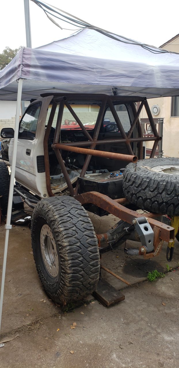

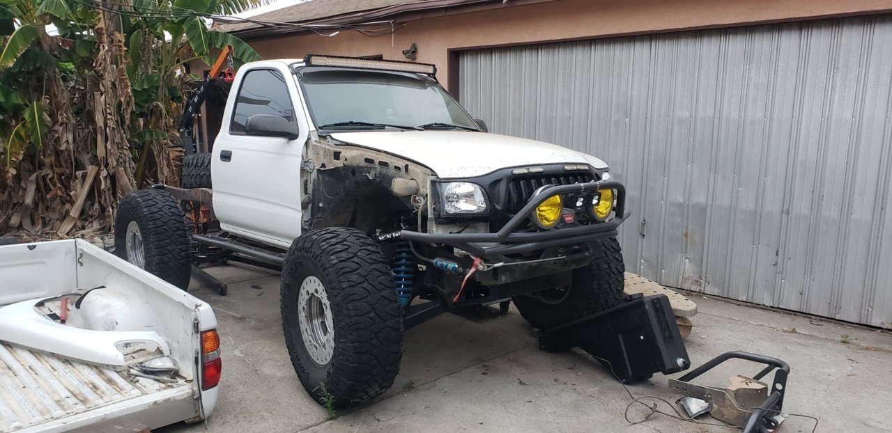

    Little update for you guys-
    Got all the main tubes landed. Need to gusset and support all of them still.
    The old school hella HID (the real one, not retrofitted one) is on. As much as I wanted to do a linear actuator for it, I am going to just keep it on a simple stick to raise it up and put it down. It's insanely bright. No comparison to my old light bar.
    Fuel system parts ordered. Going from fuel cell>40 micron filter>low psi high flow holley pump>swirl pot>holley 190 lph pump, then to factory fuel filter and rail.
    After going back and forth with myself a ton I decided this was the best option for two reasons: holley fuel mat was too expensive for a non serviceable piece, in tank collection tanks didn't seem like they work all that good with the one way flappers, so a surge tank/specifically a swirl pot seemed like the best option. Second reason is it's extremely easy to pump out fuel with the high flow pump to either transfer or drain fuel with this setup.
    I'll get you guys some photos within a few weeks! This thing is actually coming out pretty good and it looks like nothing else I've ever seen...
