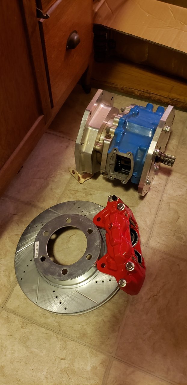

    Soooo I'm just going to leave this here.

    You’re gonna love the crawler. Definitely take up @slander on his offer for pointers. His check list helped me so much. Lots of little things you’d never think of.

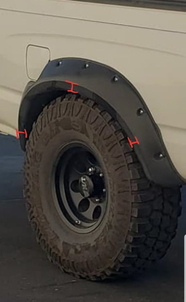

    Sweet build! I have a question, are you sticking with IFS or are you going to SAS? I am interested in dual casing my truck but was wondering if it was worth it with IFS. If you do stick with IFS, how do you plan on fitting 37" tires on without SASing? I'm excited to see the build!

    There are actually quite a few dual case IFS builds on here and many other forums. In fact, I'd argue that you would probably be less likely to break IFS parts dual cased than you would you would with just stock case reduction due to the amount of control you gain. Obviously this is completely situation dependent, but I am talking from a rock crawling point of view. No doubt that SAS is stronger in every shape and size- but for my use and time I really don't have any interest in SAS.
    I am going to MCM Long Travel my front, which means I don't have to cut nearly as much out of the firewall. I have a 1" body lift as well. That being said, take a look at how my 35" tires fit perfectly within the flares. The lip of the flare is about 1.5 inches. The radius of a 37" tire is just an inch bigger than a 35" tire is. If I cut the lip out they should fit just as tightly.
    I am torn on the rear end...I think 3 linking is just going to be way too much cost and work for my use. I am beginning to lean toward the All Pro heavy duty leaf pack. For absolute sure I am doing long travel in the front. No matter how I spin it, I will definitely end up with a wider 2nd gen rear axle to match the front width.

    Duals are hands down a better mod than a solid axle swap and will make a manual IFS truck way more capable than a solid axle.
    OP, I’d be careful going to a 37 on first gen IFS. CV’s start to break pretty easy on 35’s, a 7.5” R&P isn’t much beef, and the stock steering rack will struggle to turn them.

    37s on first gen IFS: Challenge accepted! Will run the 35s for a while and might be really happy with them- we'll see.
