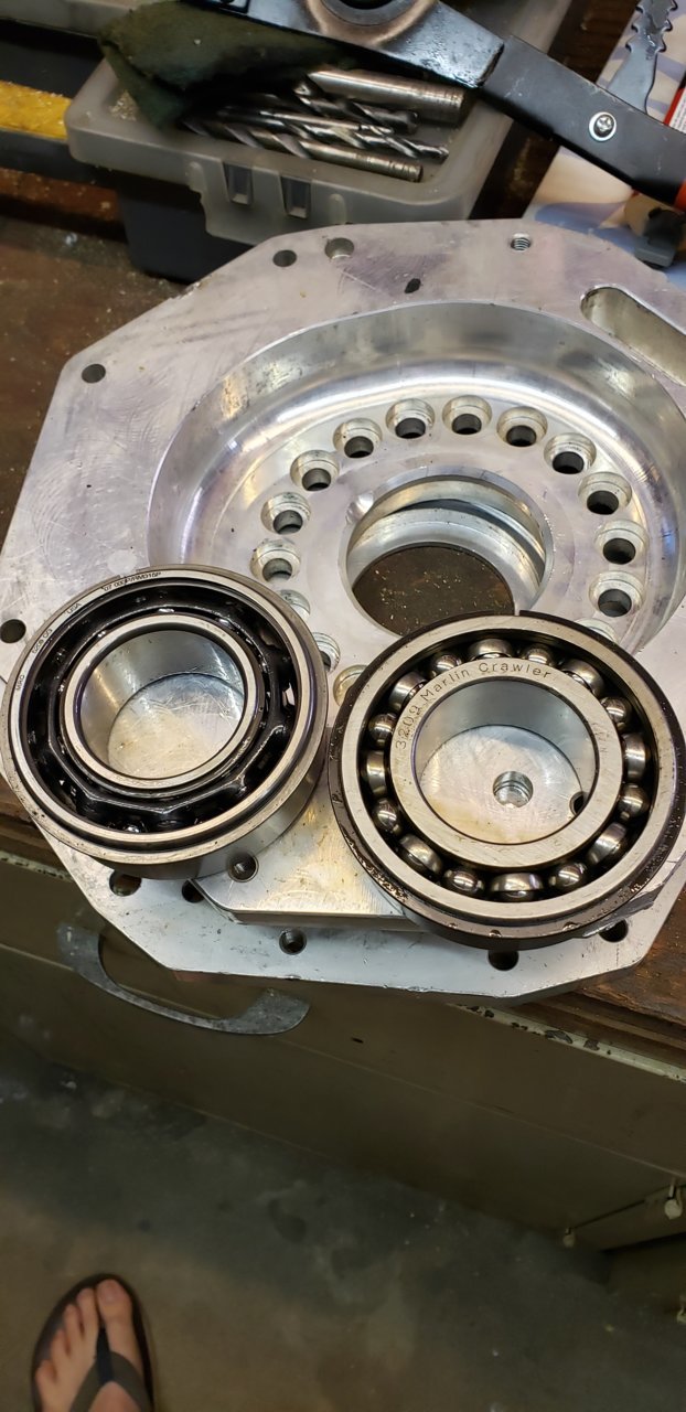

    Putting in the stronger main bearing today.

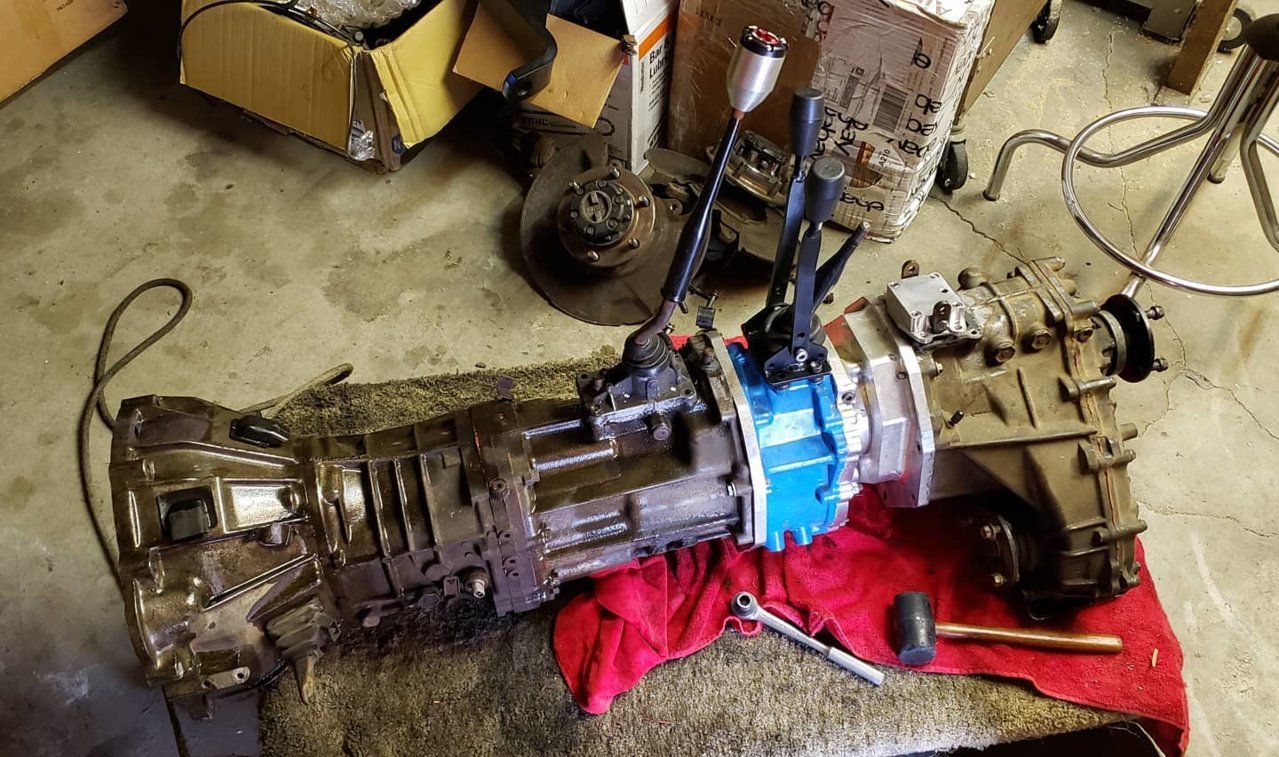

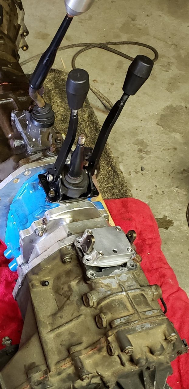

    Soooooo....
    Only two issues-

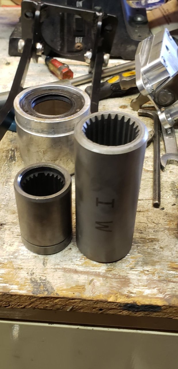

    Splines...I need to find something to mate the smaller transmission shaft to the larger crawl box shaft. The adapter I have only fits the crawl box and allows the transmission splines to spin around inside because it is too big.

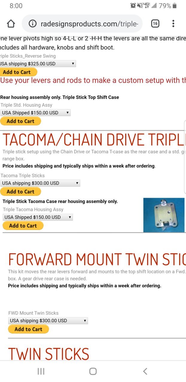

    Other issue is the RADesigns kit that I got in the sale. It fits the crawl box flange, but not the actual factory J-Shift transfer case.

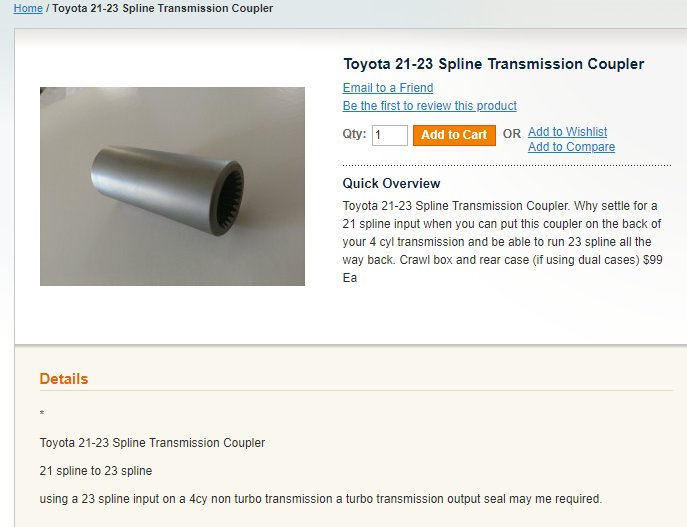

    I don’t think that adapter will help you. You need a 26-23 spline adapter since w59’s have a 26 spline output shaft that’s smaller than the 23 spline that comes on a340f’s and r150/151’s

    Just need to order the tacoma chain drive base from radesigns to fix that issue.

    Man, good catch!! I did the worst with assuming here...I had automatically thought "Okay, bigger shaft is 23 splines. Slightly smaller shaft must be 21 splines." Called Davez- My order of several things is already out dropped off at the station so I might have to ship the return.
    You're right about the 26 splines. I am going to see where I can find one of those to a 23 spline coupler.

    No problem, TG normally has couplers in stock...not sure if Marlin is still making a 26-23 spline coupler. I know Marlin told @rngr no last year when he was shopping duals for his W59.

    My fingers are crossed. From Nathan shortly after my initial message:
    "Thanks for contacting us with your enquiry. We do indeed have a 23-26 coupler available, but I need to know who’s adapter you’re using. Primarily because there are variances between adapters that could prevent ours from being used successfully in someone else’s adapter."
    I measured it and the inchworm adapter measures half an inch thick. My fingers are crossed this is compatible with their coupler.

    Good news!!
    So Nathan at Trail Gear took some measurements and is pretty confident they have something that may fit. Gonna try and see what happens!
