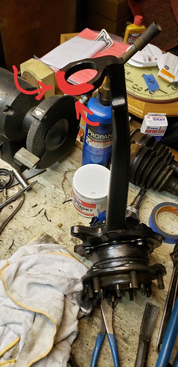

    Yeah.. But here's the thing-- you know the hole that the UCA goes into? The outer half of that cracked off. It's not like the spindle where it meets the load and the 90 degree bend snapped... I still cannot figure that out.

    I wonder if there was a tiny bit of play between the uca and spindle. Like missing a washer or something.

    Oh damn. That’s a first. I’ve never heard of spindle failure there

    So I am going to be picking up the MCM long travel kit in a couple weeks most likely and will do all this at once. Once I get my old spindles off I'll do some research to find out what went wrong. Mike might have a good point with some play in the hole. I didn't see any scarring on the heim spacer piece that goes in the hole though. We'll see...

    Here is the locking hub spindle for reference of where mine broke...

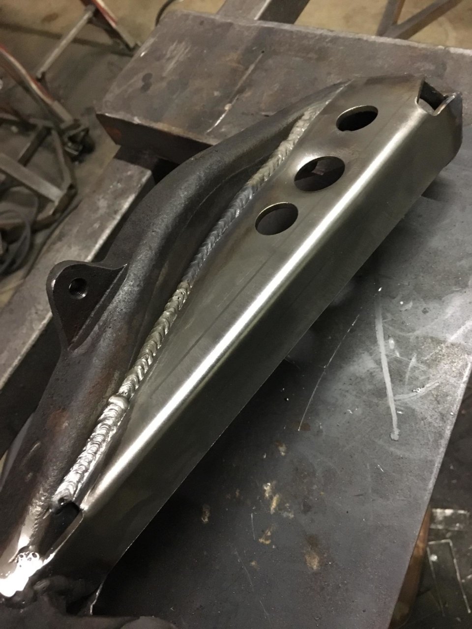

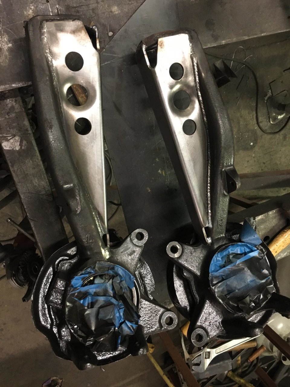

  18. Mar 23, 2020 at 11:47 PM

    What's with the center hole? Did you dimple it?
    LukeCC likes this.

    So that center hole is part of the gusset, but it was dimple flared (if that is even to correct term). My family's friend is a much better and far more knowledgeable welder than I ever could be and I felt this was something crucial enough to be done by a professional...
    I noticed that and had asked- what was explained is that dimple flare is for is a trick to increase rigidity and strength. For lack of a better way of explaining it in my words, it'll simulate a slightly thicker piece of metal being used, but without the cost or weight.

    yea adding dimples to metal is a great way to strengthen it.
    Never seen anyone add one to a gusset. Not a bad idea! Those spindles will be strong as hell now i'm sure.
