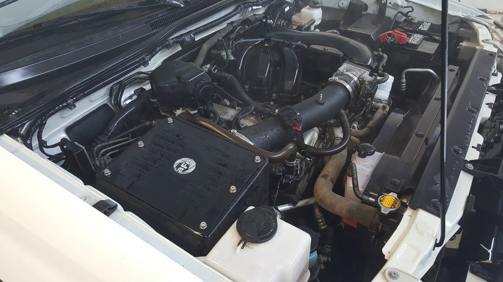

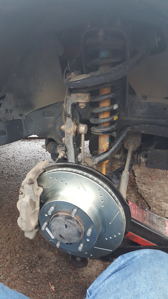

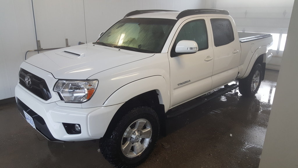

    So I was realizing that i have done a couple things to my truck already and haven't posted the pictures. but I figured I would add a couple pictures since they are easy things to do.
    First is the under hood picture of the AFE stage 2
    Here she is in stock form with 3inch front 2 inch rear lift and Duratracs freshly washed
    and here is the slotted and drilled power stop brake package that I ordered off Rock Auto. Love the new feel of the brakes. I had to upgrade because I just about killed myself hauling about 2000 lbs off a mountain.

    First... I call my truck Cerberus (three headed hell hound)
    It is a 2015 Toyota Tacoma Double Cab Long Box Trail Team Edition TRD Sport in Super White
    Currently on 315/70r17 Cooper St Maxx Tires on Procomp Vertigo 40 series rims and a custom 2.5" Lift. The truck sits 19" to the frame at the current moment while loaded.

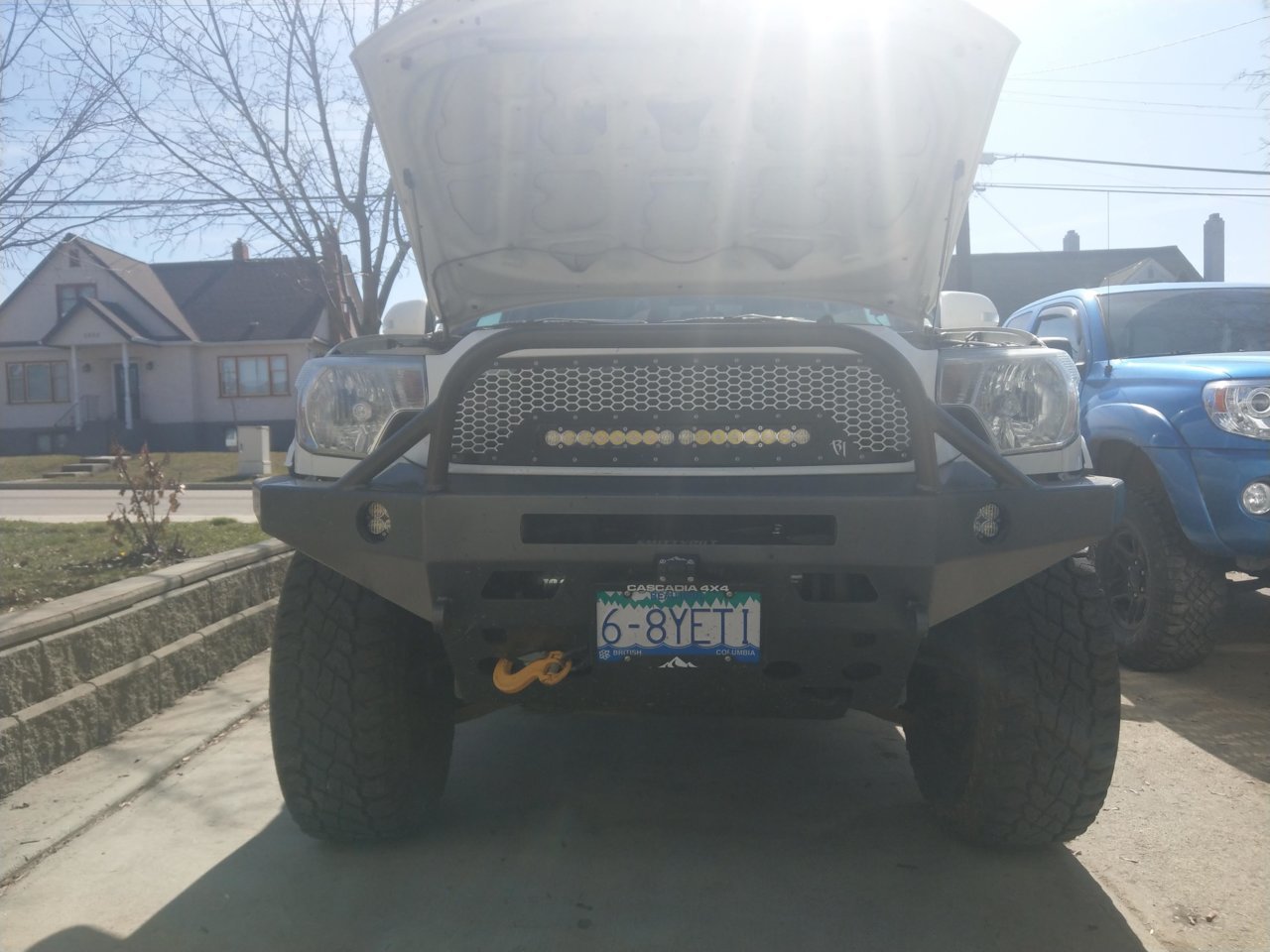

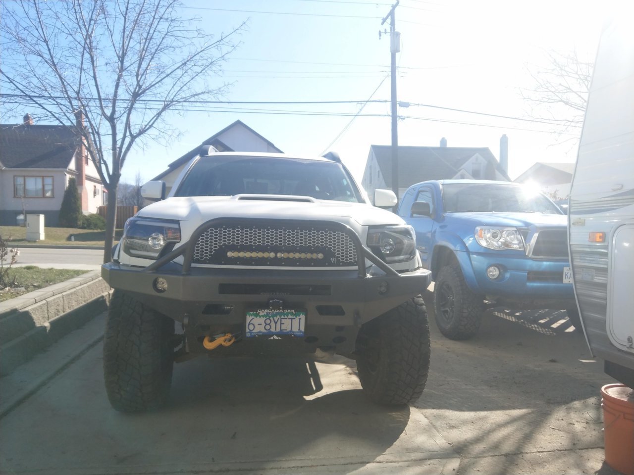

    Armor
    Pelfreybilt Aluminum Plate bumper w/Center hoop
    Pelfreybilt Steel High Clearance Rear bumper (full wrap)
    Pelfreybilt Aluminum Front Skid
    MobtownOffroad bolt on sliders w/kickout http://mobtownoffroad.com/product/2005-2015-tacoma-no-drill-bolt-on-rock-sliders/
    Exterior Accessories
    Smittybilt 10k x2o synthetic winch w/wireless remote
    - upgraded to Gemstone offroad Diamond series synthetic line https://www.gemstoneoffroad.com/products/diamond-series-winch-line
    Baja Designs Squadron Pro Fog lights https://www.bajadesigns.com/products/Squadron-Pro.asp
    Baja Designs S8 Led 20" Driving Combo Light bar https://www.bajadesigns.com/products/S8-LED-Light-Bars-Product-Page.asp
    Baja Designs S2 Pro Flush Mount https://www.bajadesigns.com/products/S2-Pro-Pair-LED-Work-Scene-Flush-Mount-Backup-Kit.asp
    Low Pro QT Tonneau Cover
    Tacomabeast upgraded projector headlights (desciption is wrong for link)
    https://tacomabeast.com/collections/headlights-tail-lights/products/3rd-gen-projector-headlights

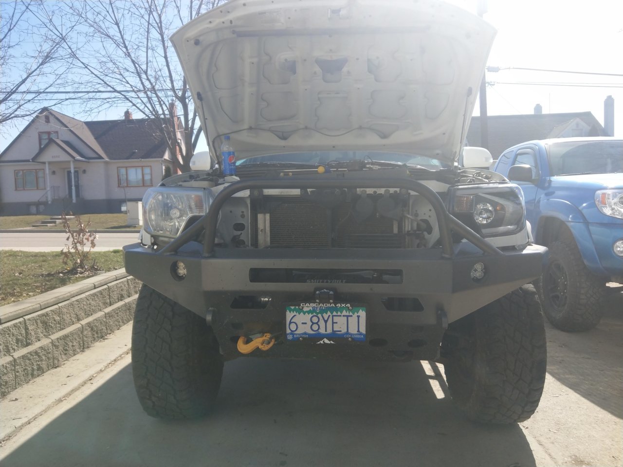

    Underhood Upgrades
    AFE stage 2 Dry Filter Air Box https://afepower.com/afe-power-51-81162-magnum-force-stage-2-si-pro-dry-s-cold-air-intake-system
    CSF Racing Aluminum Duel Core radiator https://www.urdusa.com/hd-high-performance-radiator-fj-cruiser-4runner-tacoma-4-0l-v6/
    Electric Single Fan Set-up
    - 620-101 Dorman 2 Speed Fan https://www.summitracing.com/parts/rnb-620-101
    - Dakota Digital pac-2750 Adjustable Electronic Controller http://www.dakotadigital.com/index....t_id=852/category_id=646/mode=prod/prd852.htm
    - Dakota Digital inline temp sender https://www.summitracing.com/int/parts/dak-140022/overview/
    - Custom Aluminum Shroud (work in progress)
    27F Interstate Battery

    Drivetrain Upgrades
    2015 4runner Disc brake rotors from powerstop HD slotted and drilled JBR1395XPR JBR1396XPR
    2008 4runner rear disc brake calipers
    Stoptech ST-40 Front Calipers
    Extended Stoptech Stainless Braided brake lines front and rear
