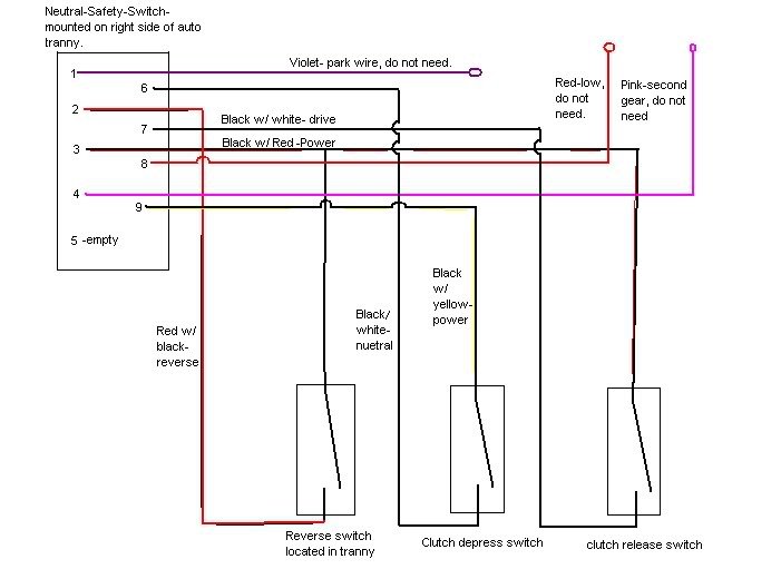

    good addition. I assumed that would be the case. But i trust my welding a lot more than my ability predict how the ECU will react to swapping a auto for a manual. So i assumed swapping cabs would be easier. honest the electrical work involved is an enigma to me.

    The gentleman selling the truck in MT just sent me this link: it is a nice explanation of the conversion of a prerunner to 4x4. Given how often i googled information about doing this i am surprised it never popped up.

    A few of us at TTORA did all the foot work already. Jeff put a lot of work into those diagrams.
    I was just about to post that @Cadmus. Beat me to it

    I was going to add it would probably be easier to get the ECU and additional wiring from a donor with the same setup. pretty sure 4x4 v6 would be the same ECU regardless of 2 or 4 door (extra wiring due to the 4-door for windows/speakers and such)?
