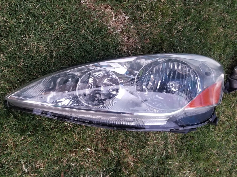

    Is this lens a projection type? Its factory HID low beam but a 9005 halogen high beam. They both have a cone over the bulb

    It is not, those are a (relativly) rare HID reflector.
    I'm surprised that it is HID, reflector based HIDs went out of favor pretty quickly from what I heard.

    Reflector based lights lack the same beam control as projectors.
    What was interesting to me was the use of a d4"S" instead of a "R" bulb. Typically a "R" bulb is used as portions of it are shielded to prevent glare (but also reducing output).
    edit: I was looking at the wrong year of toyota sienna, the newer ones use projectors.
    Admittedly I'm not up on hids so perhaps the new reflectors are different.
    Regardless it's a toyota, it's factory hids, no reason to second guess them, it must work well enough. Good on ya for cleaning the lenses.

    It is a Toyota OEM HID reflector. This isn't the same as running HIDs in halogen reflectors, the HID reflectors are properly designed for the HID light source to have a compliant beam pattern. HID reflectors are certainly less common. The very popular Lexus IS300 used HID reflectors.
    I'm seeing the 2005 Sienna use a D2R bulb for the low beam. In the D2R the Philips Xtreme vision Gen2 would likely be my choice, which will be a substantial improvement over the standard HID bulbs.
    As @Toy_Runner mentioned the best upgrades for the 9005 are HIR2/9011s. The best bulb is the Korean made Sylvania 9011. You can see the review post here. Sylvania, nor any stores differentiate between the high performance Korean made bulb, or the lower performance Sylvania 9011 German made bulb with the same part number. So to get the best bulb you must go to your local autoparts store and look at the back of the bulb to see where it was made, you want to see made in Korea. There is no guarantee ordering online. Some trimming of the top plastic bulb tab will be required to mount a 9011 in a 9005 socket. Both bulbs are rated at the same nominal power, no need for wiring upgrades.
