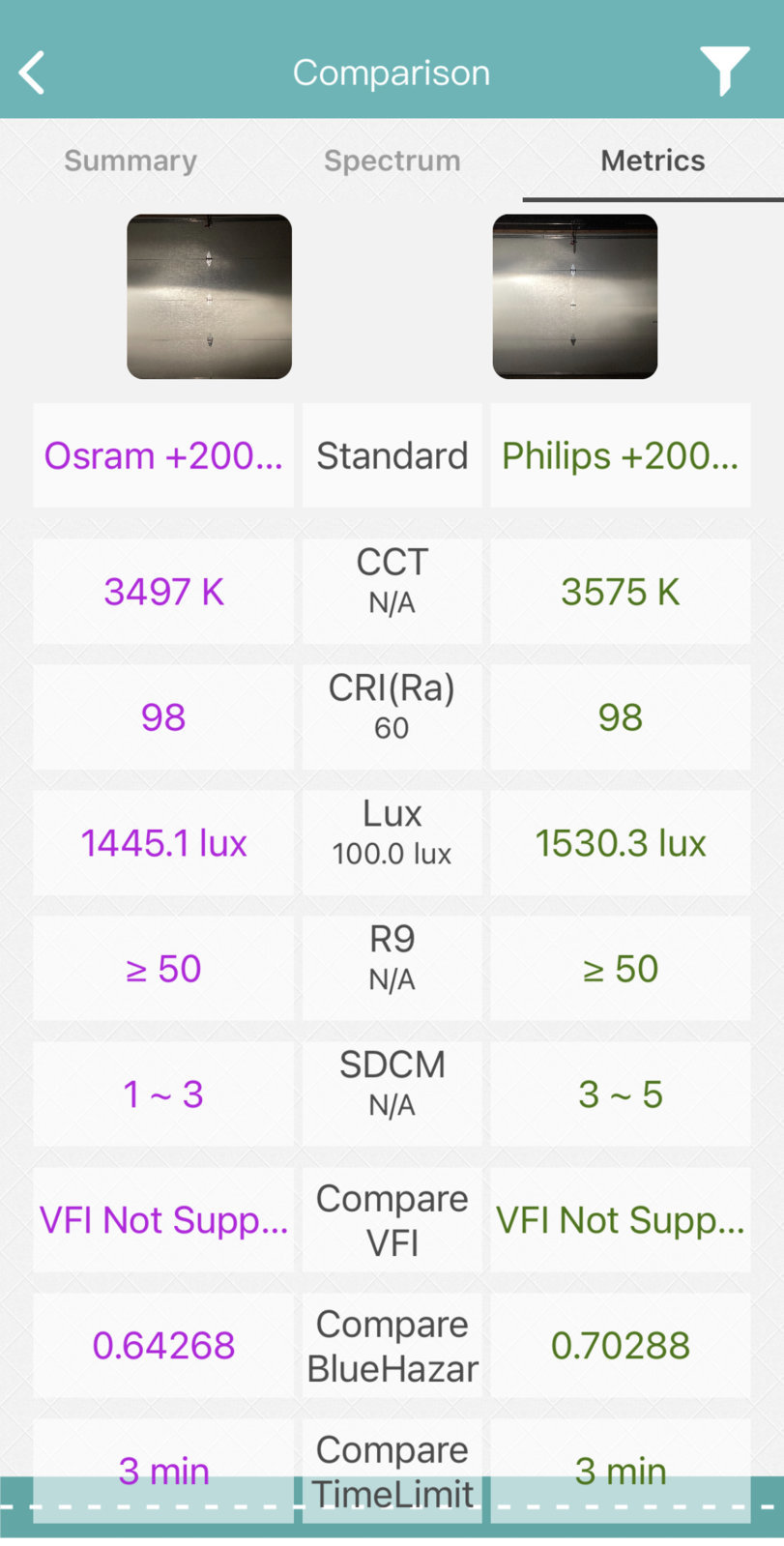

    In the link I posted showing the bulb comparison, there are side-by-side output shots and color temp measurements. The bulbs are just slightly whiter than stock, a stock halogen is about 3200k.
    Toshiba vs Korean Sylavania 9011s. CCT is color temp.
    I was actually thinking of the Philips +150 Racing Vision tested in the 2nd Gen thread. It was the highest performing stock wattage bulb. But these are the +150 Pros, I've tried them in projectors but not reflectors and I have not tried these Philips HIRs specifically to see how they perform. The different focusing technologies lead to different performance characteristics depending on the bulb. To see if they have a performance enhancing HIR coating, the bulb should have a very faint but visually noticeable iridescent coating on the glass. Need to inspect them in-person.
    If you have a 05-11 Tacoma, options are limited, the 12-15 came with much better and more powerful fogs in an H11 base that have lots of options. In the 05-11 your best bet by far is to replace the lamps with new SAE LED fog assemblies. Lots of good options that will perform far better than those stock fogs.
    I'd recommend taking a look at the Diode Dynamics SS3 sports in selective yellow. If ice is a concern, I'd go with the SS3 Max in selective yellow, which is much higher output and runs hot. Reviews linked at the top. Thread testing and comparing most SAE LED fogs for the Tacoma:
