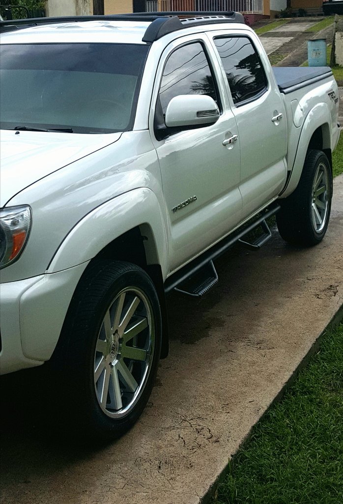

  18. Oct 10, 2017 at 9:52 AM
    #18
    Tacs
    Tacs [OP] Member
    Mar 13, 2016
    #181145
    18
    KURT
    toyota tacoma
    These are my Black Rhino savannah 20" wheels. On some 275/45/20 Maxxis Victra Z4S. No adjustments had to be made. They ride nice.
    ChadsPride likes this.

  20. Oct 10, 2017 at 10:22 AM
    #20
    510tacoguy
    510tacoguy Well-Known Member
    Aug 28, 2017
    #228341
    139
    Eduardo
    2004 4 door tacoma
    Body lift suspension lift
    Those rims are not black :eek:
