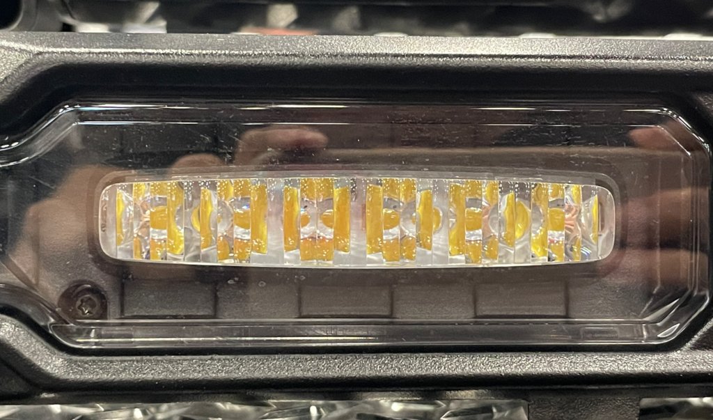

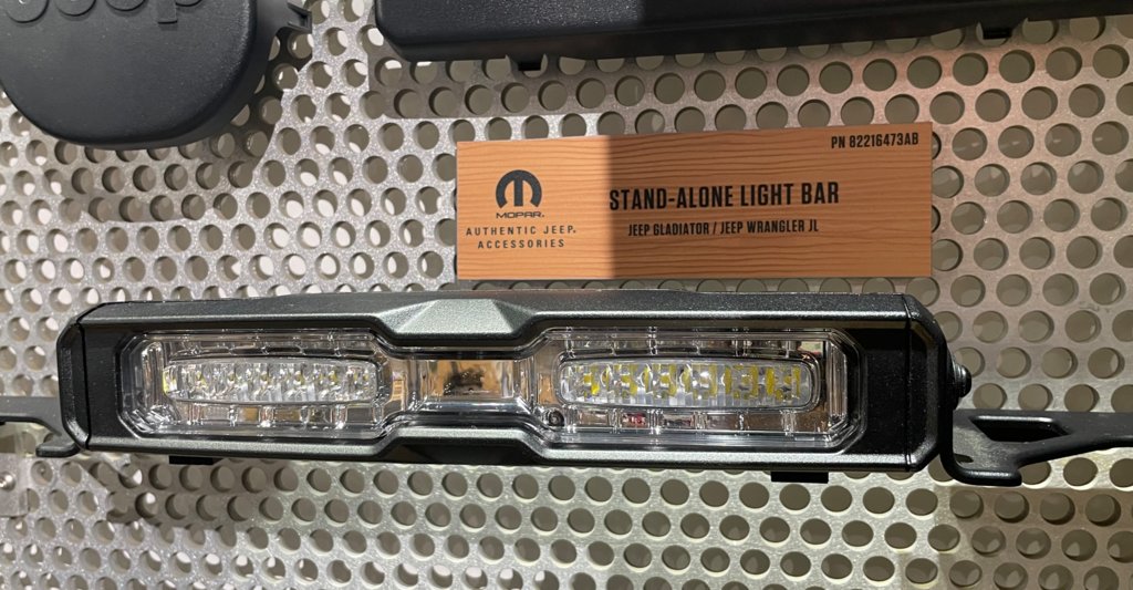

    They are OE supplying to Mopar accessory, optics diffuser pattern indicate this is generic soft oval beam pattern. Typical TIR collimator paired with surface diffuser.
    Similar lens structure as Diode dynamic SS Driving but Tyri diffuse bit larger due to smaller lens ( less focus)

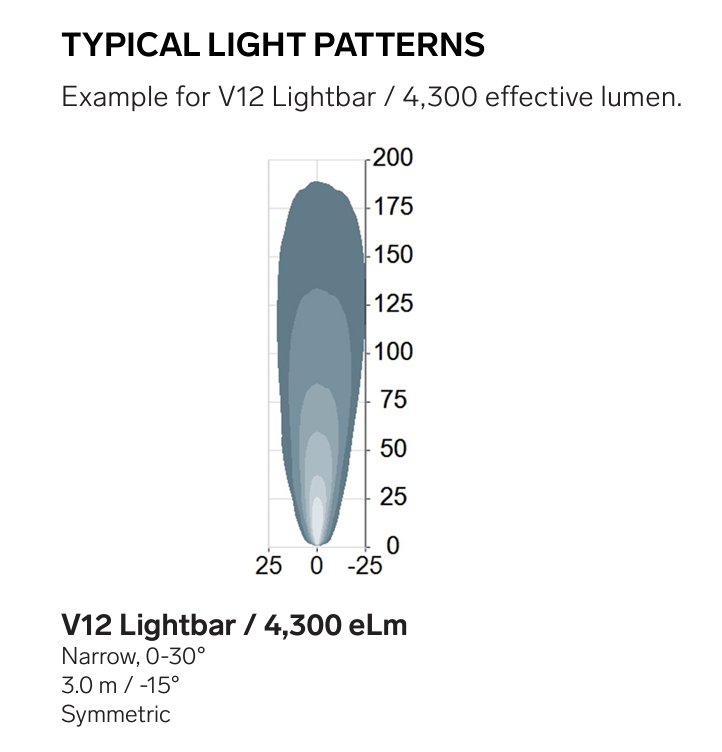

    Their V12 light bar is model being supplied to Mopar.
    EN55025 / CISPR25 class 5 and ECE R10 is good standard. It's petty modest distance reach for its available flux.
