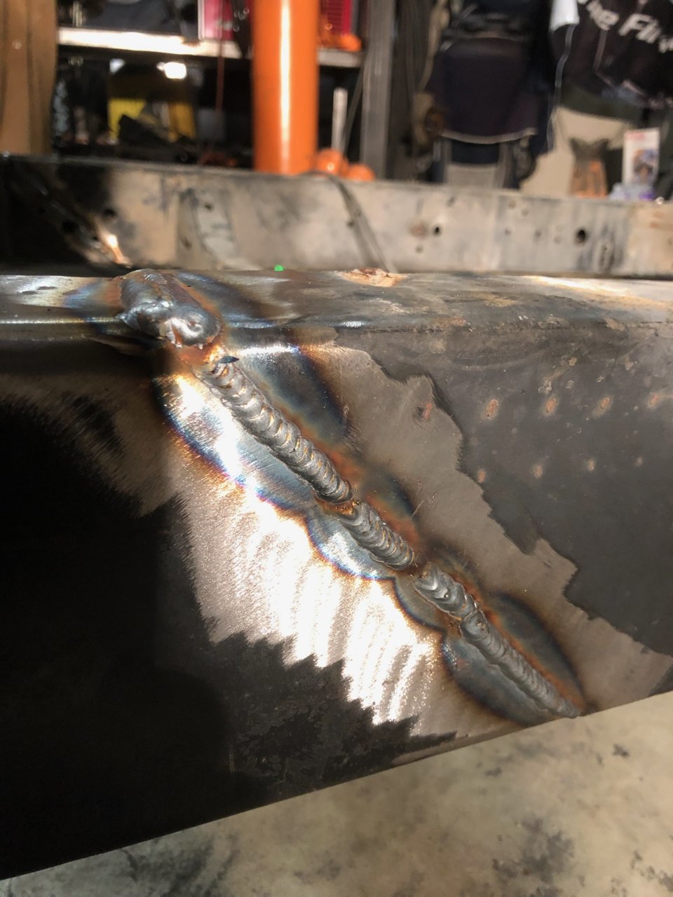

    Oh no, I have an fj80 front strait axle that I'm 3 linking. If I fabbed IFS I would do a 9" center mount with for max travel. Also I should say that the reason I cut the frame off is because I cracked the LCA mounts behind the rack n pinion. Basically camber was growing and there was no way to get it back. So the logical solution is strait axle lol.

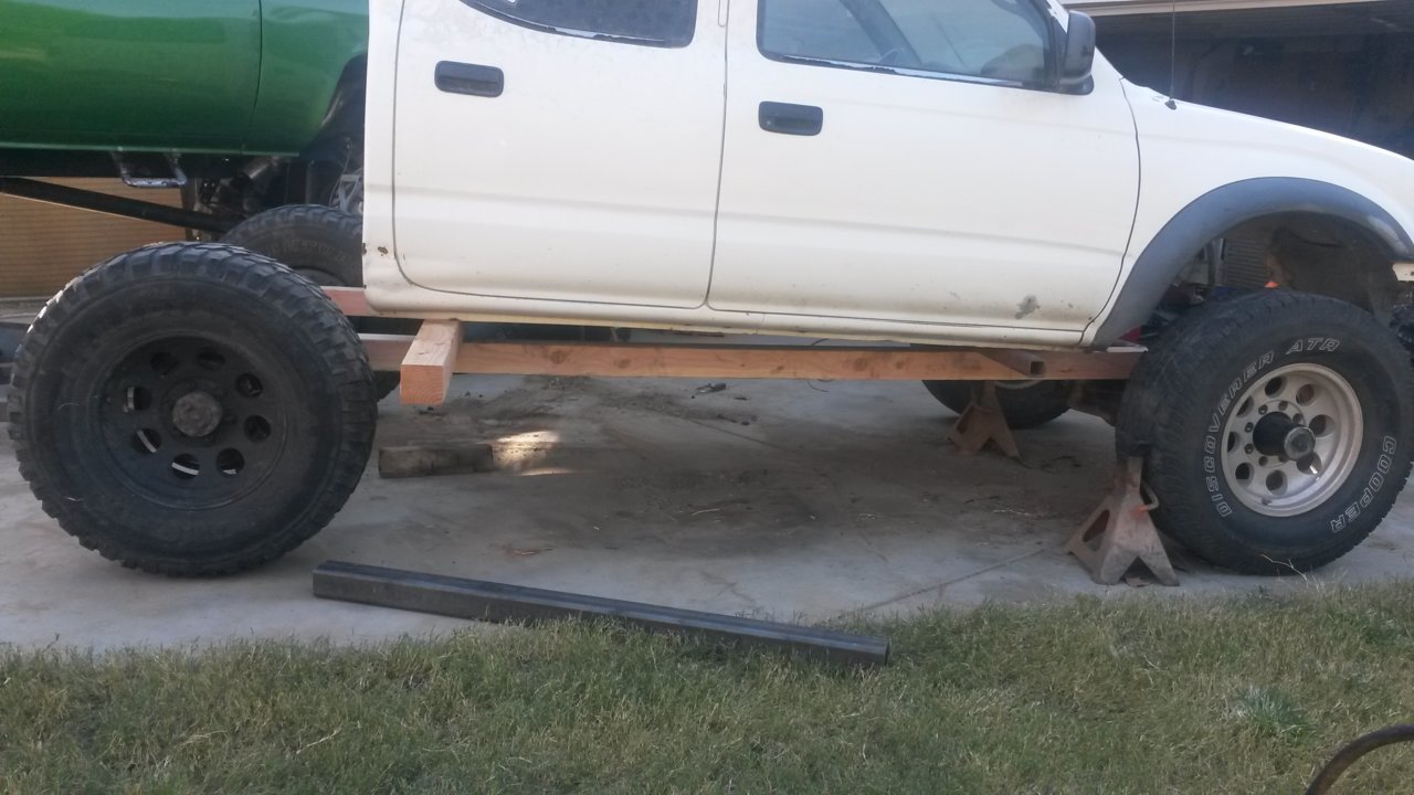

    Fixed it. I was going to LT it but the sub frame was cracked and spreading on both sides.

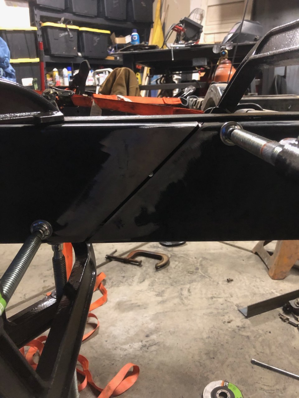

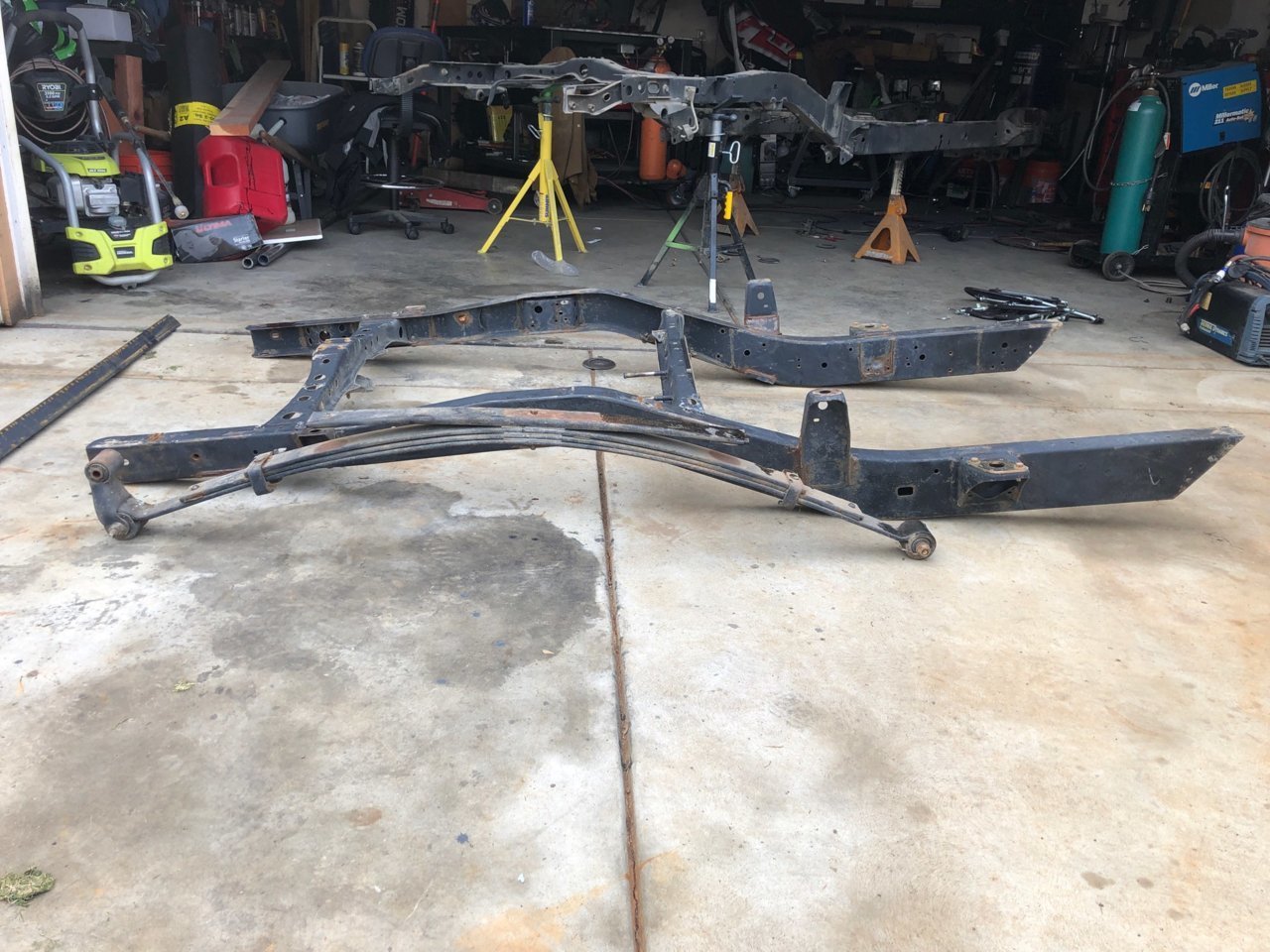

    Also got some upgrades

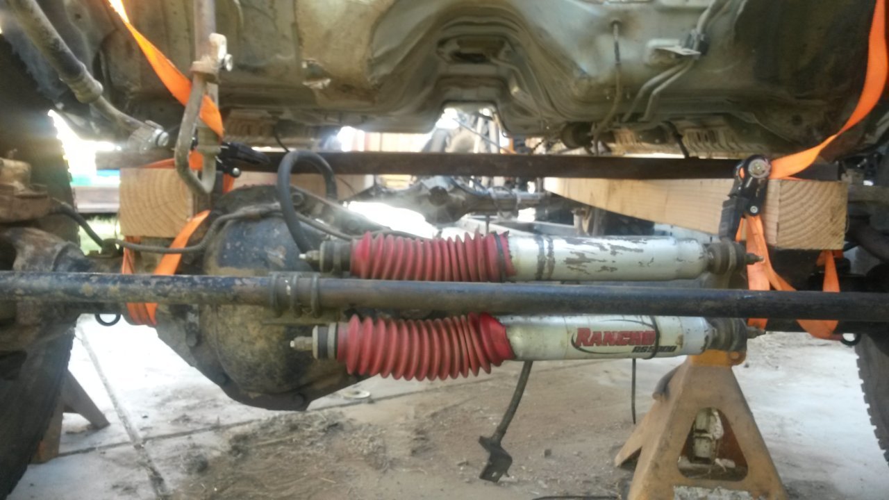

    I thought you were doing and fj80 axle that looks like a dana axle to me.

    I was and that is, I doubt the fjs will hold up to the power I would be throwing at them. Plus I got 1 tons for stupid cheap. The LQ9 I'm putting together should come in around 450 and through a 4L80e that's around 400 to the wheels.

    Tore down waiting for gears and locker

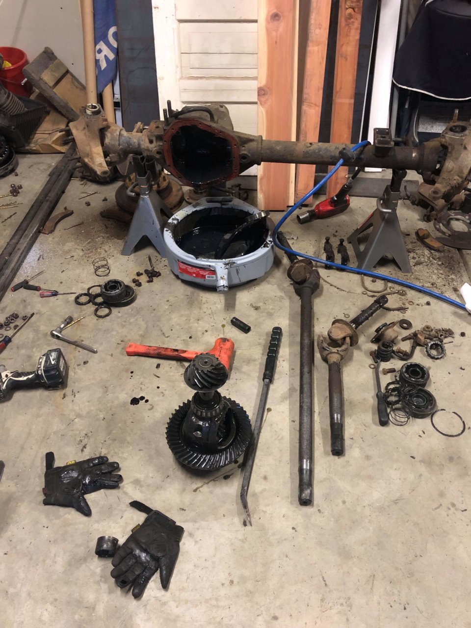

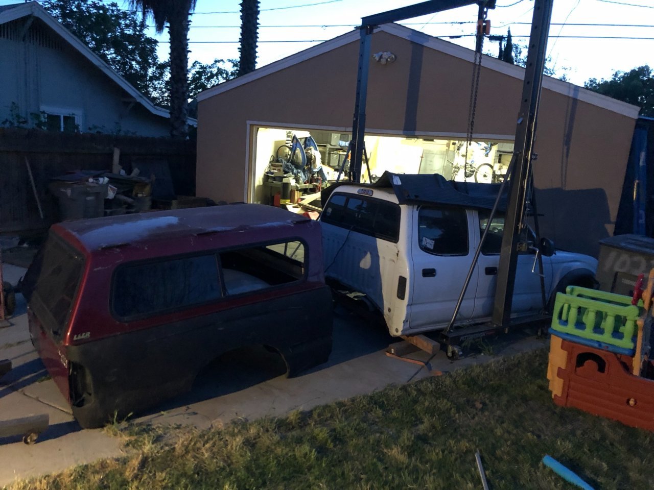

    Also happening...

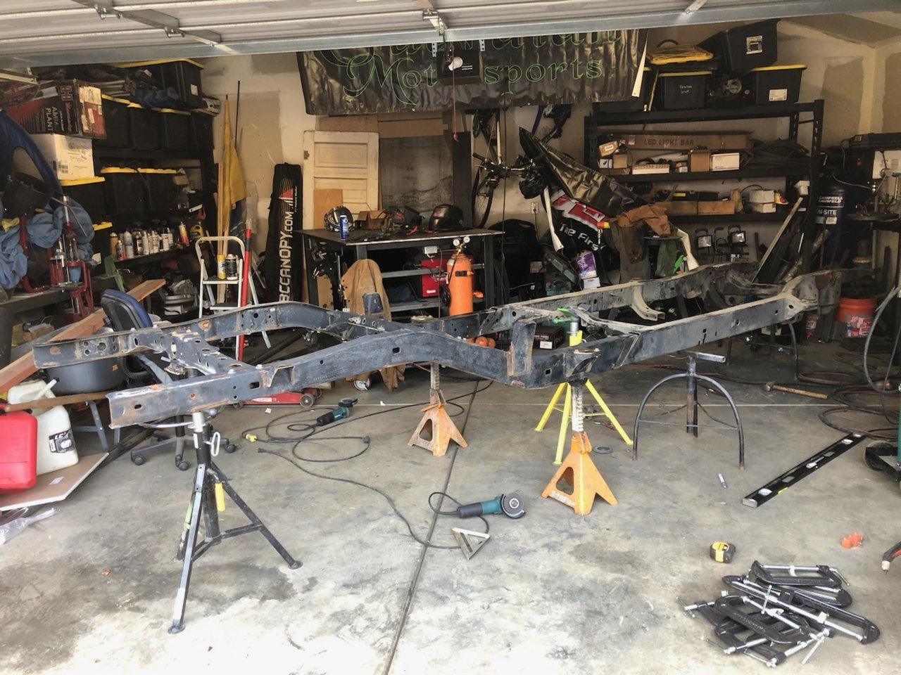

    Got a smokin deal on this bad boy...

    Sectioning frames, bodies sitting on wood in the yard, damn!

    Oh that's nothin... should've seen the 4 truck swap around fiasco lol

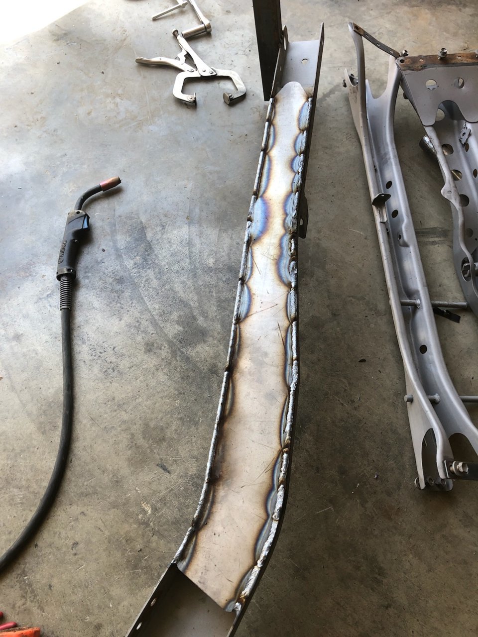

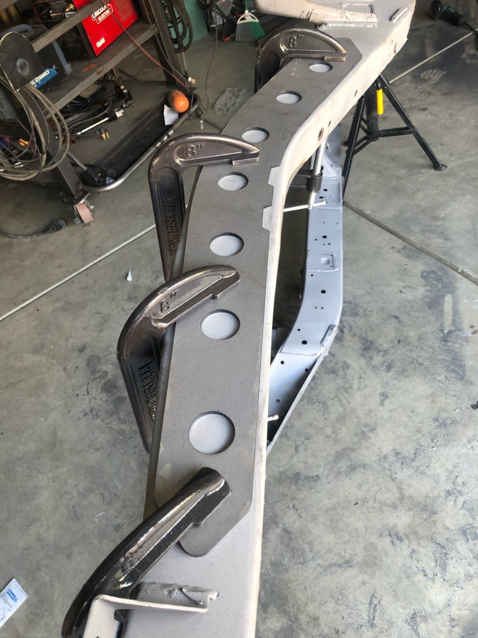

    Staging the body. Hopefully the frame will be done next week.

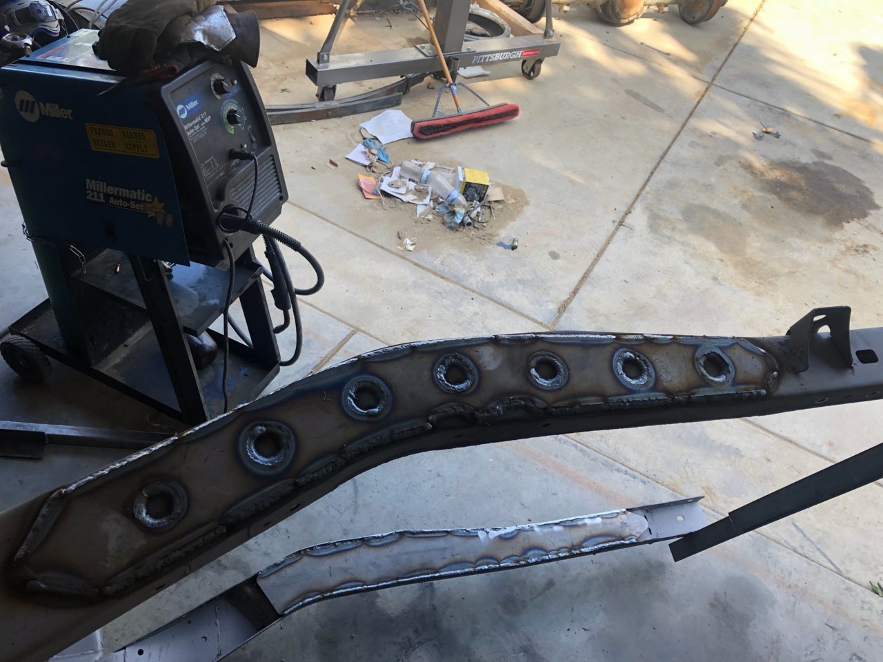

    Getting closer
