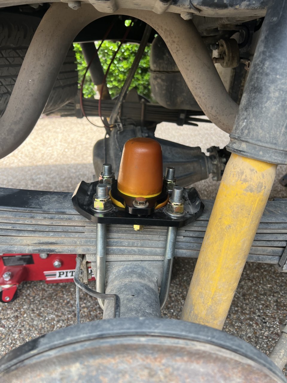

    Archive Garage option 3 in the rear for sure. EFF50FBE-7755-48D8-9D90-11C3EC77C905.jpg

    Did you have to get longer u bolts with the lead pack you’re running?
  20. Dec 15, 2023 at 9:25 PM
    #20
    drizzoh
    drizzoh itsjdmy0
    Jun 29, 2020
    #332922
    2,247
    Andrew
    Arizona
    2021 Tacoma TRD Off-Road 4x4
    They come long enough to fit most, if not all packs. I do replace the u-bolts whenever I remove them though.
