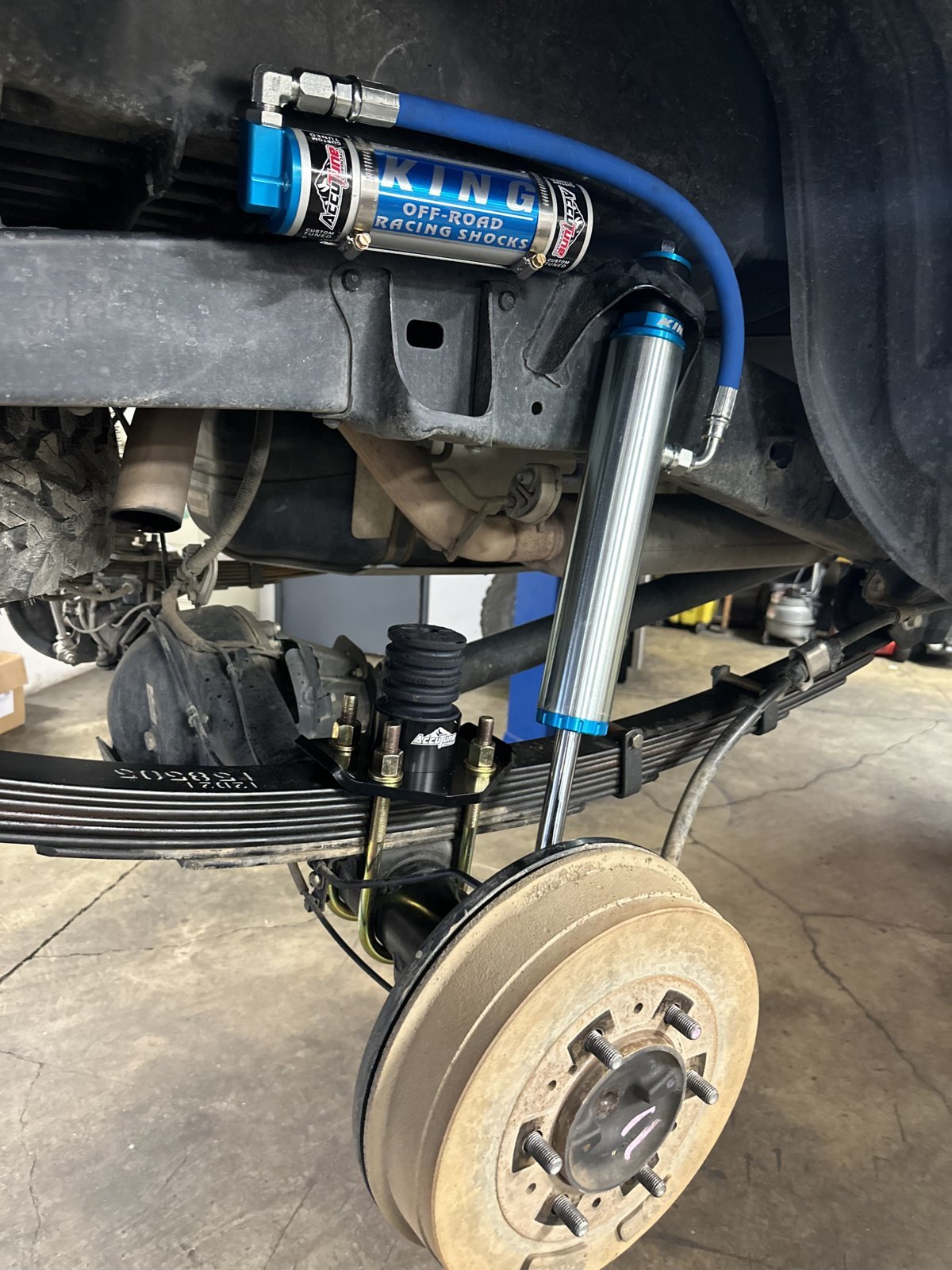

    AccuTune Offroad
    AccuTune Offroad Well-Known Member Vendor
    Jan 28, 2019
    #281012
    1,642
    El Cajon, CA
    Great photo!
    We spent quite a lot of time with our foam bump stop making it just right. Actually, one of our engineers started with a foam block on the lathe in back to get the right amount of grooves. Its softer than most bump stops out there and we have different height spacers to maximize up travel. The shocks should be doing most of the work, but when that bump off-road is too much, the bump stop should not be knocking your teeth out. So far we've had a lot of great feedback from our kits.
    https://youtu.be/okmkrwHm1BI?si=jAMofctfUJ4IgrEW

    What you were told isn't true, at least with the Archive Garage U-bolt flip, thousands of our customers hauling and towing heavy can attest.
    The 1999-2016 Ford Super Duty trucks and 1992-2014 Ford Vans (and many many other vehicles) came from the factory with "Flipped" u-bolt plates and they do some towing occasionally :thumbsup:
    What makes our popular Option 3 kit so good:
    1) soft engagement
    2) max bump travel
    3) slowing weight down over more distance for progressive feel
    4) no center hole in bump to fill up with water
    5) two tough 3/8" bolts to hold our bumpstops down.
    6) High strength steel U-bolt plate 30% stronger than competition
    7) highly corrosion resistant design and powder coating
    (We live with salted Buffalo, NY roads)

    Spec measurements of the bump and flip plate would be helpful. For example, a Durobump flip plate is 3/8" thick and the base rear bump is 3.5", so nearly 4" total. So, a stock leaf unloaded will end up with only 1-1.5" of bump travel, which is basically your rear atop every bump.
    1.5" of leaf spring lift arc increases that Durobump flip bump travel 2.5-3". 3-3.5" is stock bump travel with its 2.5" rear bump stop.
    On my 1.5" lift arc leaf, I have been sawing down my Durobump rubber to match up my 15.2" compressed length shocks better. The bumps can't be cut much from the bottom to shorten them.
    Maybe Archive or Accutune is softer/shorter, but be sure to maintain your bump travel space when you have a low lift arc leaf.
    Durobump fronts have a great cushion travel and rebound however.
