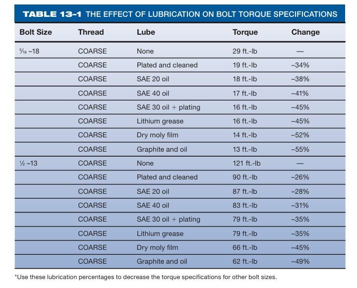

    What grade (looks like it's a choice between 5 and 8) u bolt do you recommend and is it best to lubricate the threads with something prior to install? If so how much would you change the 90 ft lb torque value for a wet vs dry torque?

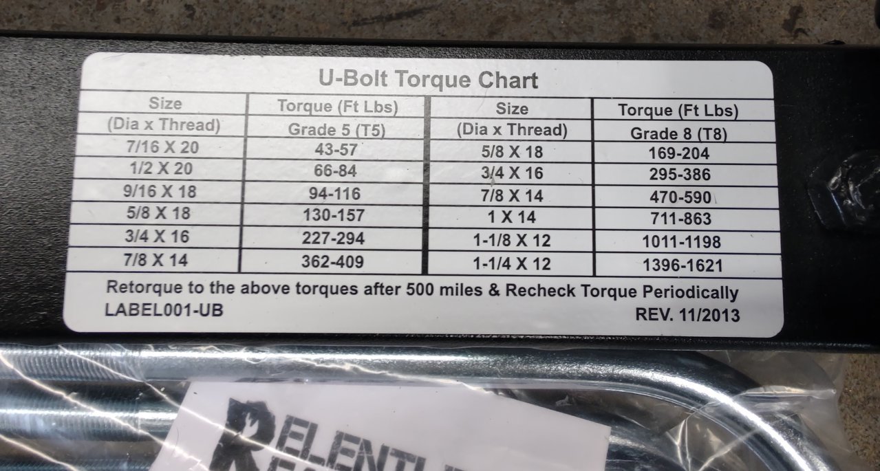

    Deaver Stage Two leaf pack sticker with ubolt torque spec per the size of the ubolt.
    6 gearT444E and Dalandser like this.

    thought this might be of general interest
