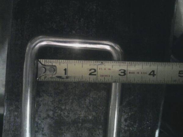

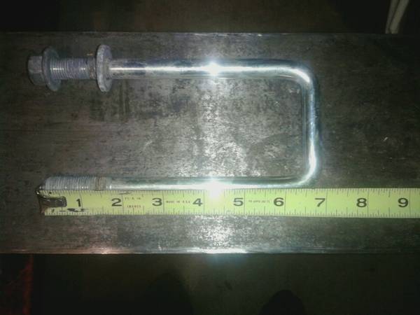

    generally, replacement U bolts are very long, and are a "Cut to fit" type. However, 1/2" longer than stock is good for an AAL. The most important measurement is the width. IIRC, they are 2 7/8" wide.......

    We have a winner !

    Thanks so much man, I really appreciate it!
