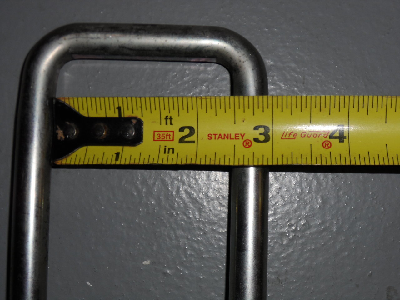

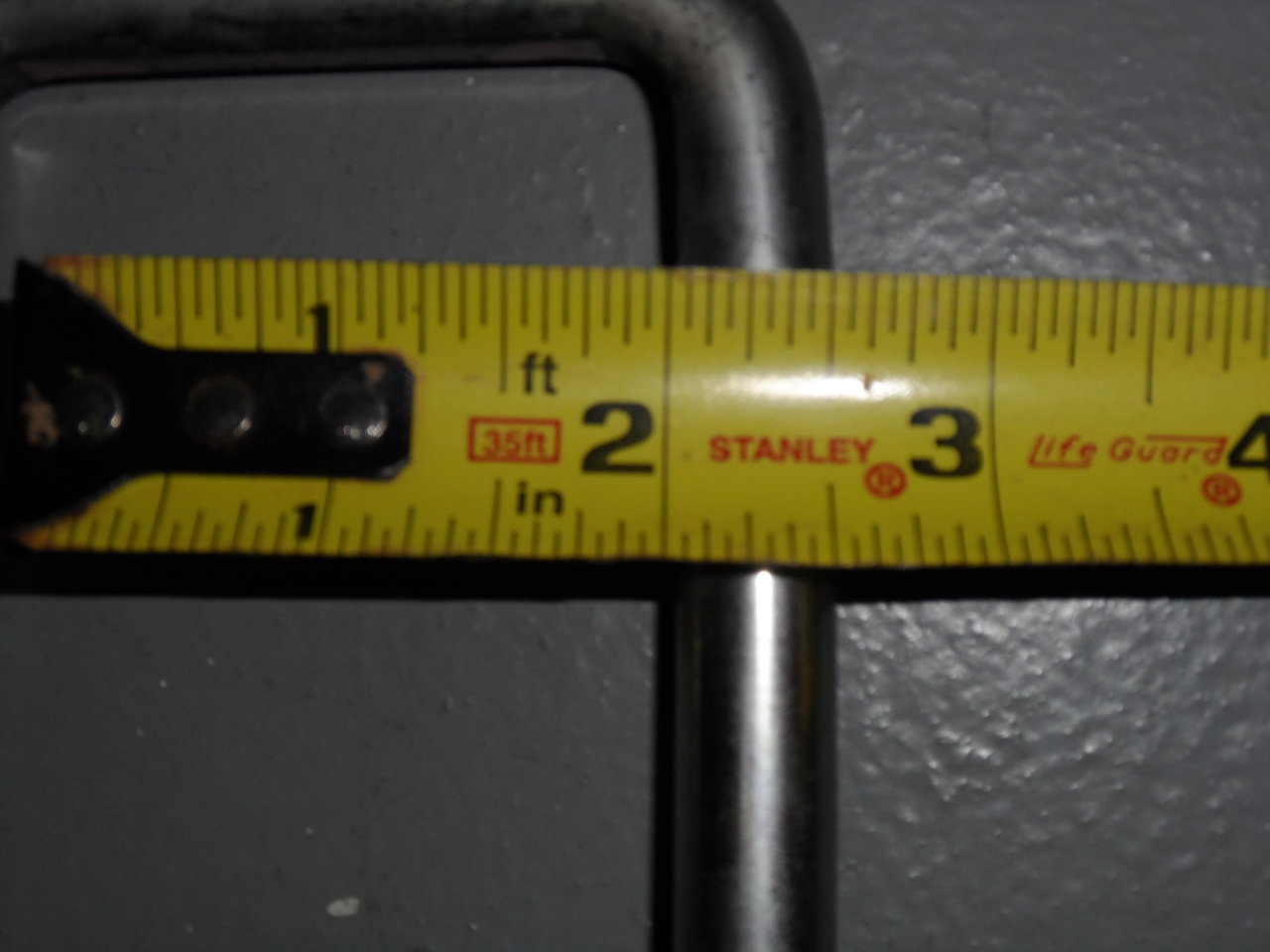

    Just measured a set I have off of a OR model, they are 2 1/2" wide (inside diameter) and 1/2" thickness of the U Bolt

    Here's a couple pics

    Are these OEM?

    Yes, off a 2014 TRD Off Road Double Cab
