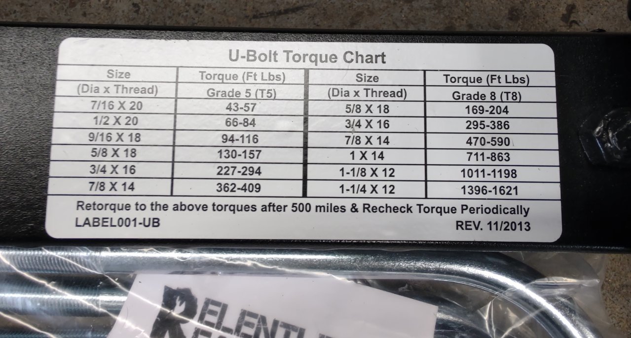

    Yes, I know there’s probably a thread on this and I can’t find it. Sorry!
    Got some super bumps to pick up tomorrow. What are the torque specs on factory rear U-bolts, please?
    Saving for AAL and 5100s down the line in a year-for now I need to give these SAD leaf springs some cheap assistance..
    ‘23 v6 dcsb 4x4 SR
    Thanks,

    I torque mine to 74ft lbs

    Per Deaver
