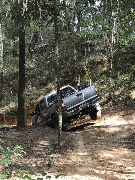

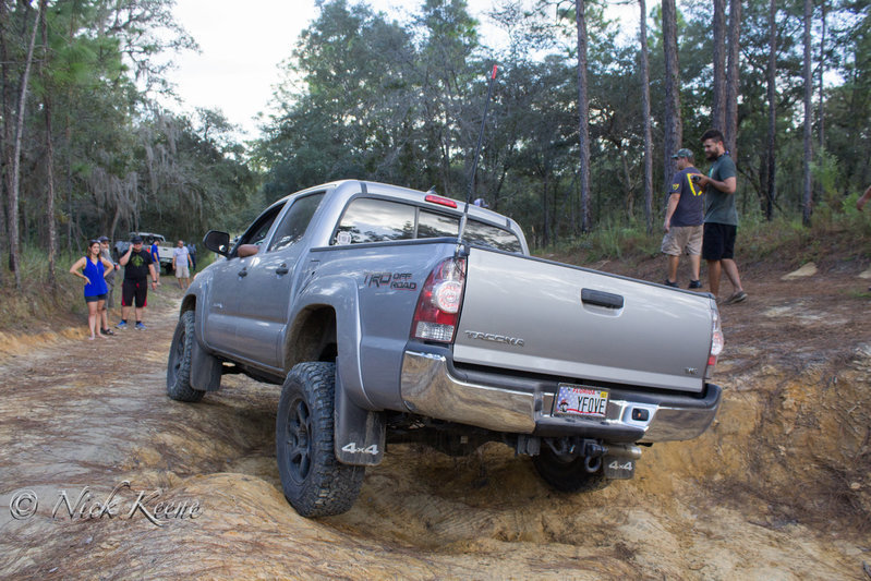

    I had this same problem with installing the tundra U bolts which are the same but a hair longer, I scratched that and I actually used the stock tacoma ones instead with plenty of thread left on the outside with no issue. I have a procomp AAL as well. Used the crap out of them this weekend with no issue downloadfile-7.jpg downloadfile-4.jpg
