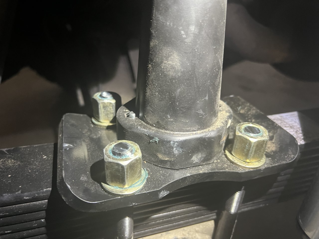

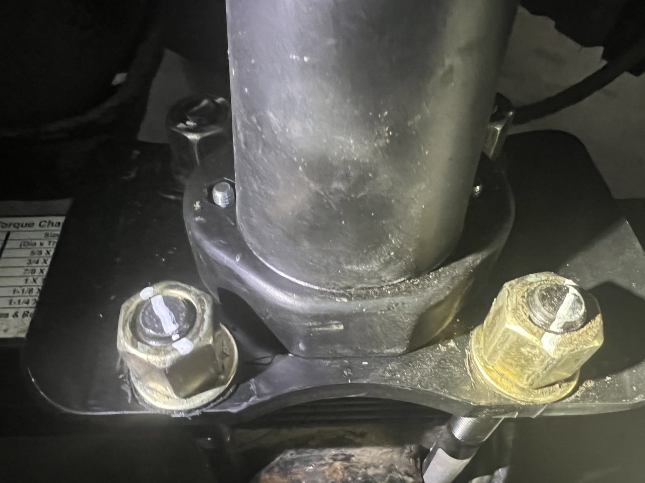

    Recently installed Deaver Stage II springs and DuroBumps 4.25” bump stops with the U-bolt flip kit.
    I can only get this many threads showing on my U bolts and it was a bitch to torque down to 90 ft lbs.
    What do you guys think? Does this seem right?

    I’d like a few more threads showing. Replace with longer u-bolts or leave it and keep an eye on it.

    I do plan to keep an eye on them. I still have to retorque at 500 miles. I don’t mind buying new U bolts but I would hate to buy them if it’s truly not necessary.
    On each side of the axle I have 3 bolts with maybe 1-2 threads showing and 1 bolt that is flush with the nut.

    If you're curious why most say 3 full turns of thread showing is because the end of a bolt will have a bit of a taper to the threads, meaning those last threads don't allow full engagement in the threads of the nut.

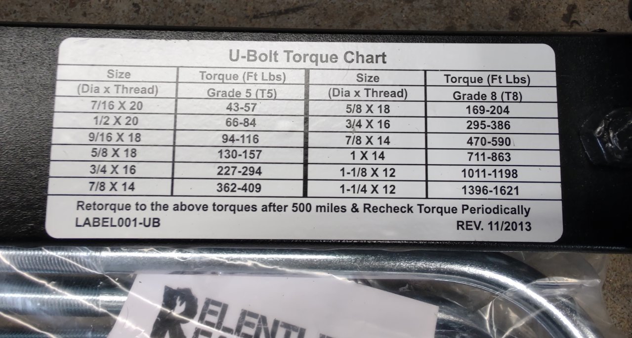

    You are good with thread engagement!
    This is the Deaver sticker on my Stage 2 leaf pack

    When I did the 500 mile re-torque I was surprised how much I had to tighten so you should be able to grab some more exposed thread after doing that. I torqued them myself the in the install so I know they were done proper but it needed more after the break in period from flex. Looks like you have some thread locker on there too so they won't turn themselves loose. Can you retake photos after torquing again to see?

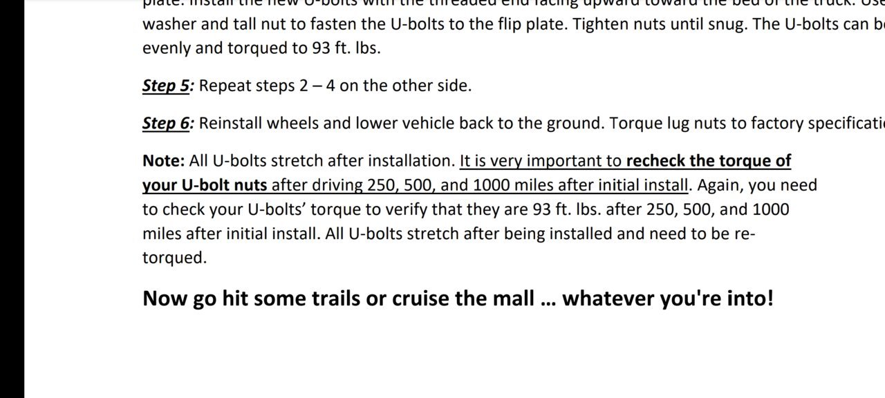

    FYI, the Durobump install instructions specify the torque (93 lbs) and inspection intervals.

    I have this chart on my Deavers. I originally tried going 100 ft-lb but it would not budge, so I went with 90 ft-lbs. On my retorque I might go 95 if it will move.

    Here are the full instructions

    Oh yeah I remember seeing this when I was digging around online. I have a different part number and the nut is larger than 19mm so I disregarded the 93 ft-lb spec.
