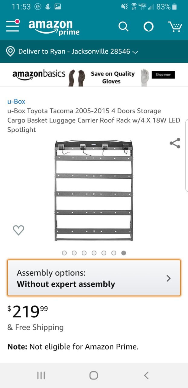

    Wondering if you guys have ever heard of these? I found some one Amazon and seeing if anybody had a review on them? It says up to 2015 however the 3rd gen should be the same exact setup as the 2nd for roof racks so I dont think that would be a problem.

    Very true... was going to put the link but didnt know if I was allowed to and the right after I posted I was like ohhh crap lol.

    That looks like it would make a shit ton of wind noise, and looks like it’s super cheap (China) materials. I’d pass, but just for looks it might be ok. I bet it will rust like a mofo within a year.

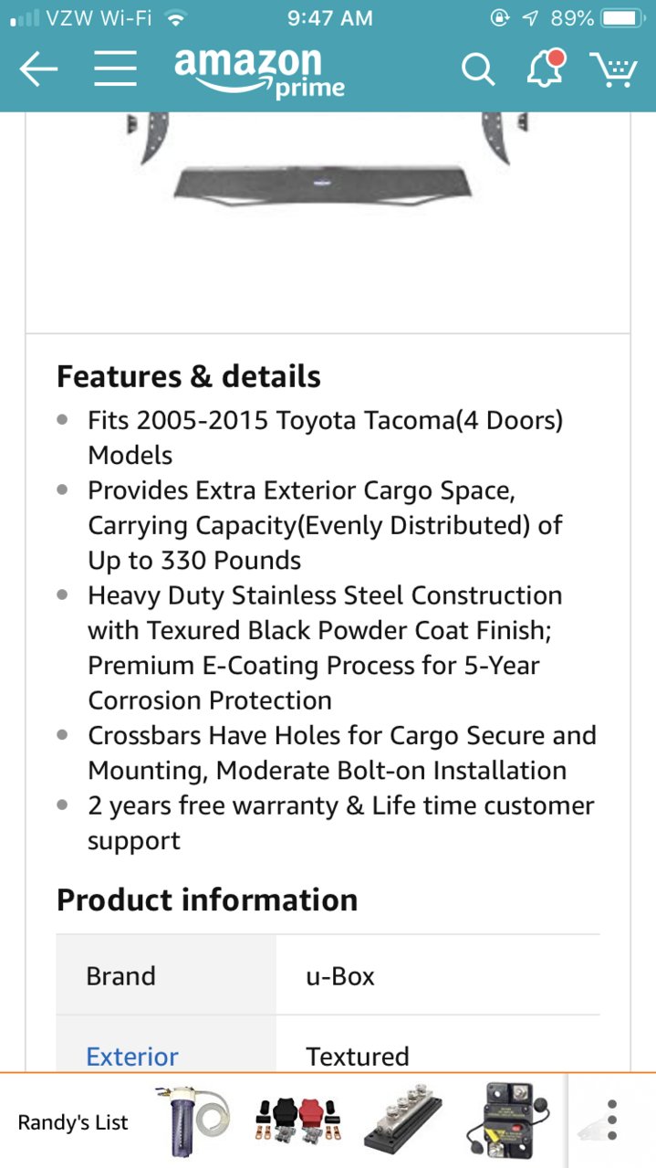

    looks like it might be steel not SS, see more product details on Amazon site. hard to believe SS and powder coat for that price.

    Says right here SS. Probably just the lower grade SS

    see more product details "Durable Steel Construction. This roof rack is built from heavy-duty steel to ensure maximum durability against heavy loads. It is coated with a durable black powder coating to ensure lasting protection against corrosion."
    will be interested to see which it is.

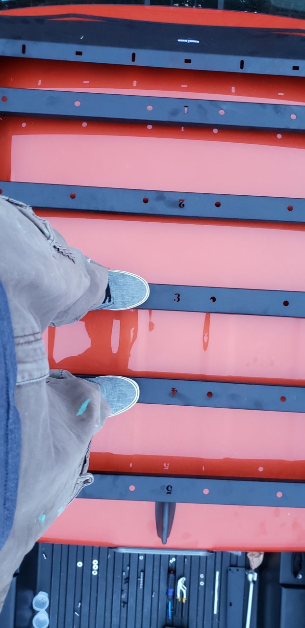

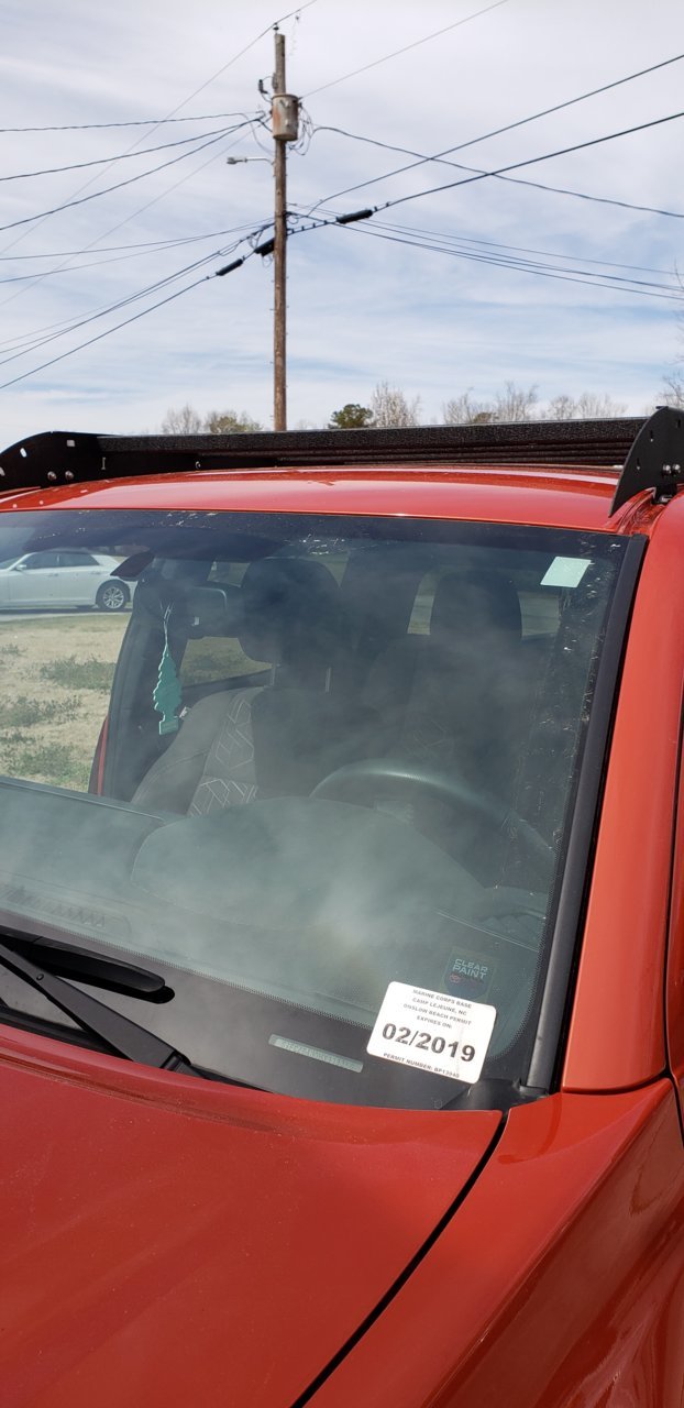

    So... bunch of problems with this thing. Here is the bad:
    None of the hardware fit on the truck itself. The screws were too long and improper threading on them. I ended up using different bolts to be able to attach the roof rack to the truck.
    The hardware is cheap, do not tighten to much or you are going to strip the bolts. They are also a weird size, both metric and standard would slip on them.
    The roof rack came with some paint stripped off, but it looked like it was not even painted on from factory because it was a straight line on some of the bottom parts.
    The front wing shakes, like I am saying shakes the whole truck shakes. At around 45 the truck started shaking violently and scared the crap out of me. I took it off and we welded a plat on the back of it, at 55 it now shakes like crazy. We now have it off and found out right where it shakes it (the little v cutouts). We are going to weld a plate to the back of it and paint it orange like my truck. I think that will look good and those V cut outs should not shake anymore
    Has some bad wind noise around 45 and up, I can deal with it, however it is something that you may want to think about. I hope when we weld the V cutouts it will reduce wind noise, however that part is going to take a minute for my friend to do it.
    It does not clean the antenna (not even close), I am thinking about putting spacers on the back to extend the back out past the antenna or just getting rid of the back piece, right now the back piece is not on it.
    The good:
    It is strong, after I got the proper hardware for the truck the thing is very strong, I can shake the whole truck with it, stand on top of it, and everything else. It is a heavy beast, and everything does line up correctly.
    It is a roof rack and it is cheap, I know the above tells about the problems however if you can handle all of that stuff it is a lot cheap than many other racks like it out there.
    I will updated with pictures soon (once we get the front air splitter on it) and show everybody how it looks on the truck (it really does look good on the truck even without the front air splitter on it).

    So the hardware I used was actually motorcycle fairing bolts that I still from a while back. They are stainless steel and they fit perfectly. Here are some pictures but still doing the welding and painting.20190317_150515.jpg 20190316_191837.jpg
