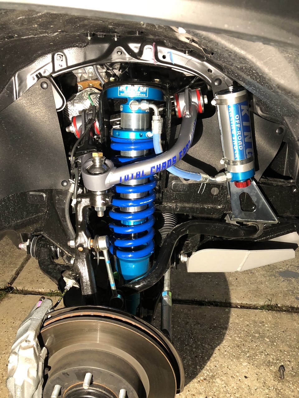

    Pretty much safe with any option, the real choice is uniball or balljoint. I myself am going with total chaos

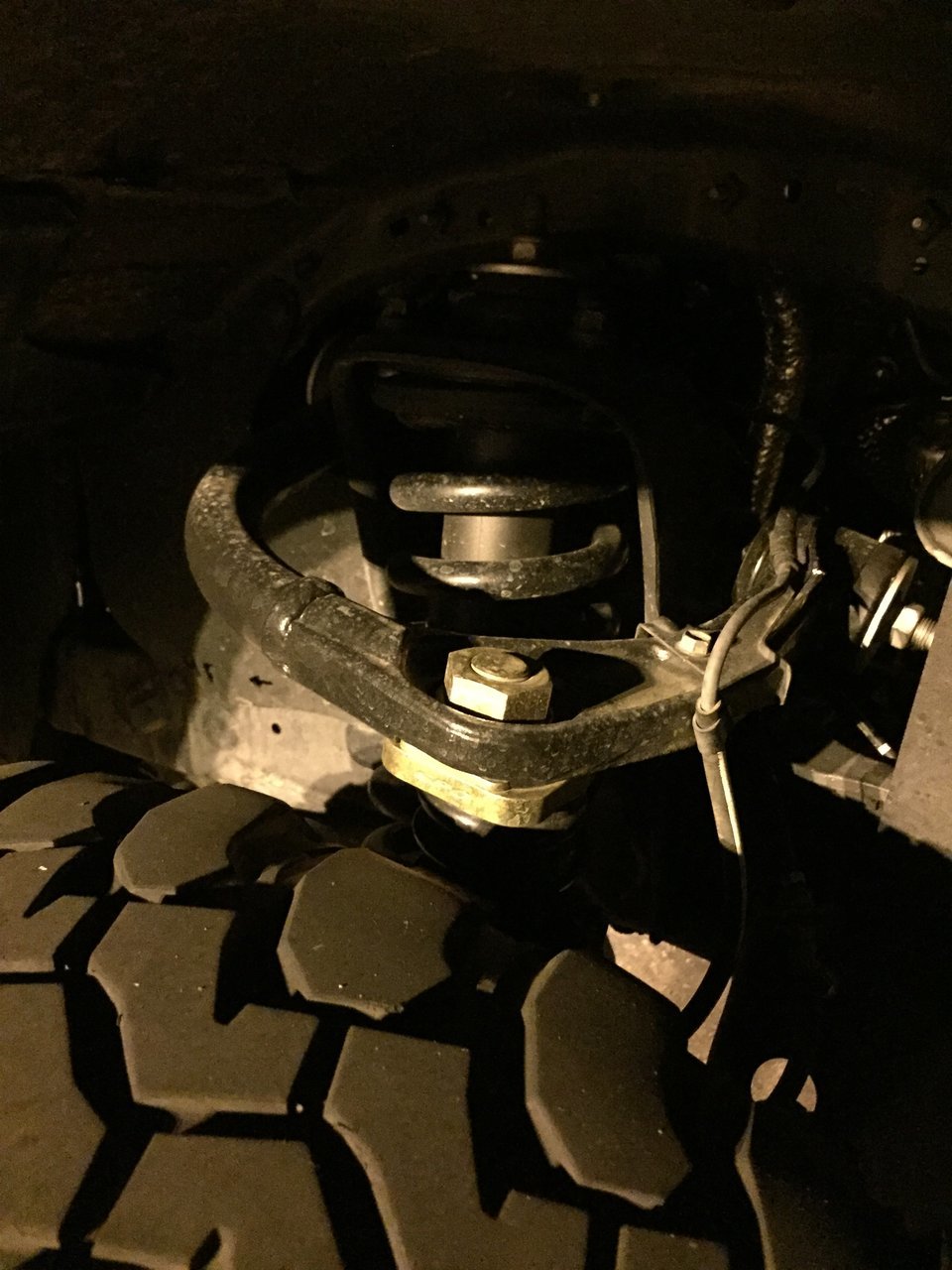

    I second this vote. For 99% of tacoma drivers wanting aftermarket UCAs, these are the best option. They're the least expensive, the ball joint is off a 1 ton truck IIRC and can be swapped in the driveway, and the bushings are OEM so they will last a long time with no maintenance. They'll get you all the caster you will need.
    Obligatory pic of my mcdonalds set up
