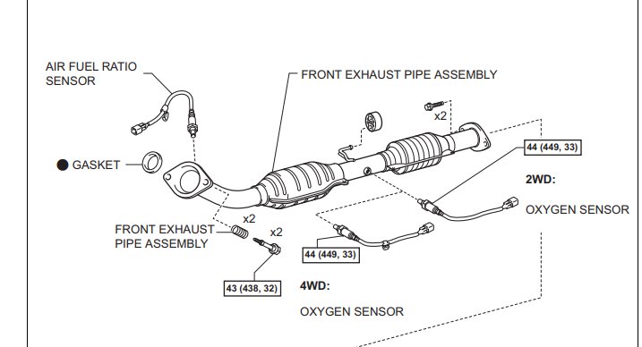

    That further points to the converter, again the only way to know for sure is to test.
    You may check with the dealer, there was a Special Service Campaign to replace the converter on 2010-2014 Tacoma's with the 2.7L so you may be able to get it fixed for free.

    Gsatterw[QUOTED][OP] likes this.
