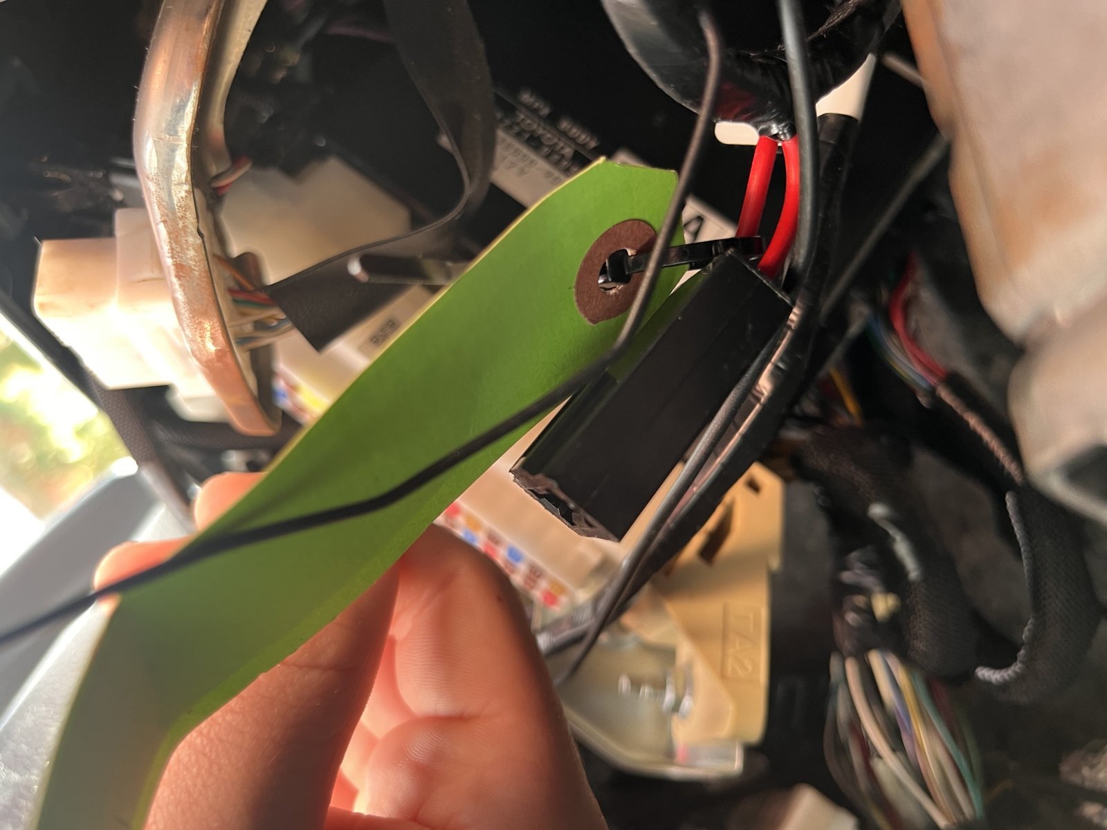

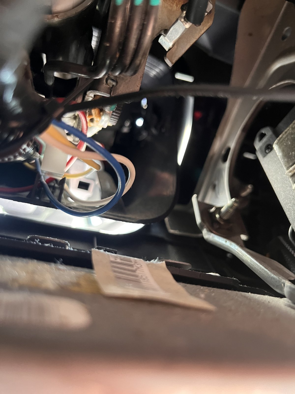

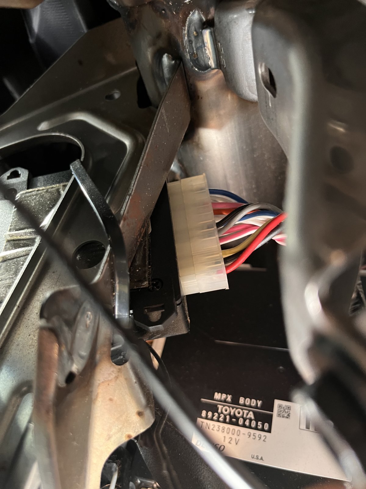

    Hey all, updating with some pictures. The first picture is the fuse that I am trying to identify . The second is the harness that it goes into, and the 3rd and the wires that seem to be running from the steering wheel area (blue, white, yellow)…. Maybe this is a aftermarket remote start ? FB7A303A-0A65-4B4B-8034-E3C2F8672AF3.jpg8D72E230-F0B1-4292-9CE1-BAA840DB31EF.jpg9C2DD405-4D49-40D3-99D0-2FE15939E606.jpg

    looks aftermarket for sure!

    that's an aftermarket fuse holder, and the module is also definitely aftermarket. would need to get model numbers off the module, and enter them into google to figure out what it is.
    but it's likely some sort of aftermarket alarm system, that will now need to be removed from the truck...
