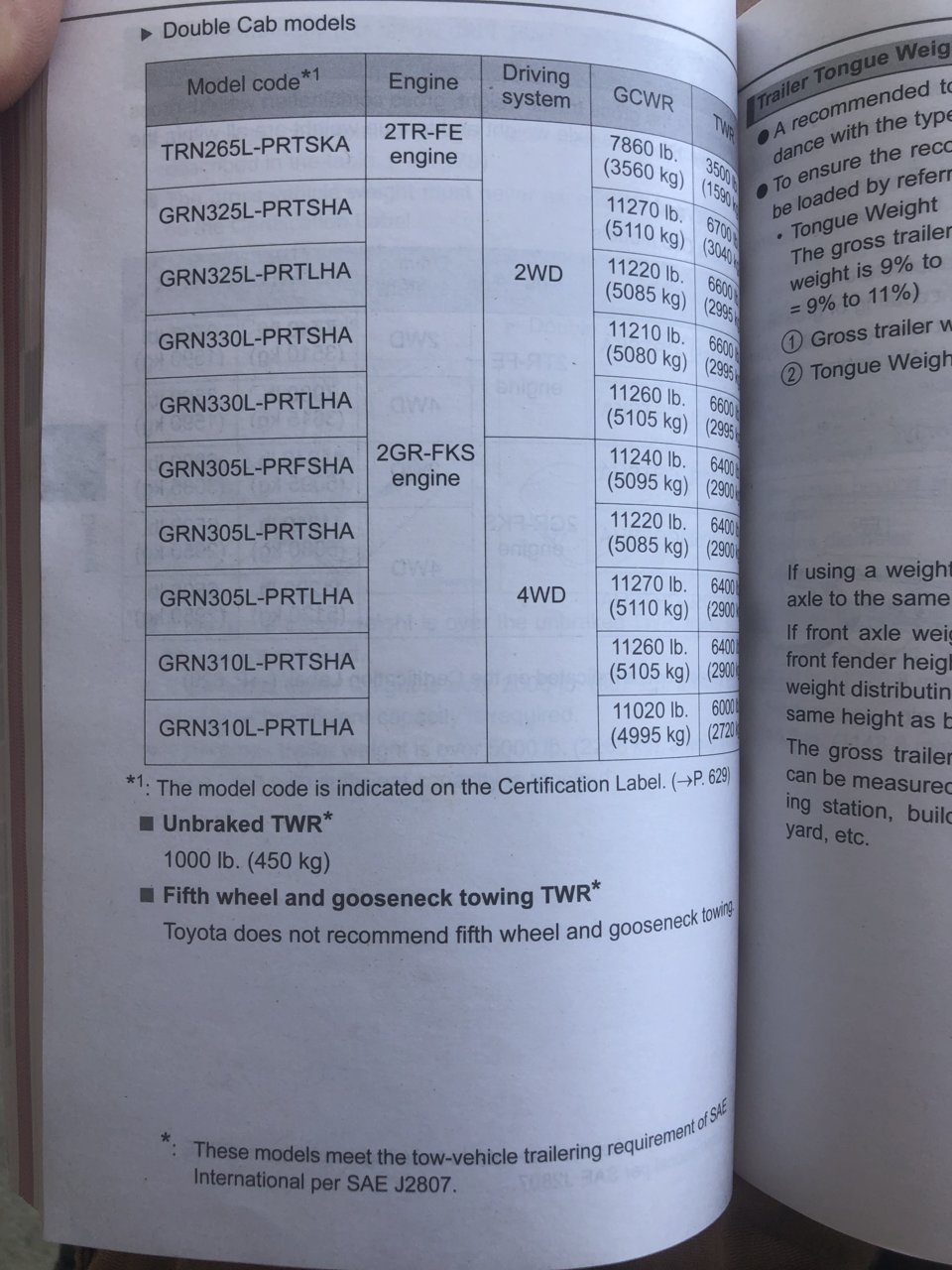

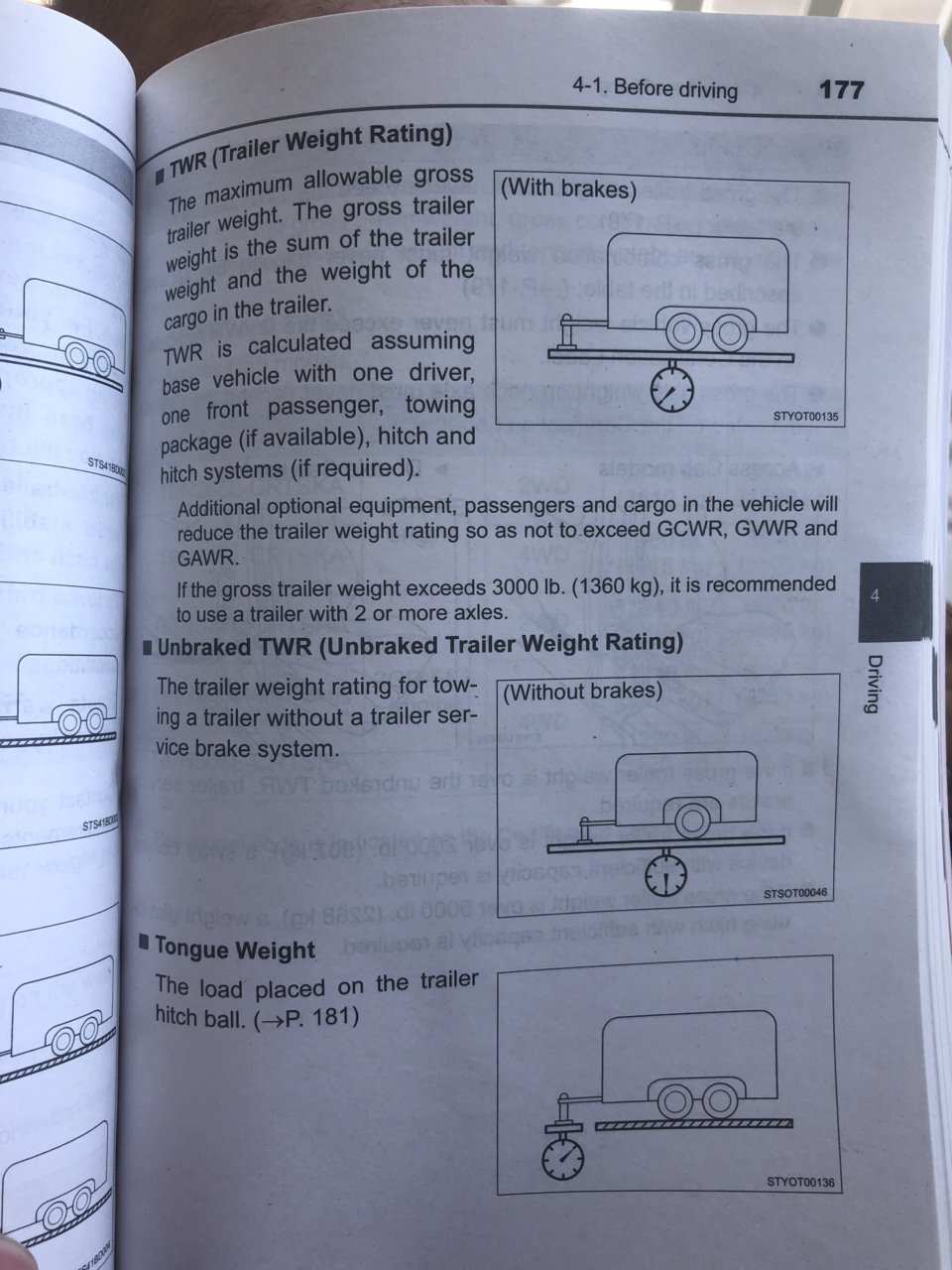

    I’m planning on towing either a 4x8 or 5x8 U-Haul trailer about 1200 miles. They weigh 780 and 900 pounds respectively. The owners manual says maximum unbraked trailer weight is 1000 pounds and both of these trailers do not have any braking system as far as I can tell.
    This would only leave 100-220 pounds for cargo capacity which makes no sense. Is this accurate or am I missing something? I’ve also seen several posts about people towing trailers like these with around 1000 pounds of cargo.
    Also, any general advice on towing these for that distance? I’ve seen varying opinions on driving in s4/s5/not limiting gears at all and ect/no ect. Any additional equipment I should have?
    Access cab V6 4x4

    Yeah, U-Haul website says 1650lbs for the 4x8 and 1800 for the 5x8 when I put in my vehicle info. I was just confused by the owners manual witch states 1000lbs max trailer weight rating for unbraked trailers, which is indicated as the gross trailer weight.

    State laws vary on the weight limit of unbraked trailers. Maybe that is why the 1000.lb limit in the owner's manual.

    Apparently .... Until I can prove otherwise, Yota_Yoda is very correct. Simply Stated There is a difference between "towing capacity" and "breaking Capacity" (Stopping Capacity). Otherwise Stated, Anyone towing a trailer without brakes is limited to Gross weight of 1000 Lbs. So .... Toyota has hidden/buried a limitation within it's specs? Anyone towing even a small single axle trailer without brakes is limited to 1K - or - 1/2 Ton . Disappointing at best - major issue if an accident happens at you are sued for exceeding Vehicle capacity. All the smaller boats w trailers I've pulled (all without trailer brakes) will exceed my Tacoma's TWR rating.
