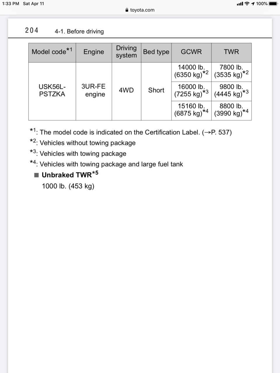

    1,000 - 2,000 lbs. is not uncommon restriction for an unbraked trailer.
    Screenshot from the manual on a 2020 Tundra:
  9. Apr 11, 2020 at 12:18 PM
    #29
    RushT
    RushT Amateur Everythingist
    Dec 10, 2017
    #238171
    5,672
    North Texas
    '18 DCSB TRDOR Inferno
    That’s an impressive differential. Tundra can handle 9,800 lbs trailer, but only 1000 unbraked.
    Canufixit likes this.
