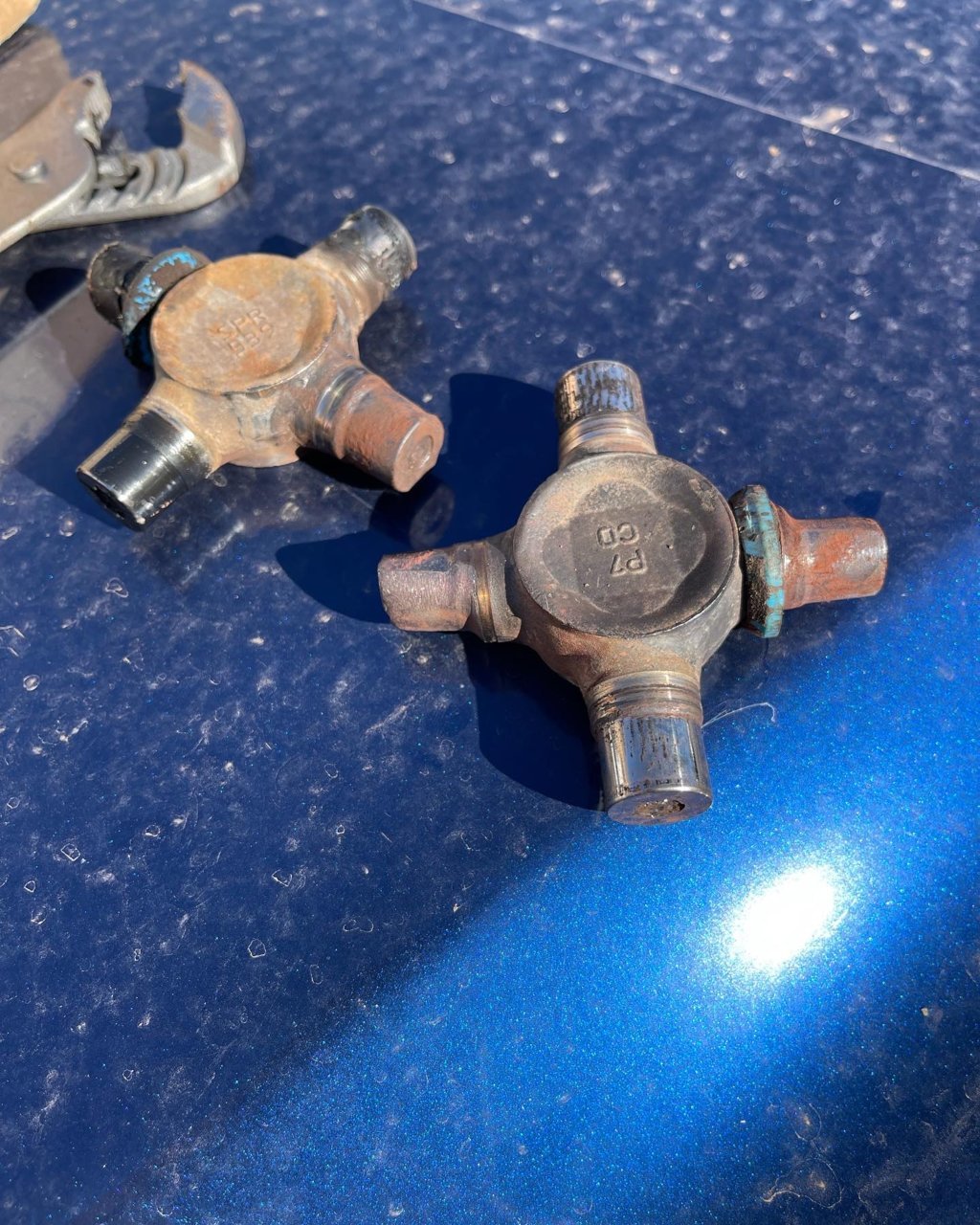

    Well I believe I have determined the reason for the squeaking coming from my drivetrain Classification. Things that should be in one piece that are no longer in one piece.
    All of the grease zirks look suspiciously dry Like when I am getting truck serviced they are not lubing like they say they are.
    Valvoline has some explaining to do. Just has a $100+ full service done 3 k miles ago32272697-D6FB-43FE-ACA6-DDBBB76DAF54.jpg32272697-D6FB-43FE-ACA6-DDBBB76DAF54.jpg 5050139B-9E9B-4AB1-AD0C-ACC3ACFD4F73.jpg32272697-D6FB-43FE-ACA6-DDBBB76DAF54.jpg 5050139B-9E9B-4AB1-AD0C-ACC3ACFD4F73.jpg 32272697-D6FB-43FE-ACA6-DDBBB76DAF54.jpg 5050139B-9E9B-4AB1-AD0C-ACC3ACFD4F73.jpg

    They don’t look to have been greased regularly. If they were, you’ll see grease slung in a line on the bottom of your truck. Mine has a nice black streak. Can’t nobody say I haven’t been greasing mine.
    BTW that first one looks like you have some thing tangled in it? Bailing twine perhaps?

    Its prob the cup coming apart. It has a spring/wire in it if im not mistaken

    IMHO....it looks more like a seal failure.
    Needle bearings will sustain a lot of abuse with minimal lube. Needles are frequently run in 2 cycle engines burning a 50:1 fuel/oil ratio under high speeds.
    The fibers could be the cause of the seal failure. Wrapped around and finally cut the seal.
    Anyhow, doesn't really matter. Needs a new U-joint.

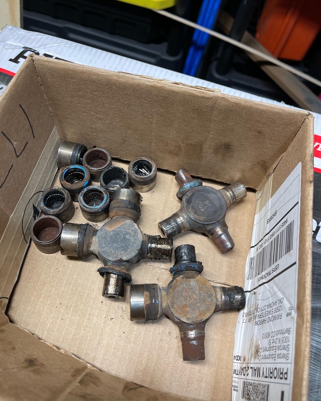

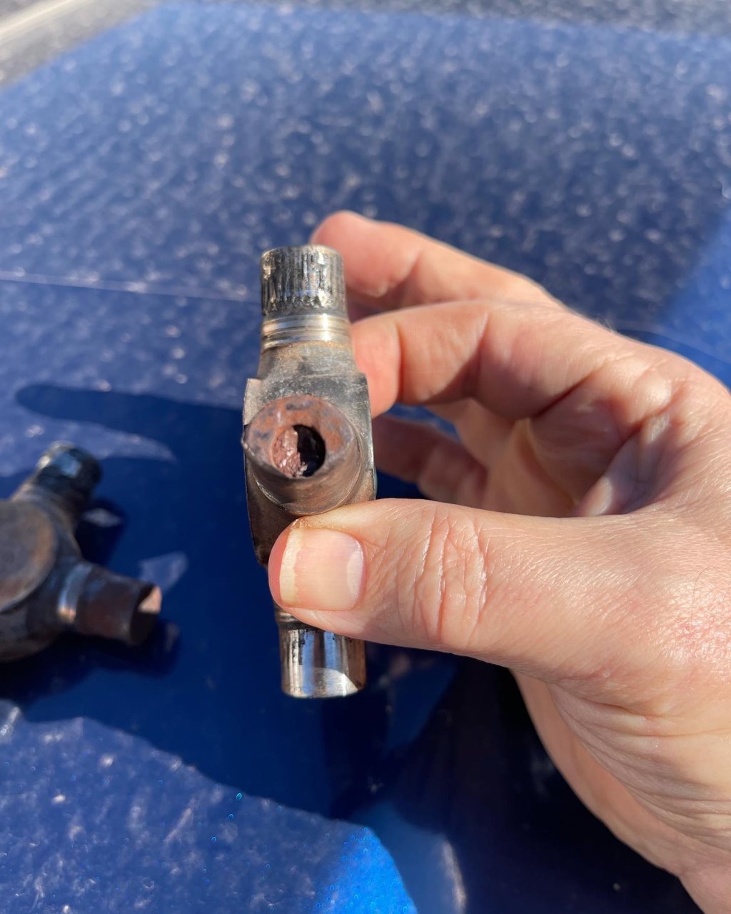

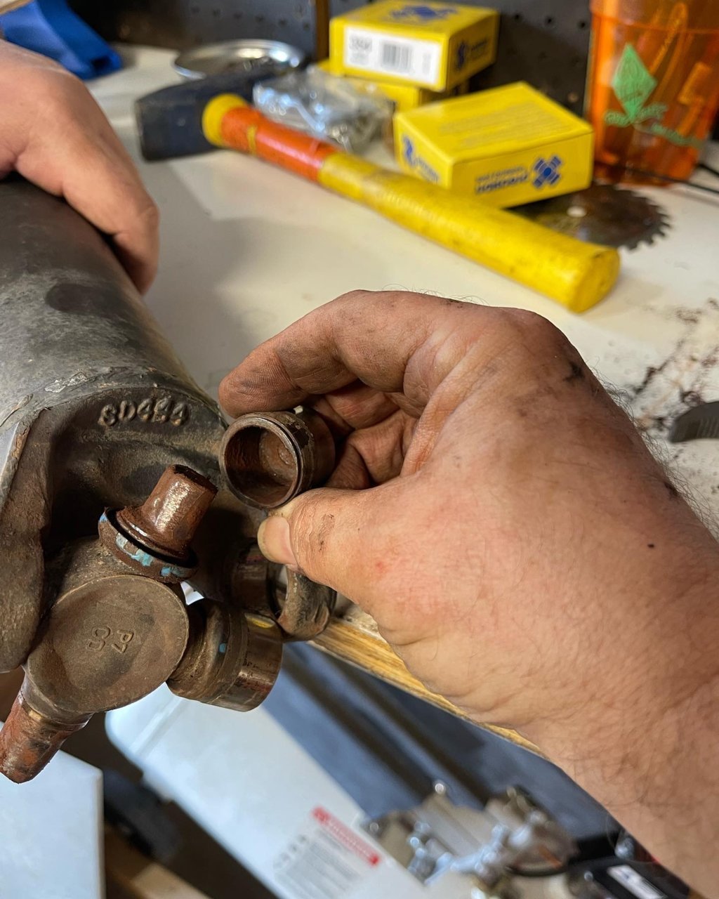

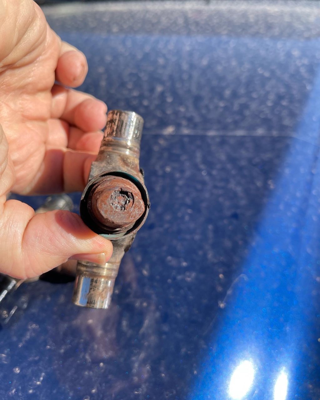

    U-joints, a cautionary tale. Take them seriously. These were really not very noisy. Slight clunk when put into drive , some squeaking. Knew one needed replaced just because I noticed the dust seal was torn up. Did not give it much thought. Was going to get them replaced after first of the year when shop had time because I just didn’t want to mess with it myself. Well flash fwd to yesterday I had the truck up on the ramps get ready to run the wires for my air compressor and 2nd battery system and actually had room under the truck to take a good look at the driveshaft. Grabbed it and twisted… and it moved… A LOT. Both the front and rear joints were shot. So much free play I am amazed they were still attached. Note the pictures of oval and teardrop shaped arms. 5 of the bearing surfaces don’t even show signs of there ever being needle bearings in those caps. Just rust and more rust. I bought the truck at 79k and I have 122 on it now 40k in 1.5 years I have had the “Full service” from Valvoline because I am too old and fat to be dragging my self under the truck. I will be doing it myself from now on for damn sure. I am now however having retrograde heart failure because I drove 2k miles to phoenix and back on those joints just before Christmas. I knew I had issues so I resisted the urge to go off-road out in the desert. Now I am terrified to check out the front u-joints. The back ones took me 7 hours to replace. If you are getting your oil changed at one of these places make sure you insist they actually do a chassis inspection and lubrication

    :eek: Those were BAD
    Good to see you got them replaced.
