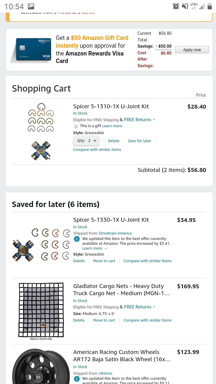

    Have search just about every U joint thread but cant seem to locate the part #'s (spicer?) for the U joint in the front drive shaft.
    Tons of references to the rear ones (3 required) but none for the front..
    Long way probably from needing them but like to have the numbers on hand.
    Thanks in advance...:bowdown:
    And its a 2015 DCLB 4.0 Auto
  7. Apr 6, 2021 at 7:55 PM
    #27
    banditcamp
    banditcamp Well-Known Member
    May 23, 2018
    #254335
    1,835
    daniel
    2015 Super White DCSB Off Road
    Everthing I've read says those are the two different part numbers you need to replace all five u joints.

    Just to verify, these are correct for a 2011 DCSB TRD OR, rear driveshaft? And I'll need 3?
    Amazon says no fit, but sometimes Amazon is a liar.
  9. Apr 7, 2021 at 7:24 AM
    #29
    Derk33
    Derk33 Well-Known Member
    Feb 25, 2016
    #179384
    181
    Derek
    Pennylvania
    22 Army green TRD OR
  10. Apr 7, 2021 at 9:16 AM
    #30
    nd4spdbh
    nd4spdbh Well-Known Member
    Oct 7, 2013
    #114055
    14,599
    SoCal
    13 DCSB TRD OR v6 Auto
    Correct.
