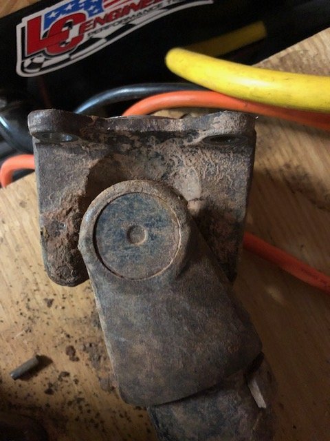

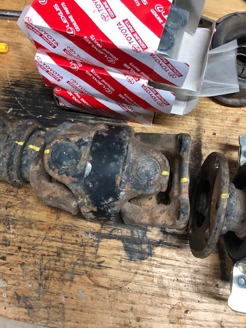

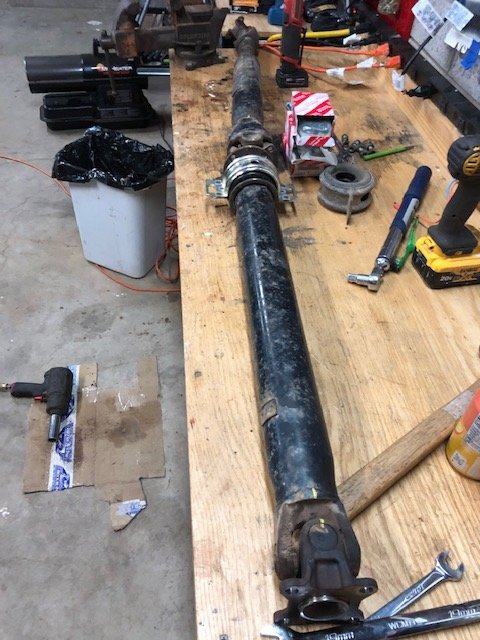

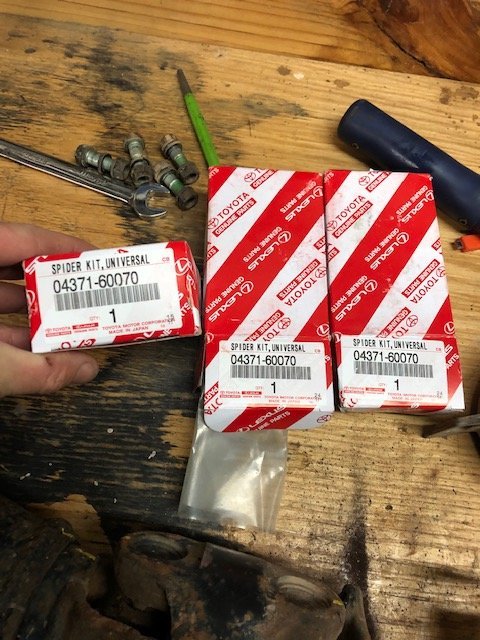

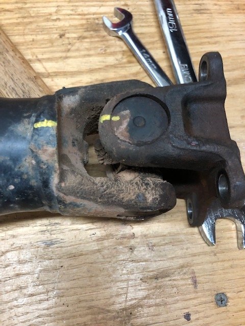

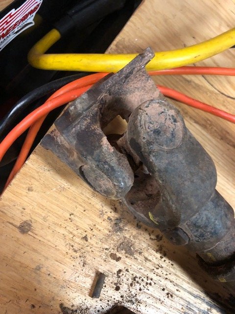

    I had to replace my carrier bearing and decided to change the u joints while I was at it. From my research I thought I needed three 04371-60070 U joints. When I took it all apart it looks like there are four on the main shaft. So I did some more reading and found something about the double cardan? Plus the clips that keep the "spider" piece in the middle u joints are different on the factory ones compared to the OEM Toyota ones I ordered. I searched and watched the you tube video from @Timmah! but I still can't find any concise info on my specific truck which is a 2004 Tacoma, 4x4, SR5, xtra cab that I have owned since 20,000 miles. It has 190,000 on it now and I'm sure the u joints have never been replaced. Can someone point me in the right direction before I tear into this? Thanks.

    I like to use rockauto to look for part numbers, may not order everything there, but it's very helpful

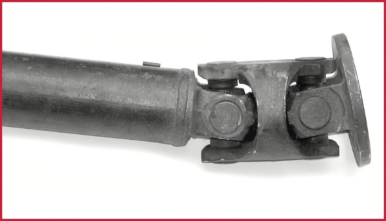

    There's actually a guy on this forum that did a write-up on how to replace the u-joints on the double cardan joint. Toyota does not sell u-joints for the double cardan joint. If those go bad, Toyota considers it a throw-away. For the double cardan joint, you have the two u-joint and a center ball. It doesn't look like an easy job at all.
    Before you get into all of this, have you confirmed that any of your u-joints are bad? Have you checked them for play by pushing and pulling on the shaft? U-joints can last a very long time if they are taken care of and lubricated on a regular basis. There's a very good chance you don't need to dive into any of this saving yourself time, money and the headache.
    If one of my double cardan joints ever went bad, I'd just replace the whole shaft with one from Tom Woods. They make custom driveshafts and make them with parts that are common and readily available if you ever have to replace u-joint. Tom Woods has an excellent reputation in the industry. https://4xshaft.com/

    the drive line people call the double cardan - cv joint....

    @Timmah! is 1000% right. That double cardin is a total pain in the ass. I have a friend that managed to figure out what u-joints would fit (I think it was some Spicer joints), and completed it. But he said it is a complete PITA to do with the center ball Timmy mentioned, etc.
    I replaced all my u-joints on my drive shafts when I did my 4wd swap, except the double cardin. I had to have my drive shaft shortened by a driveline specialist. When he balanced, he said the DC joint was fine (that was with over 250K miles on the shaft).
    Chances are pretty good you don't need (and definitely don't WANT) to mess with it.
    Timmy is also right about if it does need to be replaced, I would absolutely replace it with a more serviceable part, with more readily available replacement u-joints.

    Thanks for all the replies.

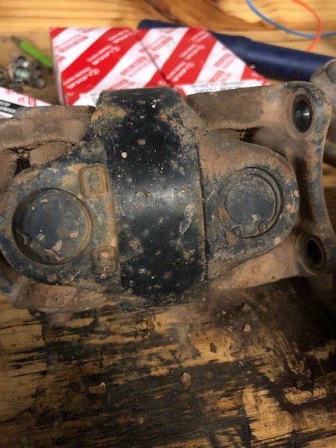

    I guess I’m still a little confused. Which one is considered the Double Cardon and which picture are the 3 OEM spider joints I bought.

    There was a guy on that other thread says some driveline shops will rebuild these...
    they know what parts and how to get them.....evidently that 'BALL' is the hardest piece to get......evidently only couple sources....
    in the world......and there's only two sizes....and two kinds.....inner or outer clips.....
    Others said to dump oem(shame on u toyota).....and get the new after market ones that are FULLY serviceable......and w/zerts......
    drop in place....plug and play.....

    No doubt. This probably saved me a headache and I’m going to leave it as is for now. But yeah, thanks for all the help from the community and to @Timmah! for a great how to video.
