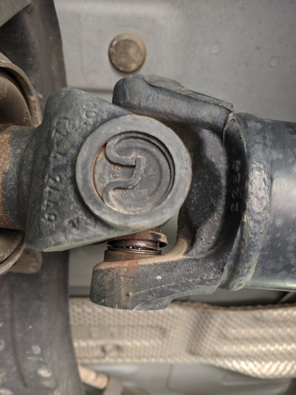

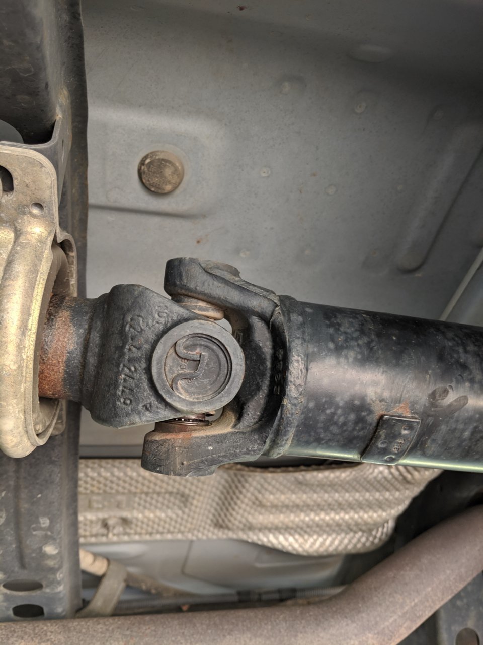

    Old thread but seems like the best place to post this.
    I just noticed a horrible vibration from off the line to about 25mph. It got worse and I'm hearing a grinding noise as well. Went under the truck and immediately noticed a u-joint is in bad shape. Should I drive it at all considering these pics?
  12. Oct 20, 2019 at 7:31 PM
    #32
    Jimmyh
    Jimmyh Well-Known Member
    May 16, 2012
    #78991
    14,323
    SC
    2012 Prerunner SR5
    I would park it as it can get very ugly very fast going down the road. Not only is that dangerous for you it could also effect innocent bystanders.
    When you are going at typical road speed that drive shaft is spinning pretty fast. If the front joint at the carrier bearing lets go the drive shaft could become a pole vaulting stick.

    That's exactly what I was thinking but I figured I'd post up the pics and see what you guys have to say. I haven't driven it since then but I got some Dana spicers with zerks and a new carrier bearing today. I'm just going to replace everything while I have the driveline out so it's good as new.
