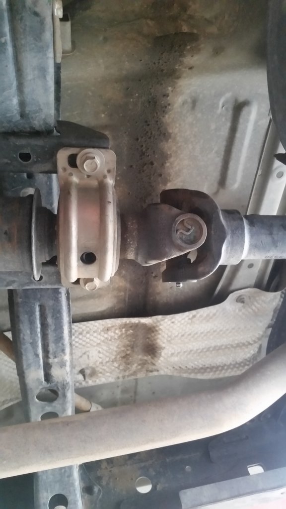

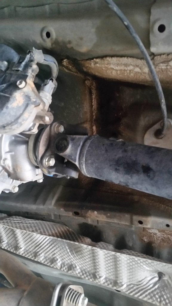

    I crawled underneath yesterday and I noticed grease lines on the undercarriage so I thought that the u-joints were the culprit of the vibrations. However, some folks on here have suggested that it all looks normal from the photos. I checked for play with the vehicle off and parked and there was none either by twisting or pulling front to rear. In neutral, there was play about a 1/4" by twisting but it was where the driveshaft connected to the rear diff and the connecting up front in the transfer case.
    And here is a short video of the amount of play in the carrier bearing as some suggested to check that.
    https://youtu.be/_Lw-XmXNSAE
    I will lube the carrier bearing next time. This time I regreased all the u-joints since it had been probably 8-10k miles since it was done last and wanted to see if that would help first. Anyone with any other guesses what could be the culprit?

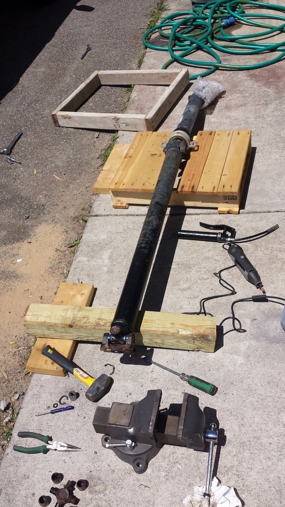

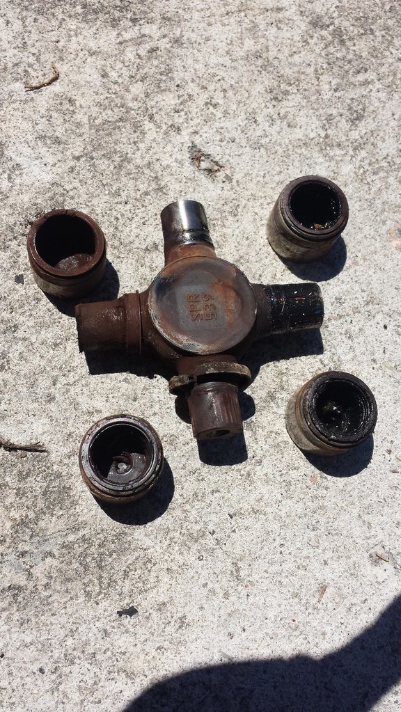

    Got the Moog 270's off Rockauto. Getting the old ones off and getting the front one was easy. The middle and rear turned out to be much harder. The rear one got in but it took a long time because one side did not want to press in easily to get the snap rings in. I actually saw that one of the bearing cups dug into the yoke while pressing it in pushing shavings of metal out of it. I felt like I was using way too much force to get it in. I had a 5 or 10 lb hammer and hitting the handle of an industrial vice to get it to press in. That was the only way that U-joint seated and I actually spotted that the bearing cup had a small crack in it. When i got both snap rings in finally, I spent more time on getting two of these Moog's in than I spent removing the 3 old u-joints and replacing carrier support bearing. The middle one was the worst, this is where a second person comes in handy to hold the driveshaft while you line up the sockets in the vice. I did it alone and it is possible but just a PITA. Here I ran into the same problem as the last one except two bearing cups on each side didn't want to press in fully. I got this idea that if I got a washer that was as wide as the bearing cup and thick enough so that I could seat a snap ring then I could press one bearing cup in enough with the washer so that it was flush with yoke, then press from other side and the other side would seat. This was where I was wrong. The first side wasn't too bad so I let it slide, but the second side looked completely destroyed. The socket and vice ended up being the winner against the U-joint. Can't believe how hard this was to press in. Moog really dropped the ball on this and to add insult to misery I hate the tiny little zerk fittings they include with these. You cant even swap them out with regular zerk fittings because the hole is too small. I bought the needle adapter but when I tried to push grease in it wouldn't go in. I pushed and saw the needle go right in the zerk and what sucks is that the needle is so small it bends with barely any force. So I cut it short and still no success. Basically wasted 4 hours and $50 on replacing u-joints that don't work. I like the zerk fitting on the end of bearing cup but didnt realize I needed a needle adapter and that it wont take grease even with it. DON'T WASTE YOUR TIME OR MONEY ON THE MOOG 270 DESIGN U-JOINTS FOR OUR TRUCKS. Then as icing on the cake, which was actually my fault, I didn't align the rear flange properly before pressing in the ujoint. Now I have vibrations where before I had none! Total fail day on first ujoint replacement. Wondering if the vibration is related to new carrier support bearing or misaligned rear yoke or both. The carrier support bearing I went with was made by Anchor and it looked like good quality. Wondering how crucial it is to align bolts on CSB to exactly as they were from old CSB?
    Pics of the damage:
