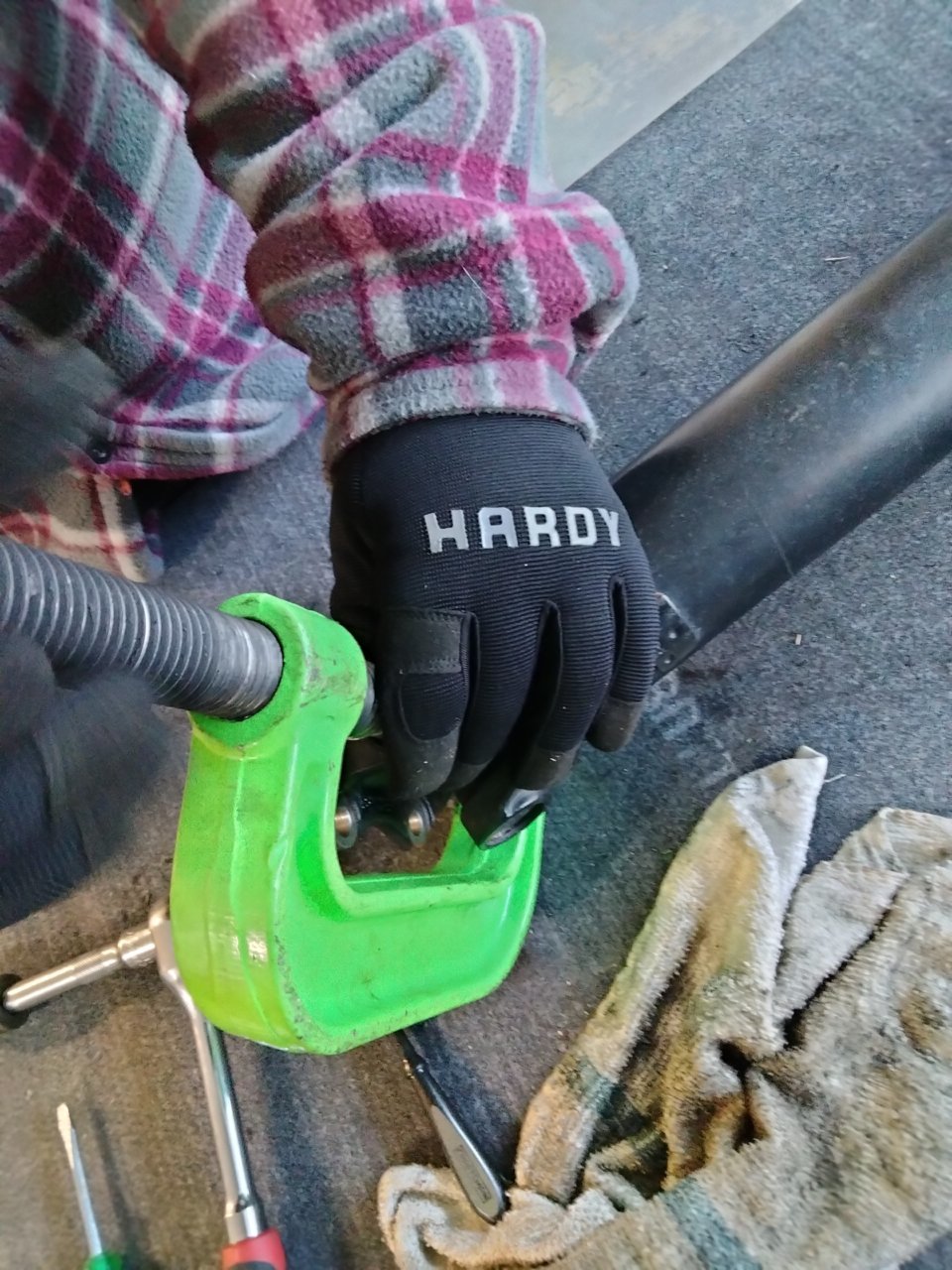

    +1 on the C clamp style ball joint press. Bought the harbor fright set a few months back and it worked great. I grew up doing them with sockets and hammer, vise, then a shop press, many ways to do it. haven't tried the tiger tool but it looks interesting.
