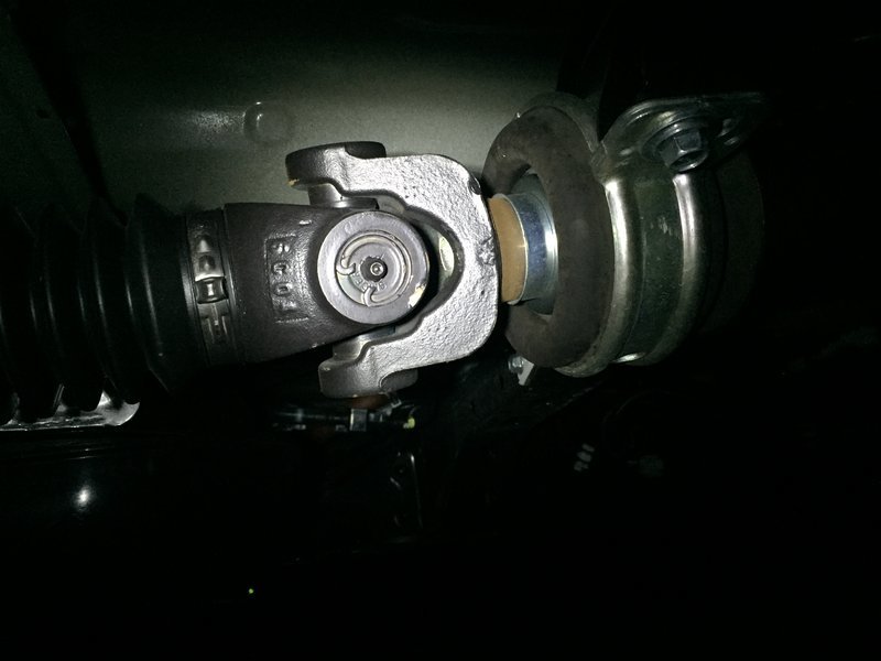

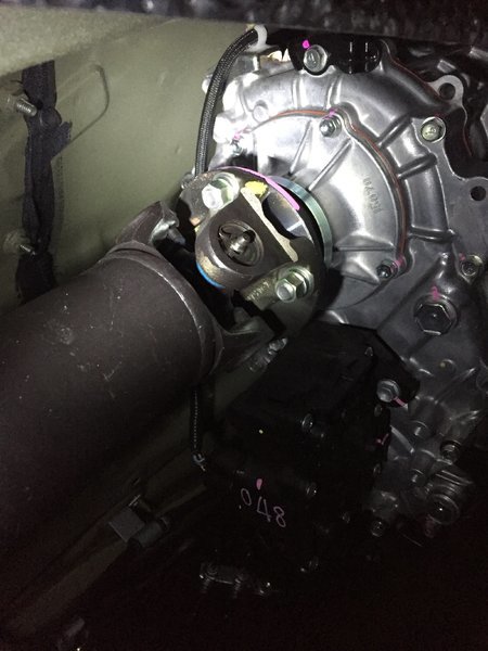

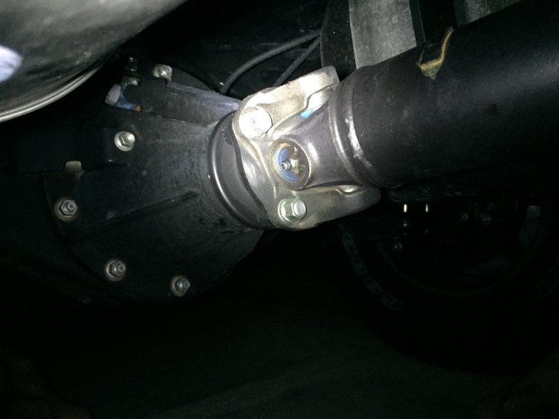

    ok so i have a build date 6/16
    i'm 27 and u till now have neaver heard of the word/term zerk at all.
    i'm literally under my truck now and can only find one near the rear towards the tranny, 1 in the middle of drive shaft near the carrier bearing and 1 in the rear near the rear diff.
    is that right that there's only 3 total at each conetcton point of the drive shaft?
