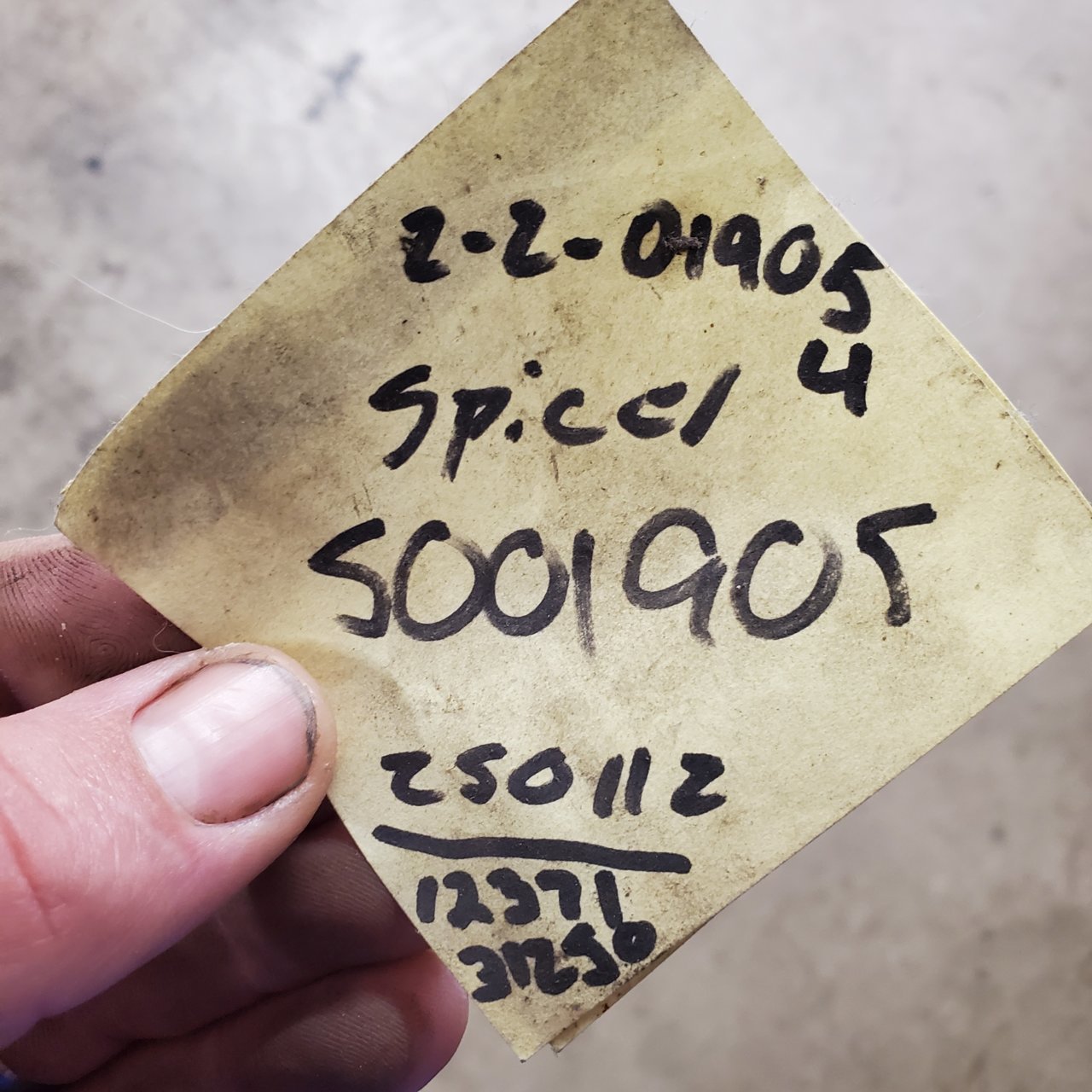

    Didn't say you couldn't get 1330 parts, just that 1310 seems to be more universal. Also yotamasters is out of stock, the second link didn't work, and when I called justdifferentials the other day to see if I could get expedited shipping they told me the parts was actually on backorder.
    As far as I can tell, you cannot get an actual OEM Spicer flange yoke. The only way is to get one from a Toyota dealer. Nitrogears makes a replacement and Powertrain Industries makes one, but the only way you will be able to order is if a drivetrain shop or retailer actually has one sitting on their shelf.
