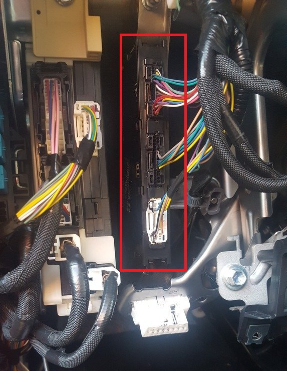

    Does anyone know where the "accessory gateway" is? Is it a module or connector?

    It's part of the CAN network...

    I bought this vehicle with a good title but it was torn apart, literally on the inside and needs quite a bit of body work. When I picked it up, every module was ripped from the vehicle and it only had seats, carpet and wiring. Even the headliner was ripped out. - aftermarket Katzkin - aftermarket rear heated seats - upgraded sound system - Dynamat throughout.
    That's why I'm posting here. When I open it ad search for accessory gateway, nothing is returned.
    I don't want to just blindly start pulling connectors and testing their fit.
    It sounds like this is a specific connector or module in the truck. I just can't find anywhere that shows it's physical location.

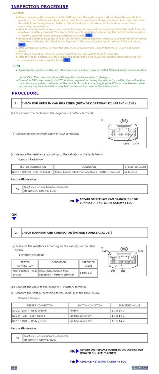

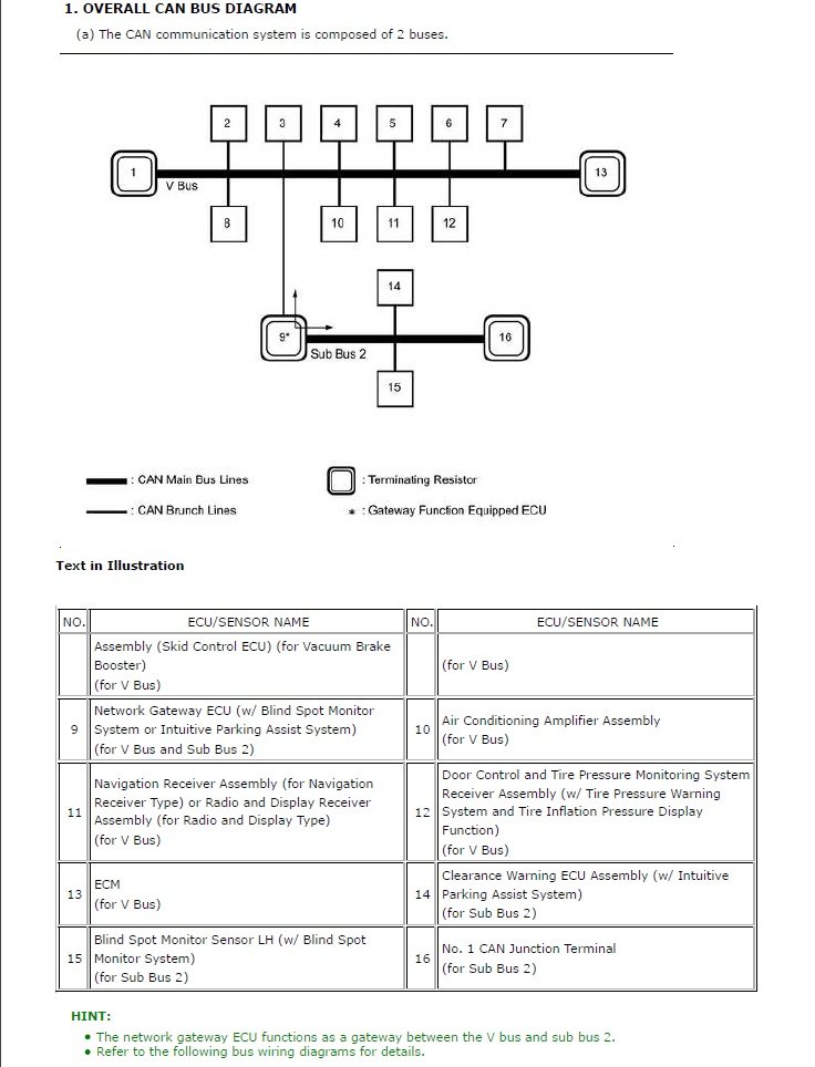

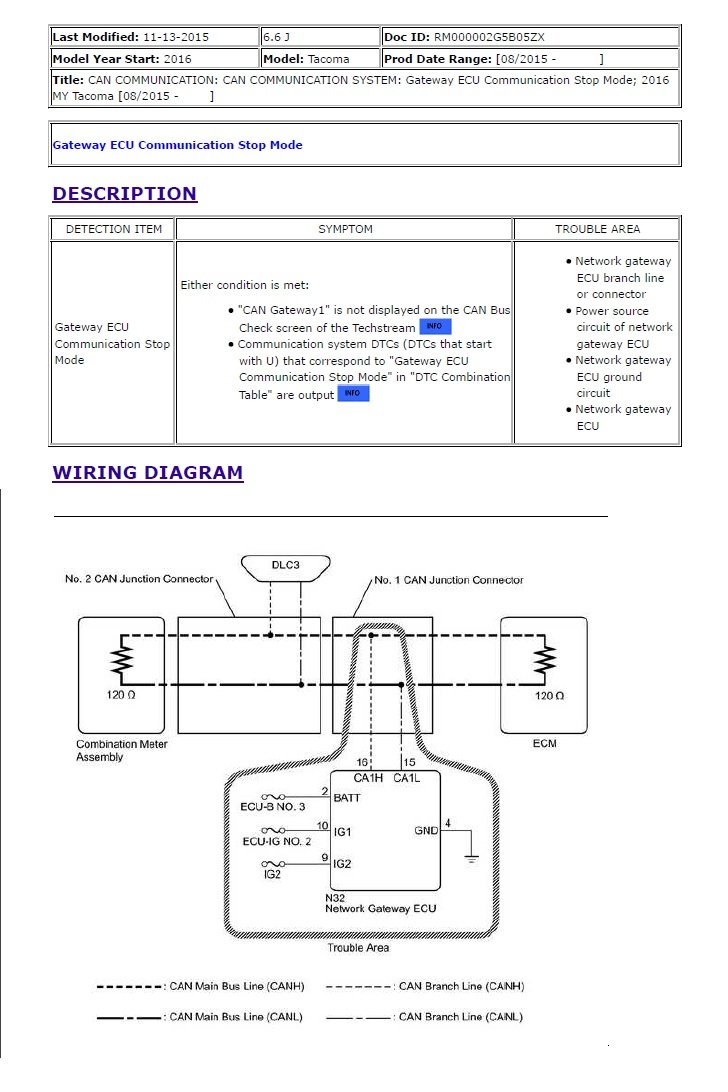

    Here's the main one...
    Could be in a Sub Bus or V Bus...

    The current DCT's I have are :
    U1117 - Lost communication with accessory gateway in the Main Body system.
    Under gateway system, I have two.
    U0233 - Lost communication with Blind Spot Master Module
    This is fine, I am missing both the master and slave blind spot modules. The bumper was trashed and I am looking for a new one from the wrecker.
    U1002 - Lost communication with gateway module.

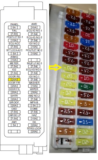

    Verify fuse to rear passenger window.

    Oh awesome! Thanks I'll go check. I feel stupid for not looking at that.
    I just got my low profile fuses from Amazon today. I'll go look thank you
    Edit : I'm assuming that's for both rear windows? Nope, fuse was good. Replaced it anyways but no difference. The driver's side rear works on its own switch, but not the driver's.

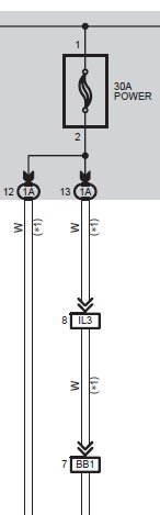

    Sorry, I showed you the wrong fuse for the passenger's side rear power window. The correct fuse is a a 30A (pink) that handles power to both the Passenger's window and the rear window on passenger's side.
    The one on the left in the picture. It's located above the cab fuse panel...on the side.
    But since the Passenger's window works, then the wire providing juice might of failed. It goes from the cab fuse panel (side) to connector IL3, which is behind the passenger's kick panel, then to connector BB1, which is behind the panel that divides front door to rear door. From there to the door switch.
