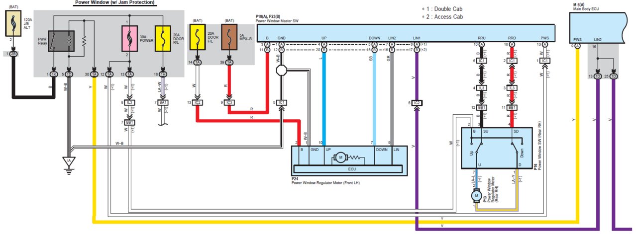

    I checked out the wiring in the doors. The harness is all connected to the back right door. I have sound out of the speaker and everything looks perfect but still no window.
    I got caught fixing a surface laptop for my wife so I didn't get a chance to break out the multimeter yet.
  2. Sep 22, 2020 at 7:56 PM
    #22
    Baadtaco
    Baadtaco [OP] Well-Known Member
    Sep 20, 2020
    #341405
    51
    Jamie
    2016 Silver Tacoma TRD Sport DBL Long Box
    I bought this vehicle with a good title but it was torn apart, literally on the inside and needs quite a bit of body work. When I picked it up, every module was ripped from the vehicle and it only had seats, carpet and wiring. Even the headliner was ripped out. - aftermarket Katzkin - aftermarket rear heated seats - upgraded sound system - Dynamat throughout.

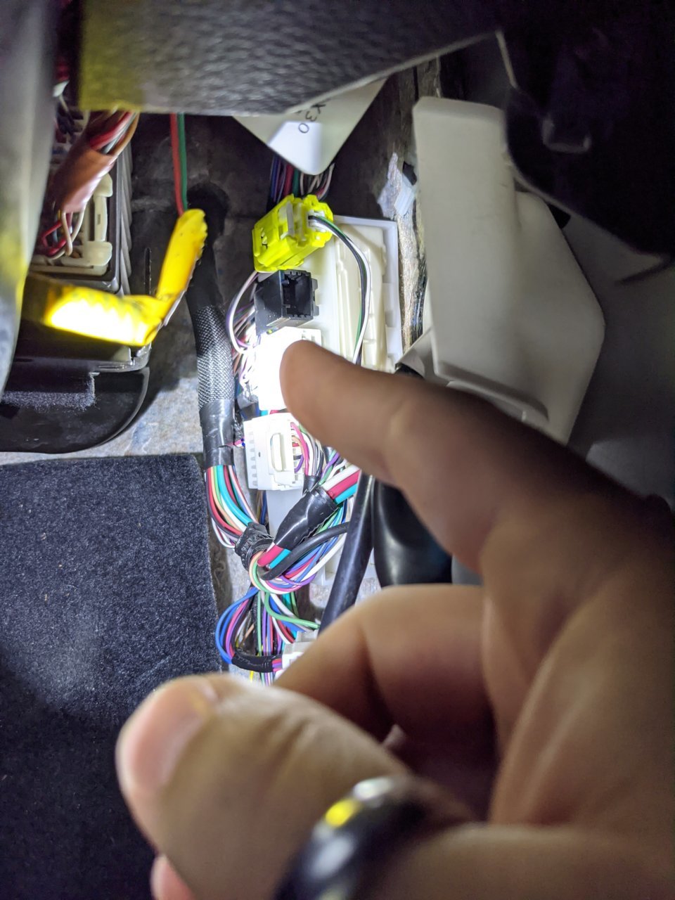

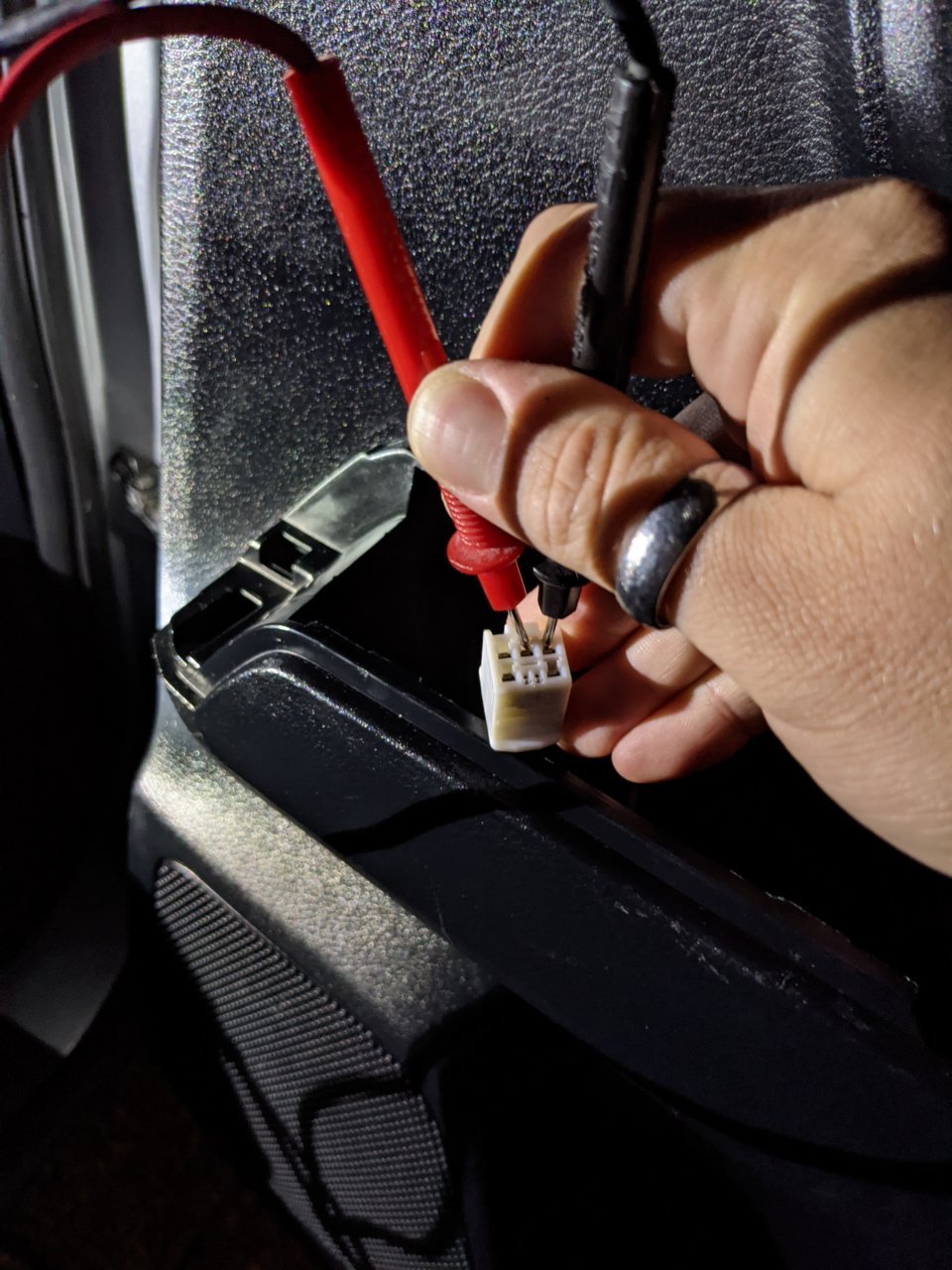

    So, I didn't get a chance to check out the passenger kick panel earlier. I just went out now in the dark and didn't see anything in depth.
    I did notice a black plug with nothing connected. As it isn't dusty or anything, I'm thinking something used to be plugged in here. Not sure where the wire would be though. Wonder if this is part of the issue?
    I tested voltage at the door, I think I have the right pins? No voltage. Checked those same pins on the rear driver's side and I got 13v.
    So the passenger rear door doesn't seem to be getting power. It is getting sound though so the main harness in the B pillar I believe is not the issue.
    I'm thinking it has to do with the power somewhere at the passenger foot well.

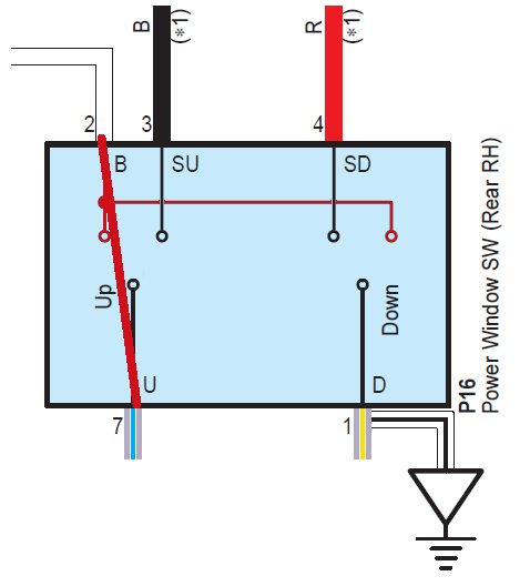

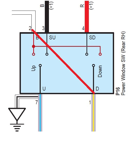

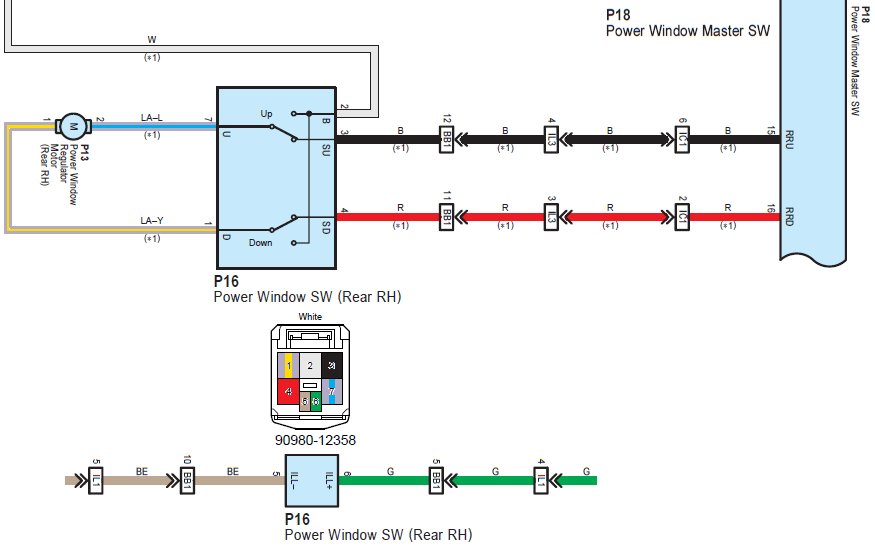

    I don't know what you are testing there, but :
    #2 is the fused 20A power
    The Rear Door Switch sends fused power to the window motor via pins #7 (UP) & #1 (DOWN) but the completed choice is sent to ground by the Power Window Master Switch on Driver's door.

    So I was testing pin #2 (fused power) with pin #3 (ground).
    On the driver's side rear door this showed voltage. On the passenger rear door I don't see any voltage.
    I am going to test IL3 pins 3 and 4 and see if I get voltage.
    I can't help but think I have a bad ground issue.
    Edit: I went and tested it.
    3 and 4 on IL3 is giving SOME voltage but it is VERY small.
    I had to set my multimeter to 2000m to see that it was detective 10.
    I am assuming this means basically NO voltage.
    I was able to test continuity now though between IL3 and the plug in the door and that seems to all be good. So I THINK that this means there would be an issue either at the master Door switch or somewhere between IL3 and the fuse?

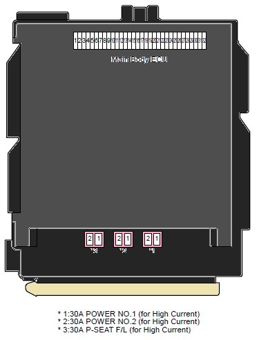

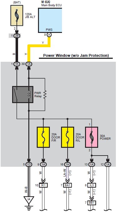

    I saw your post of where the 30amp fuse was but I couldn't find it in my truck.
    Can I bug you to explain it's location again? Sorry man. I just wasn't following where that 30amp fuse is.
    I am assuming it is moot, as it is the same fuse for the passenger front as it is for the passenger rear, but I figured I should check it out anyways.

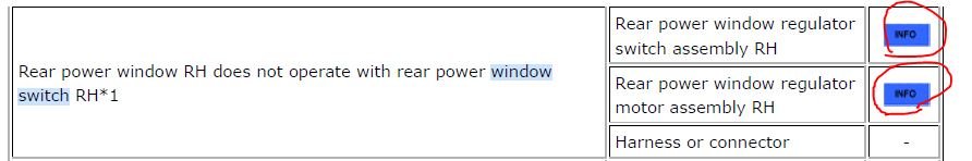

    When going through the service guide (i have it in a PDF) what I find most confusing is that where it says "See Page" in the troubleshooting, it always just says "INFO".
    Is there something I am doing wrong with this? How do I see what page it is on. All I see is "info" in a blue box.

    The bottom yellow is the fuse cover...the High Current fuse is above on the outside. The are facing the passenger side.

    Ok, I found them, and figured out why I couldn't find them before. They were covered in black electrical tape. So someone was definitely f'ing with these before!
    I love trying to uncover mysteries. I am going to swap them on the off chance there is maybe just a bad connection. Long shot I know, but I am out of ideas at this point.
    If I understand the diagrams and what you have mentioned, the power goes
    Battery -> Fuse Block in the cab -> 30 amp fuse (shared with Passenger Front Door) -> Passengers Front Kick Panel -> Along the floor in the large loom harness to the B pillar -> Into the door -> Door internal white connector -> Door switch.
    I am not sure how much voltage I should have, but I am assuming 11v-14v DC. I have SOME voltage but it is trivial.
    I couldn't see in the drivers kick panel if there was a second fuse or not for the rear door but looking at the schematics it doesn't look like there is.

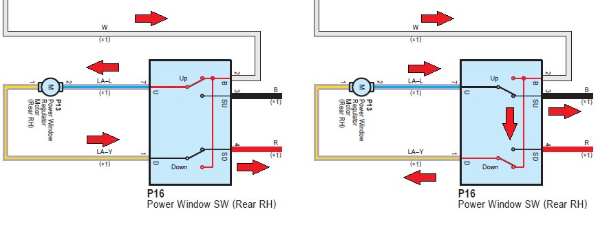

    Since you have fused juice, then make a jumper. On the window switch connector, jump 2 with 1 and another jumper from connector pin 7 to ground.
    If motor is fine window will go down.
    You'll be by-passing the Main Window switch and the door window switch.
    Remember it's 20A, don't use thin wires and do not cram the wire INTO the terminal in the connector. Identify the pins and use the rear of the terminals on the connector.
    UP:
