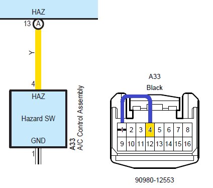

    Have you tried by-passing the switch?

    Yeah, I have to take that whole assembly apart. Haven't done that, yet, no.
    I could maybe unplug the harness and jumper it, but not sure how comfortable I am with that. Wouldn't you any to accidently jumper the wrong pin. A lot of stuff goes through that connection.

    Remove it enough to place a jumper to ground on the connector A33 pin 4. Test that it's not the integrated signal/hazard module inside the C0mbination Meter.
