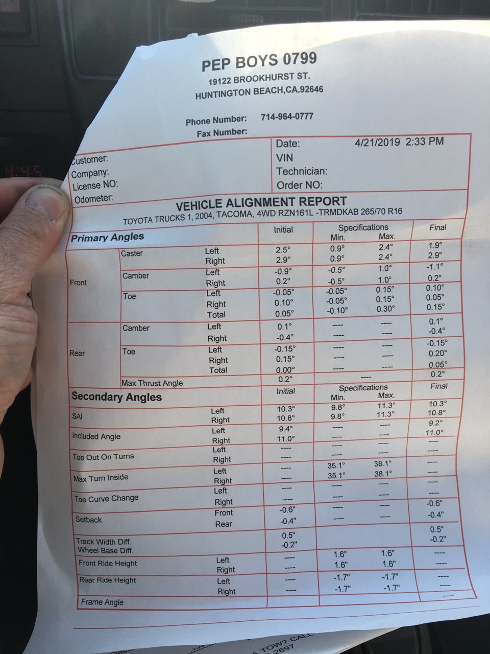

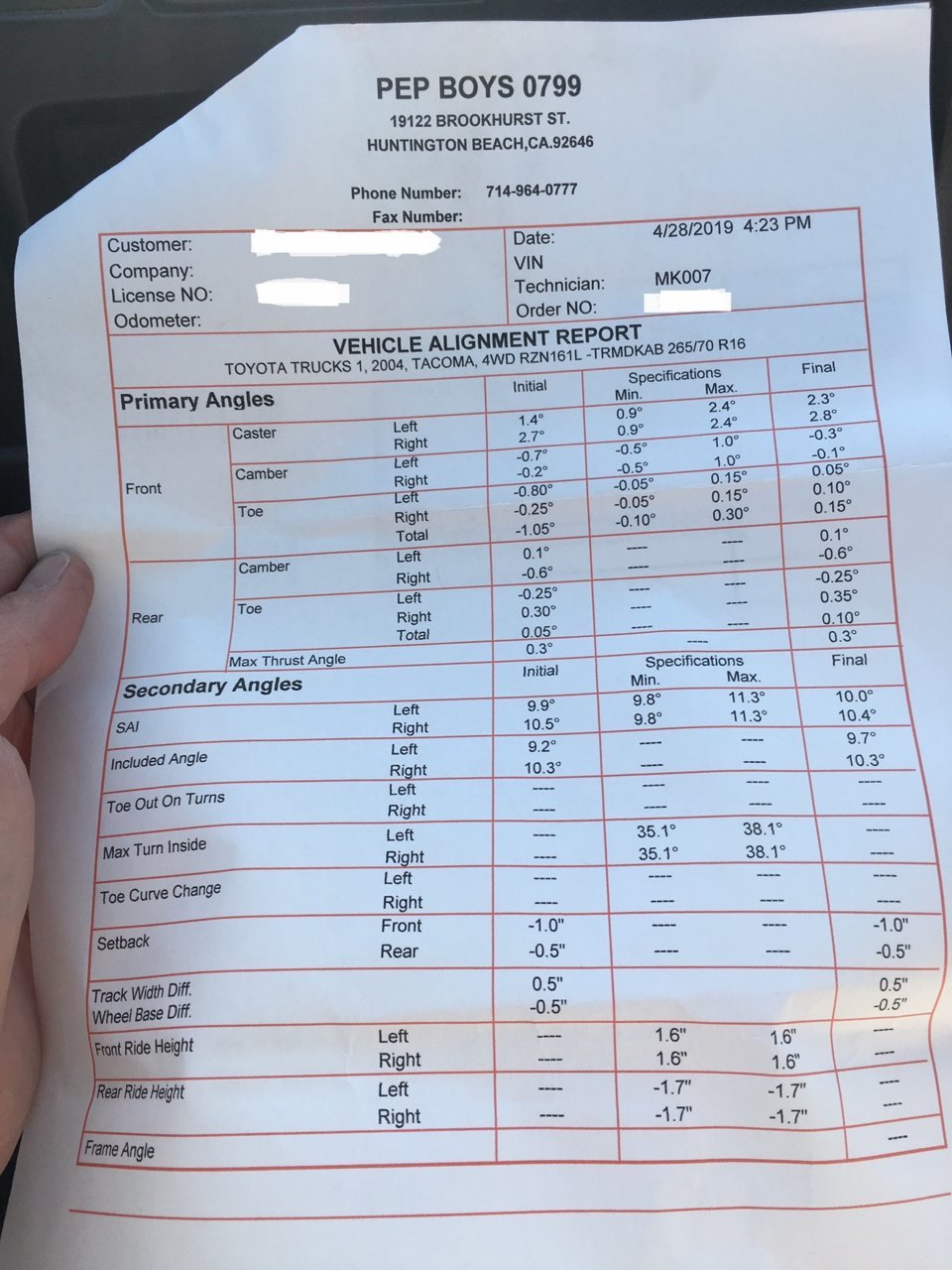

    Alignment data. Newest to oldest if it matters. Note that each states 4WD so they were keying in on the manual lock hubs as my VIN would not indicate this.
    After inner and outer tie rod ends installed. April 24, 2019
    After Steering rack bushing installed. April 21, 2019
    After manual locking hubs installed. Dec 2018
    @Luv my yota No idea what type of machine Pep Boys uses but it should be four wheel as they report front and rear.

    That is all for tonight. I am very curious right now what you all think of my alignment and the fact that i am scuffing my wheels. That to me is key but i am not sure it is all that is wrong.

    You’re right caster angle was close at first but still out by .1, but got subsequently worse as you went back with numbers out at 2.9. I could get it in spec but you aren’t here, it wouldn’t account for the pulling in both directions if at all. How new are the front shocks? They could be getting saggy springs. I’m still betting it’s the master cyl.

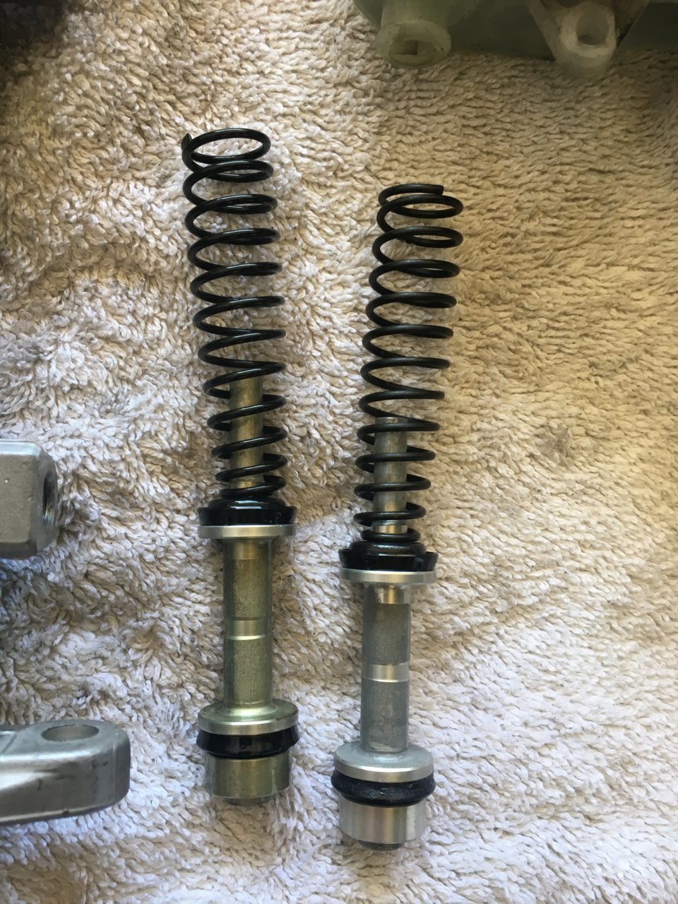

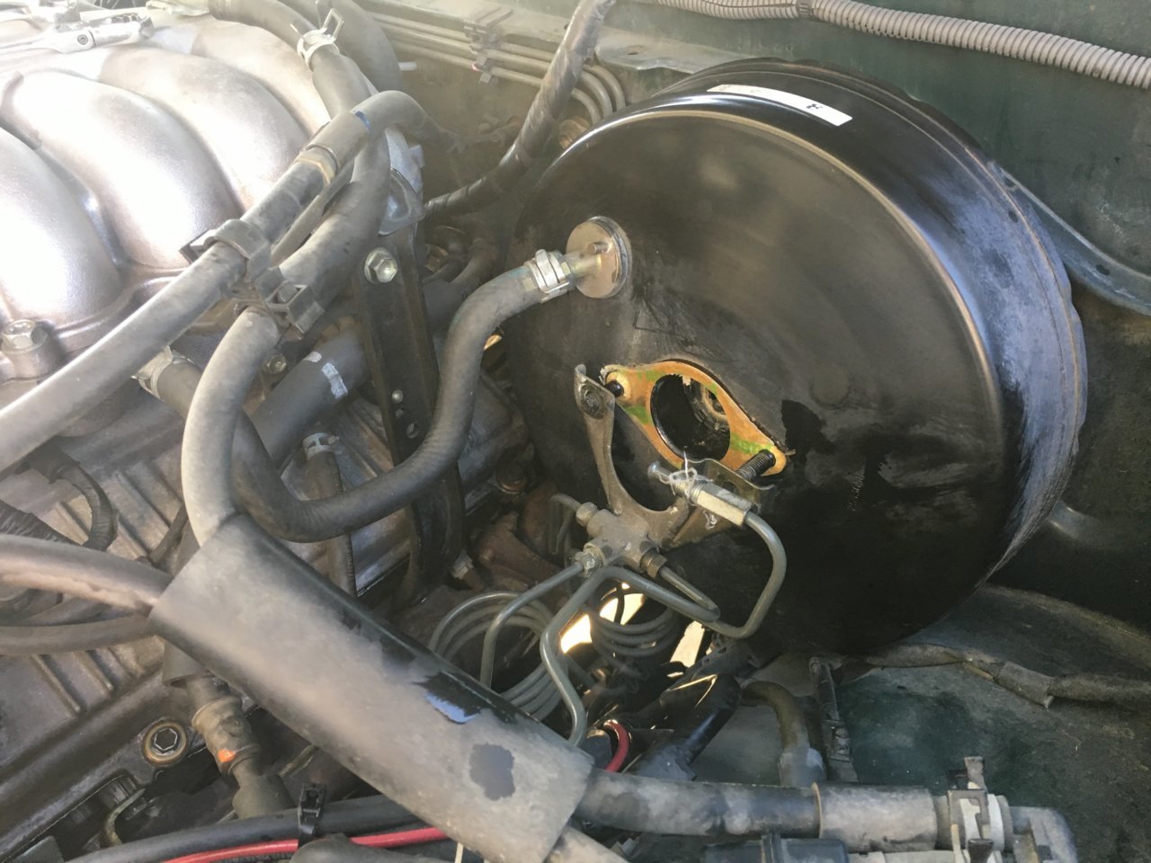

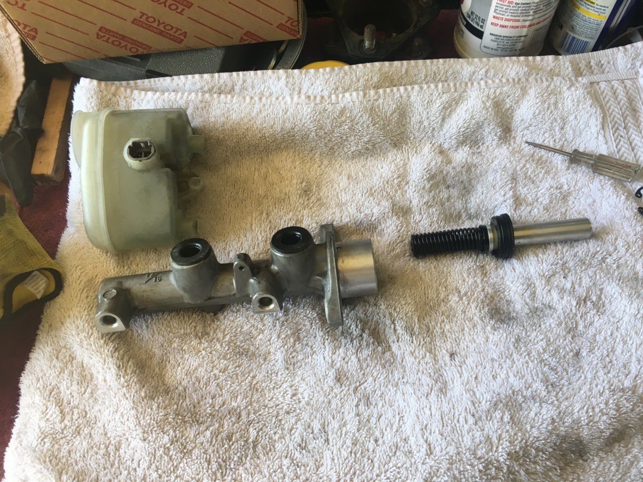

    Good new/bad news.
    Master cylinder rebuild today went fine. Pretty straight forward job. Kit i used was 04493-04030. About $55.
    Could not really see anything obviously worn other than black in the reservoir which could be a sign of rubber seal wear.
    Once done I blead the brakes two times pumping almost an entire large bottle of Dot 3 through the system. When done the pull to the right is gone. Under hard braking the truck stays pretty straight.
    The bad news is the truck will drift left and the steering wheel goes left about 1/16 to 1/8 a rotation. A drift more than a jerk. I am betting that is alignment and Pep Boys will get to do another alignment tomorrow. :)
    @Luv my yota , @mechanicjon a few questions.
    1. Lots of squishy noises coming from the MC and brake peddle area when we pump up the brakes before bleeding out the pressure. This is after bleeding the system twice. Is that normal?
    2. Should the brake peddle be super solid at first or sort of soft for an inch and then build up solid?
    3. When bleeding one corner (rear drivers) the fluid had a sort of light milky look to it like micro air. After bleeding that corner almost 20 times it still looked the same. Cant tell if it is from inside the brake system or the hose on the nipple was sucking air. Since the rear passenger did not do it it could be air but that much??? any advice?
    4. Never taken the rear brakes apart but i know my pads are worn. How hard is that and can you do it w/o having to bleed the brakes?
    Thank you for the continued help. I hope after an alignment tomorrow i can put this thread to bed.
