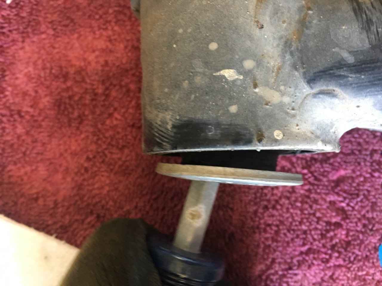

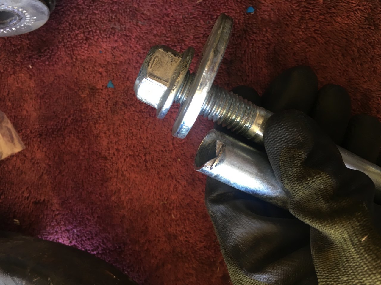

    Home after a long trip and front end is getting worse. My new bushings are not here yet but i am not driving this truck any more so i took it apart today.
    Stuck a screw driver into all four bushings. Passenger side rear was shot. With very little pressure got this. The rest were alot better but i am replacing them all.
    Then started to press them out and...
    I also found the replacement cam assemblies damaged. Looks like someone forgot to align before they banged it into the hole. Geezzz...
    New ones.
    I hope this is the end of this game...
