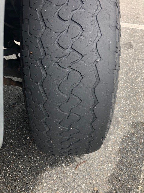

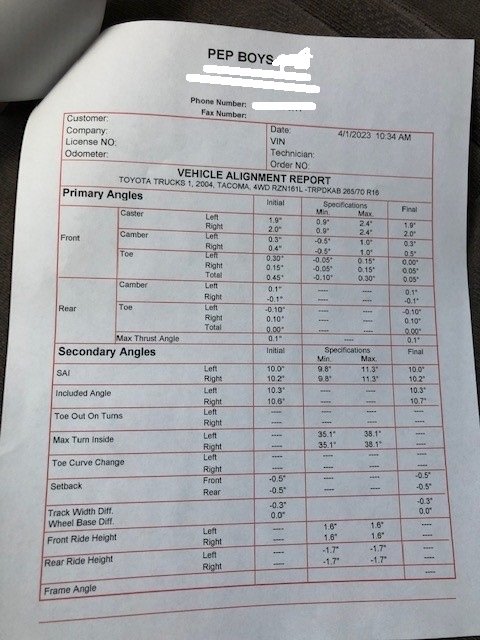

    I put the truck up in the air Saturday and turned the steering end to end to try and detect joint movement or the source of the knock. I visually looked and then placed my hand (safely) over every joint looking/feeling for relative joint motion when you get to the end of travel and load the system up. This is how i found the bad joint last time. I found nothing. I checked UCA ball joints, UCA pivot joint, LCA ball joint, LCA pivot shafts, Tie rods & Wheel bearings.
    To please my wife i put new tires on and had the system re-aligned. Below is a image of the wear and the alignment before/after. Does not seem like the alignment was way off but with JBA UCA's i think the camber needs to be something other than stock. I have lost the install manual from JBA and could not find it online.
    Any advice?

    You definitely needed new tires! Whoa!
    Looks like Toe was off on the drivers side which may explain the outer shoulder being worn more. Regardless, looks like numbers are all back within spec.
    Can't comment on the JBAs since I have no experience with them.
