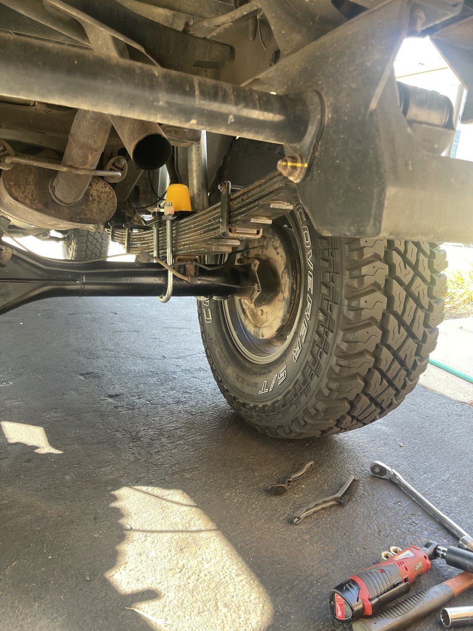

    I have stage 3 with @ARCHIVE flip kit. They are or used to be a dealer for Deaver, so they can definitely help you.
    pic for reference

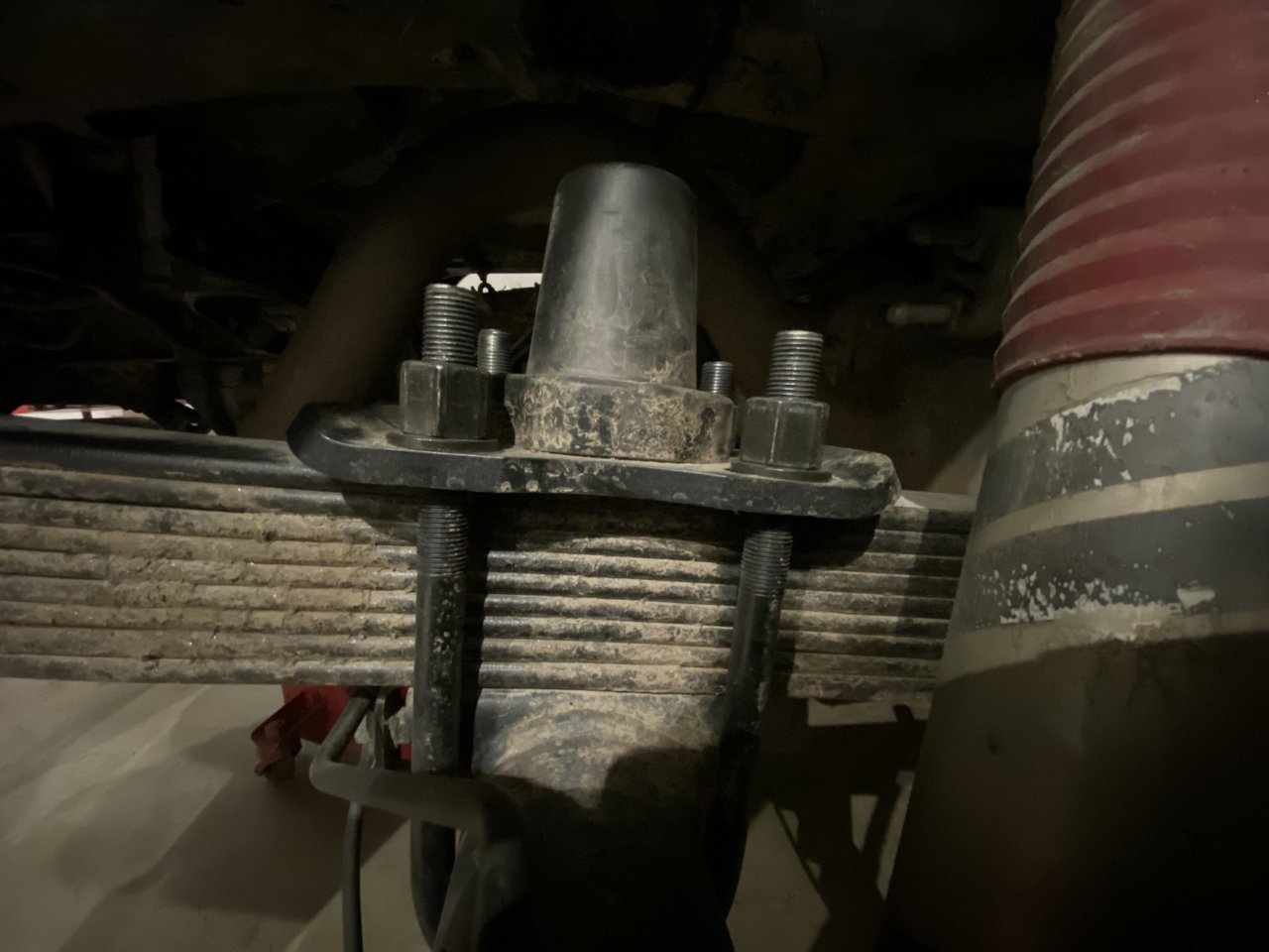

    I got these with Superbumps for my Stage 3 Deavers:

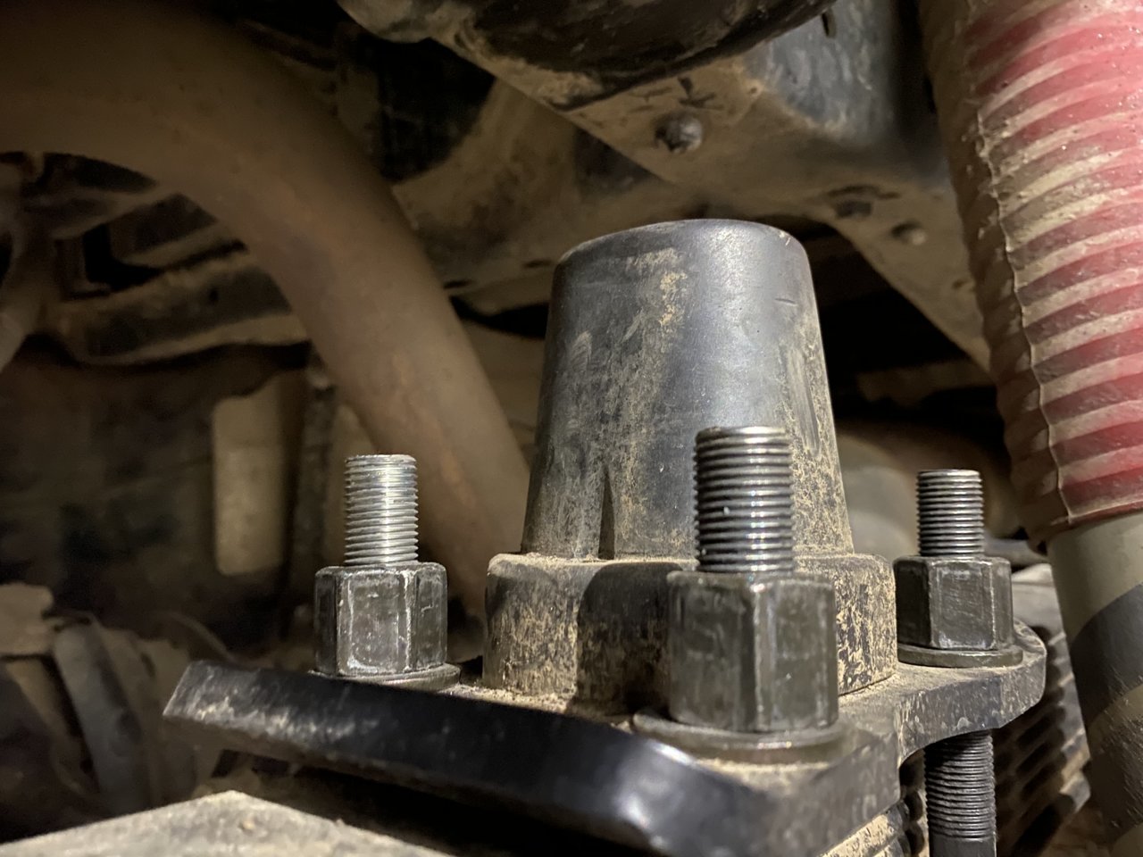

    I got the Durobumps flip kit. Kinda wish I went with Archive but I had already ordered the Durobumps when I found out about Archive. I have everything installed and am wondering if these Ubolts are too long. Is there too much thread showing after the nut and should I cut them shorter? I imagine it’s possible if I bottom out hard enough the bolts could hit the frame? Or is this all fine?
